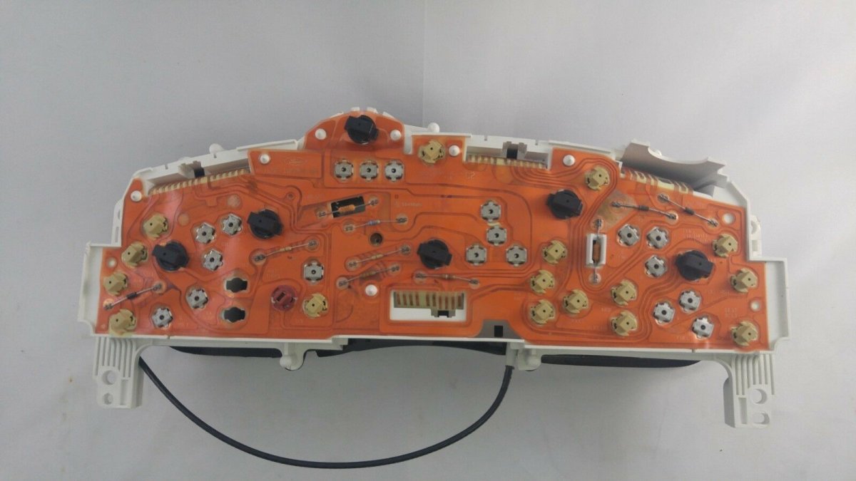

If the 2002 cluster bulbs have never been changed, it's time to do that, as you've likely got other bulbs that are out or ready to go out.

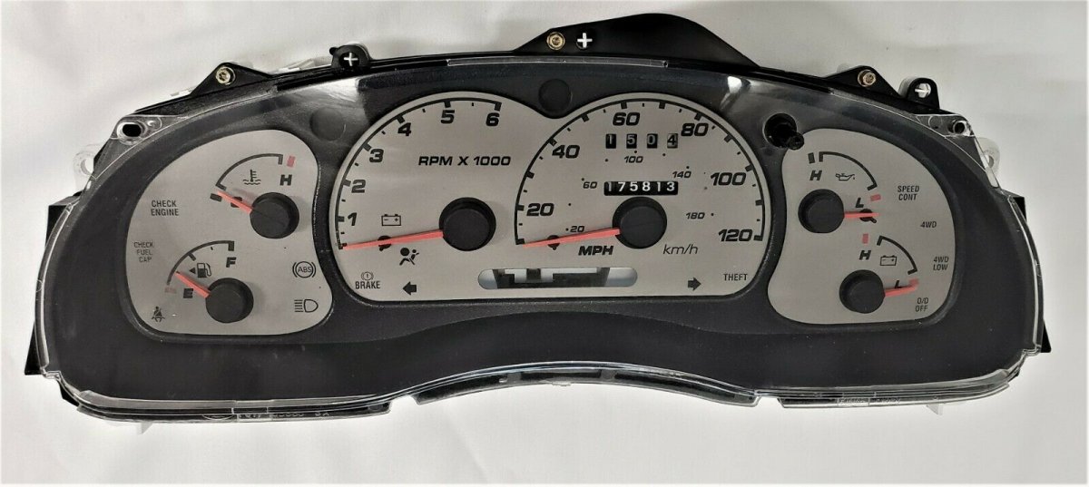

Each time you turn on the key all dash "warning/indicator" bulbs should come on, its a BULB TEST
Does OD OFF come on?
If not bulb is burnt out

Correct me as needed, but I believe
199?~2003 Rangers\Sports\SportTracs have the older NonDigital\NonHEC cluster, at least that is what's in my 2001.
PreStart BulbTest flashes most of the cluster lamps, but not all; it does NOT test the ParkBrake, TurnSigs, 4WHi, 4WLo...
That's why I did not go there in my response above.
