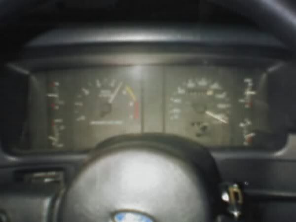

shawn is right, although it sounds like it heats up then the thermostat reacts and it cools back off... as many have said above, temp gauges don't mean much, as long as it's not in the outer edges it's fine... they are never accurate and should be used as a rough guideline only... my mustang's always sat right at the bottom end of normal... i'll see if i can find a pic...
ignore the speedo, it's broken... this pic was taken many years ago... this is my 89 mustang volts top left, oil top right, gas bottom right, temp bottom left... that's where my temp sat all day long in the middle of the summer... and i had replaced the thermostat about 2 months prior to that pic i think...
no, it's your truck's themp gauge reading incorectly, OR, it could just be your spesific motor's personality... 98* is only an average for people... some people are warmer some are cooler...
the important thing is that it stays in the normal area... no big deal... did your truck always do this, or is this new?
