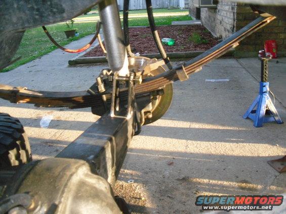

Reworked the front suspension on this jeep and did some tweaking to the hydro assist

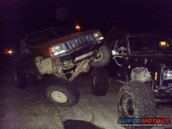

Installing Hydro assist on the Fo-Runna
Also installed the PSC high output pump and resevoir. I was very UNIMPRESSED with the install on the pump, the pully is about 1/8" too small to pass the bolts through. So you have to put the pump on first, then with about 4" of room in front of the pump, press the pully on. Other than that everything worked out ok other than them forgetting to send the heim joints in the original order.
