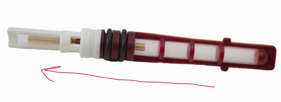

First, there is some conflict over what direction the orifice tube is supposed to install.
Dad pulled the old tube out when I wasn't looking. I installed the new tube without consulting him. More studying that night lead me to believe that I installed it backwards. He checked the next morning and says it was the same direction as the old one. That would be with the Red end of the tube towards the evaporator core (dash). I highly suspect the system has been opened previously and likely not reassembled correctly.
This morning after further consulting the internet and carious AC threads, I'm almost positive that the Red end is supposed to be towards the condenser (radiator support). Refridgerant trivels from the condenser to the evaporator, so that is where the screen/filter should be to catch debris and such. Also it sounds like there is an arrow on the tube that should be pointed in direction of flow, it's pointed towards the white end.
I consulted the FSM and it isn't clear on that either. Since I have to re-open the system anyway I'll ask the experts, or atleast phone a friend. What direction is the orifice tube supposed to be installed?

The screen end goes toward the high side.
The opposite end has a couple tabs that the removal tool typically locks onto.

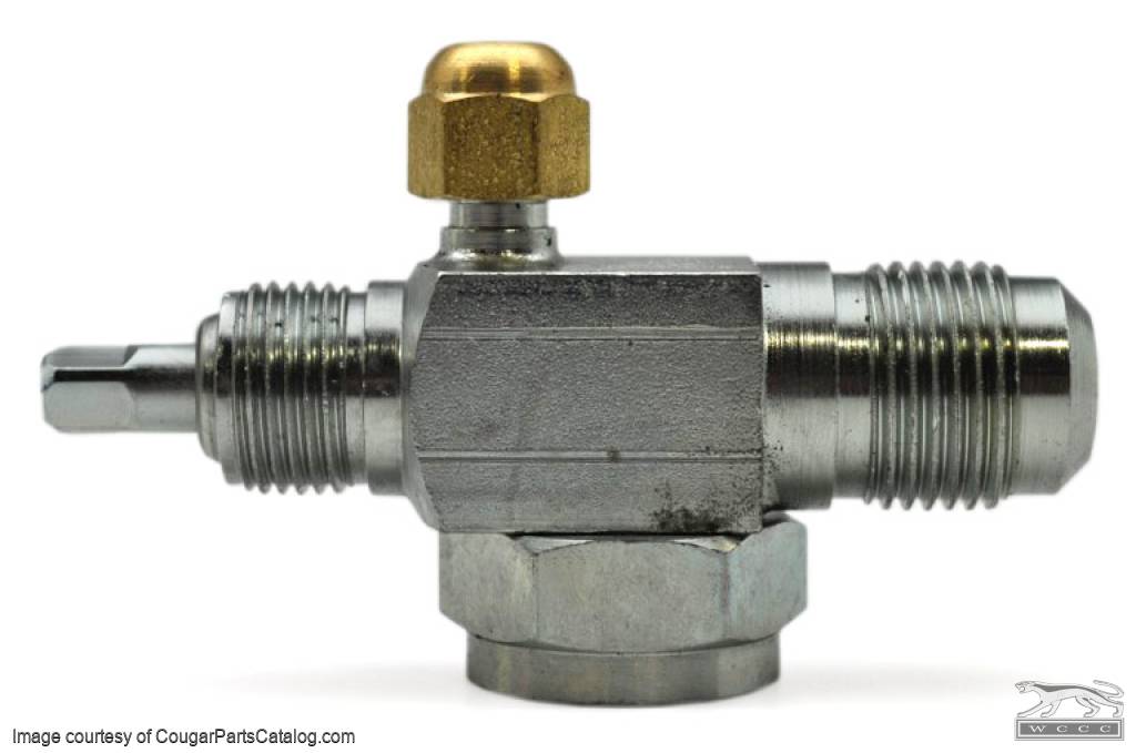

Also... where the lines meet the compressor... there isn't service valves is there? I don't think there should be... but you never know in some cases what's been done. Similar to this...
Those are used to isolate the compressor/lines and have to be mid seated to allow the system to function.
Well, high side would be towards the condenser, but both ends have a screen.
Red end has a large screen, white end has a small screen. I'm going to assume that the tabs you refer to are the little ones sticking out on the red section in the picture above.
We don't have the tool. The few we've done were able to grab and gently remove with needle nose pliers.

No service valves.

Ok.... the red end goes toward the high side. It's been awhile since I've had one of those out. The ones I've seen also have tabs on the white end that engage the tool. Hard to say what parts look like any more.

Like this. You want more surface area to collect residue from the compressor before going through the orifice. I believe the high pressure output from the compressor goes through the condenser and along the passenger frame rail into the orifice.
That is how it is currently installed. I'd initially inserted it the other way on Saturday, but was bothering me all afternoon so I did some digging. Results of that digging were inconclusive but leaned towards the orentation you indicated, so we flipped it around on Sunday.

Even if it is installed in the direction broncc indicated?

I’m not really sure what to tell you on the rest of it. I believe the orifice tube goes white end in and the red side towards the front of the truck if I remember right, but I could be wrong. When I did the AC in my 92 I opened both sides of the manifold to vac down and let it run a couple hours before closing up and shutting down. Let it sit overnight, then when it didn’t change overnight I put as much in as it would take before starting it and running max AC to fill the rest of the way. You would have to check the fill amount, but if I remember right it should take a little over two 12 ounce cans.
I think @broncc is showing arrow as direction of flow.

That is how the tube is currently installed and jives with what @broncc and @Uncle Gump said. Fill amount is 1lb 14 oz per the lable on the radiator support. That's 30 oz or about 2.5 of the little 12 oz cans. More I think about it, more I suspect we did something wrong during the fill process. We verified the system was tight the other night and it hasn't been opened, just need to get it pulled back down and try again.
