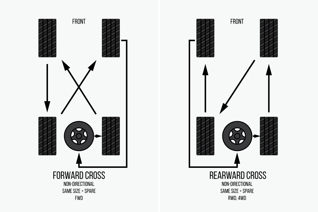

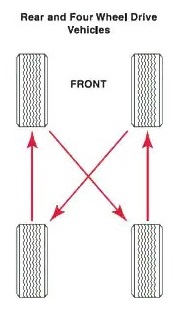

To clarify, I have rotated them as shown below, crossing the front tires to the back and bringing the rears straight forward, every 4,000 miles for 20,000 miles. Every tire thus has the exact same wear pattern. The fronts are always worse when I rotate them... but then again... that's why you rotate tires.

That's exactly the rotation pattern to use.
I use a 5 tire rotation

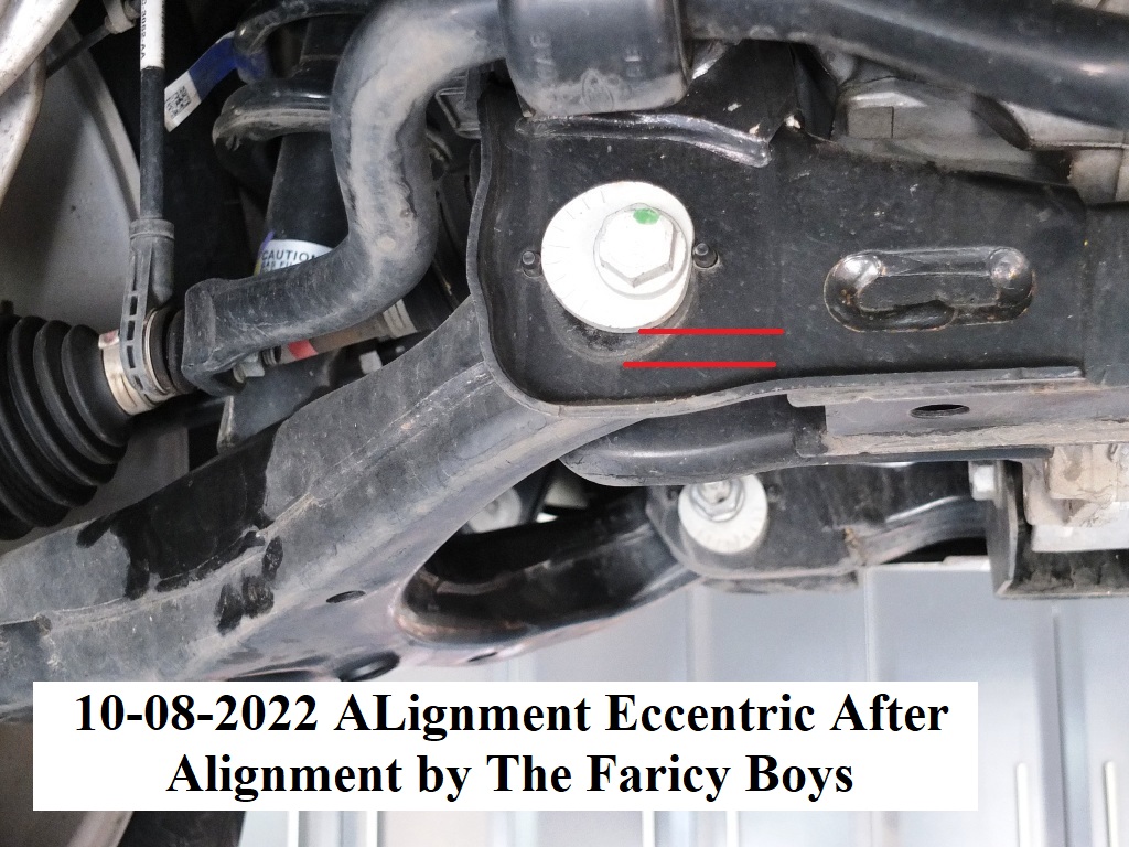

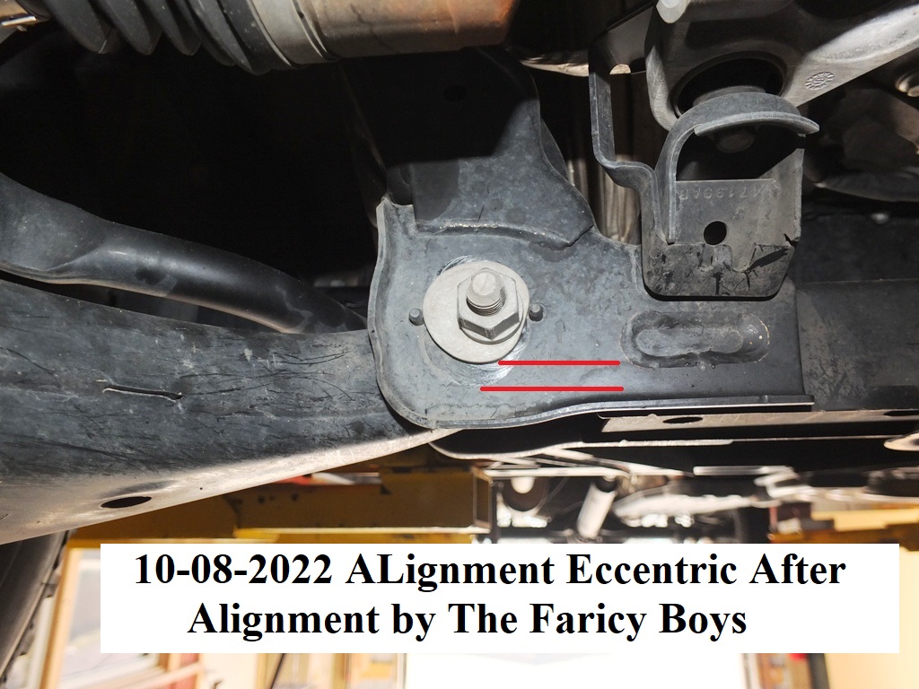

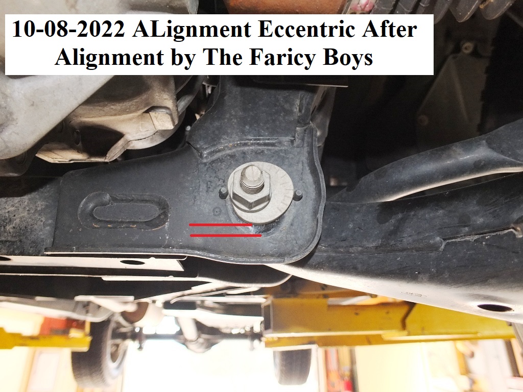

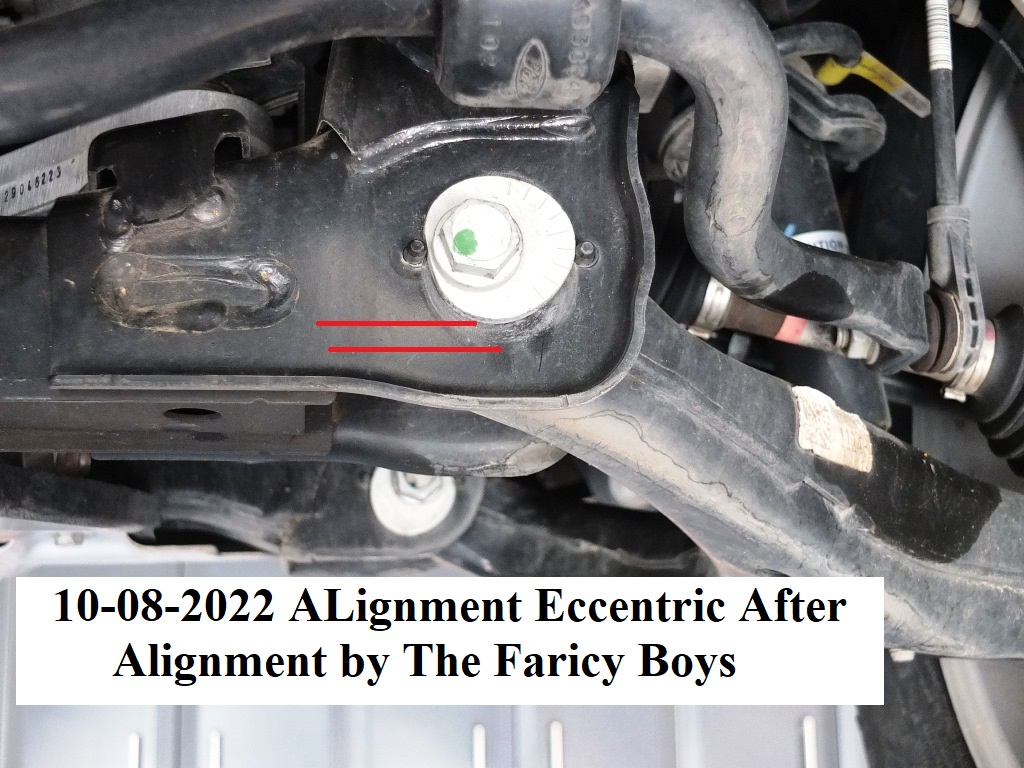

I filed a claim with Ford about how bad out of alignment the truck was from the factory, and how that lead to the premature tire wear. I included the photo's posted below of the eccentrics.
We found out this week that Ford is sending us $658. I suspect that Ford realized they sent some trucks out that had an alignment issue, and they're making it right. I'm impressed.

@HenryMac: It's not the red lines you have highlighted in your pictures, but the fact that you're alignment is within one notch of full in (on the flat of the alignment washer that concerns me. And the back adjusters not lining up with the front - which I know has some to do with caster adjustment.

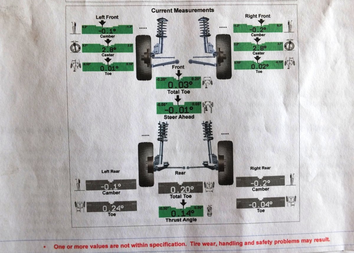

I'm curious on what the spec were post alignment.
Looking at the clean marks on the chassis mounts, those were WAY OFF! Seems to me they should have offered to replace the tires under warranty as noted above. Certainly a factory defect.
Everything is in the green- meaning within tolerances- but both tires have negative camber which would wear the inside of the tread. The illustration for camber shows how a tire would tilt with positive camber, the opposite of what you have. I consider anything less than set to preferred to be out of alignment. It's not terrible but tires are expensive.
