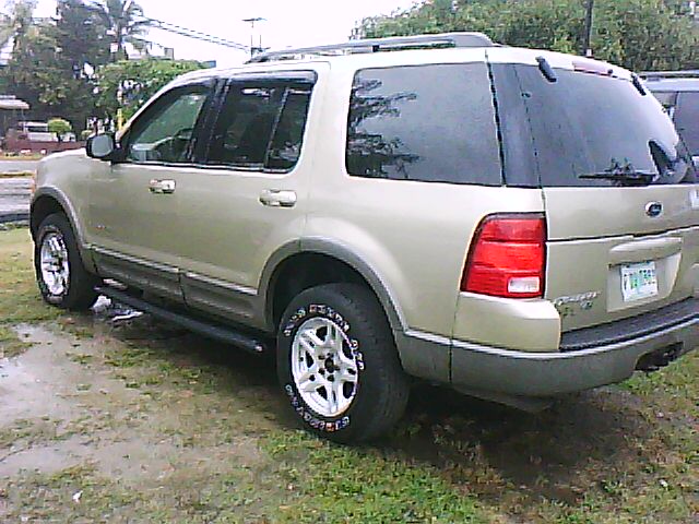

so im asking, what u think about the 02 explorer? its a good suv/truck? its a good Ranger replacement?
im asking because we havent had any explorer before, so idk if they have issues with transmissions or electronic modules.
i would like to read a good number of opinions, since he could make the deal tomorrow on it.
