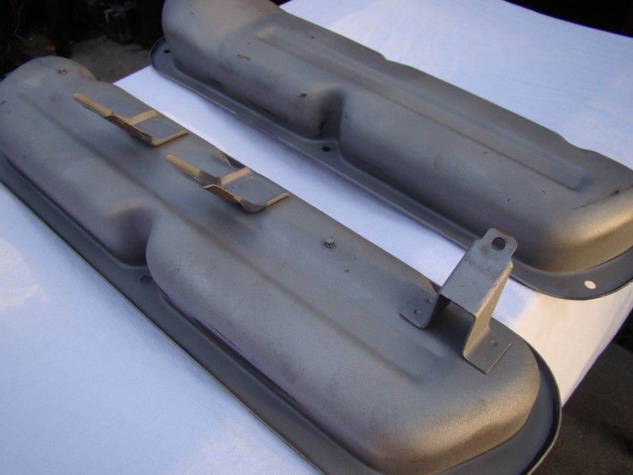

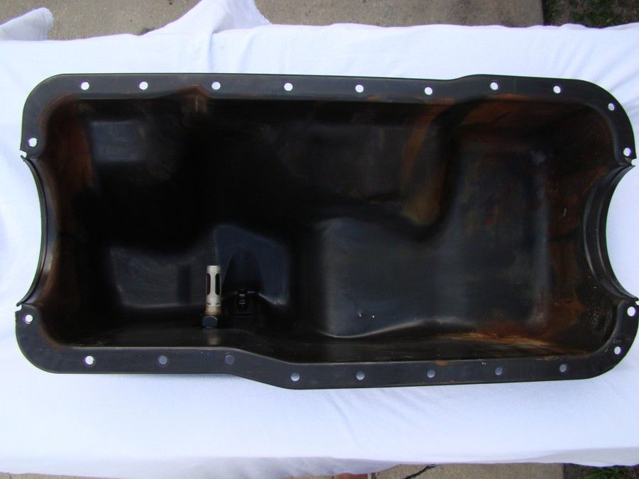

In between a busy work schedule this week I had a little time to media blast the oil pan and valve covers. With a little luck I will get a coat or two of primer and some color on them before the end of the week. I am still waiting for a break in the work schedule to get the block in for machining. I am just having trouble setting time aside during business hours to drop it off. My son will not be back from basic training until mid December or mid January. That is when we are planning to assemble the motor so I guess there is no real hurry on the machine work.

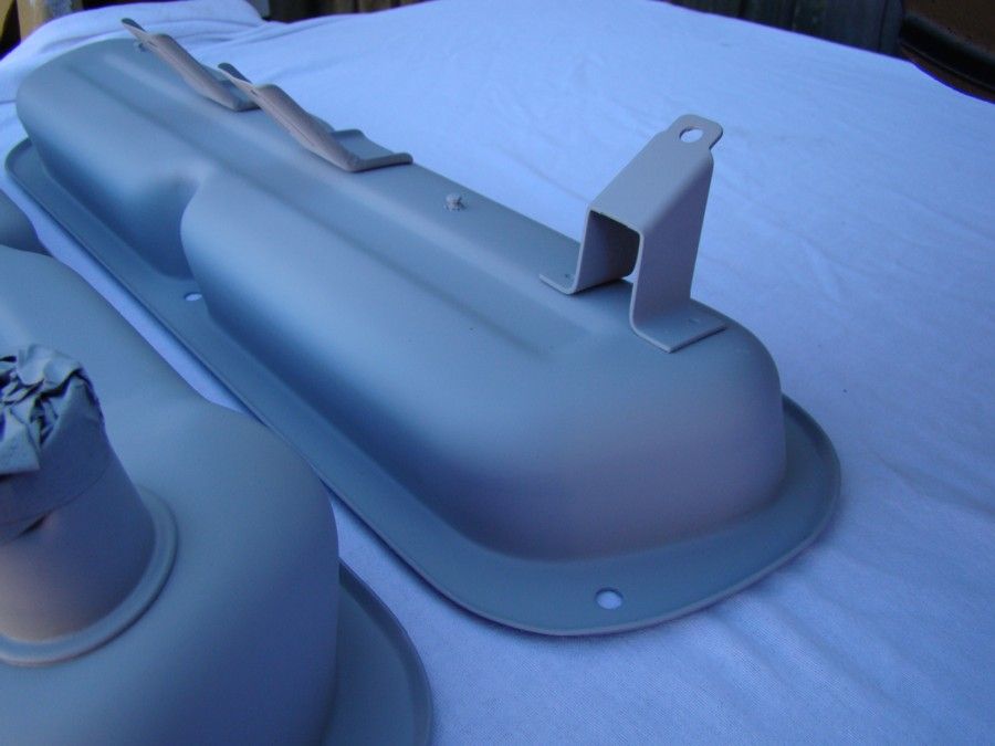

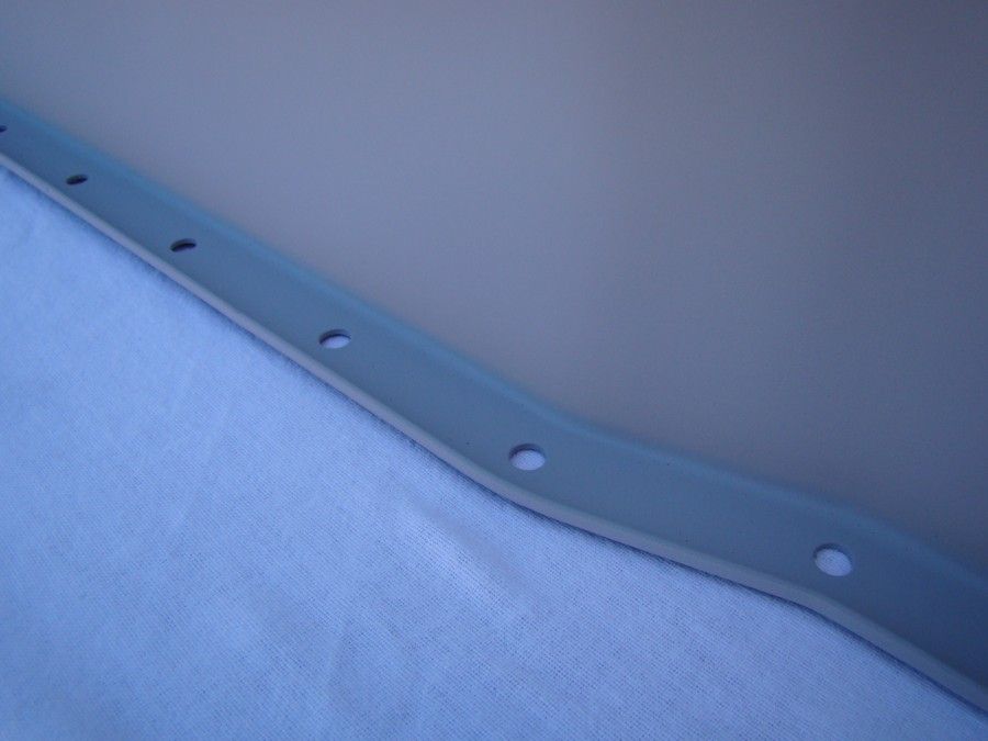

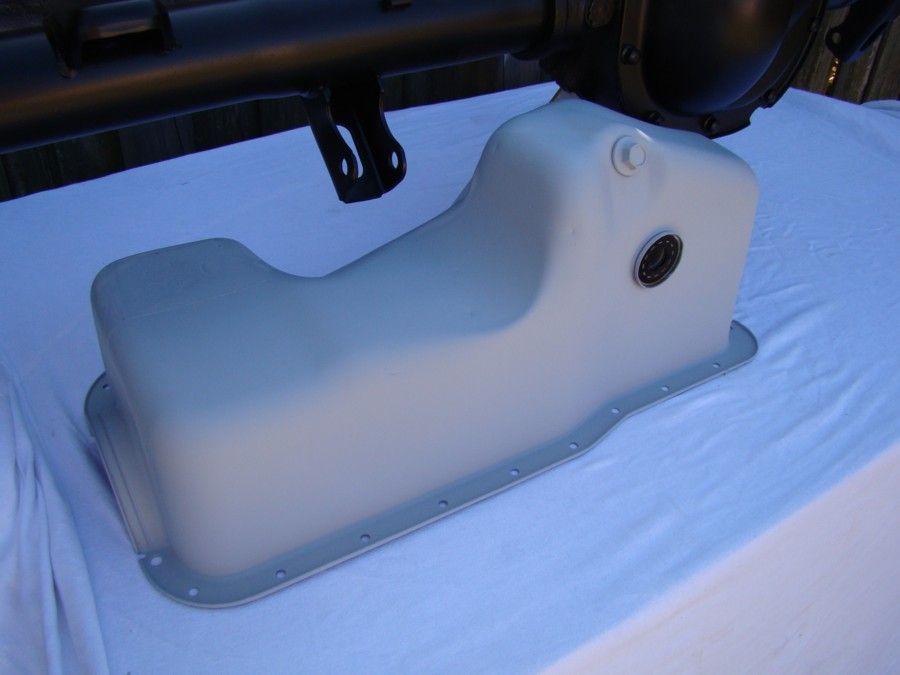

I got the two coats of primer on the oil pan and valve covers a week or so ago. Now a quick scratch with 400 grit wet and they will be ready for another trip through the parts washer before the color goes on and the pieces get bagged and tagged while waiting for installation.

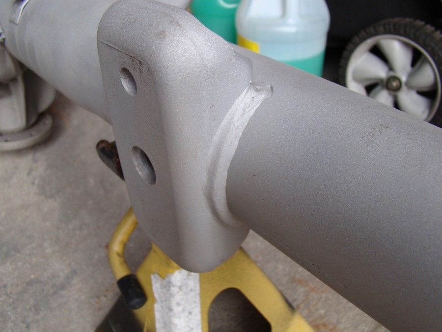

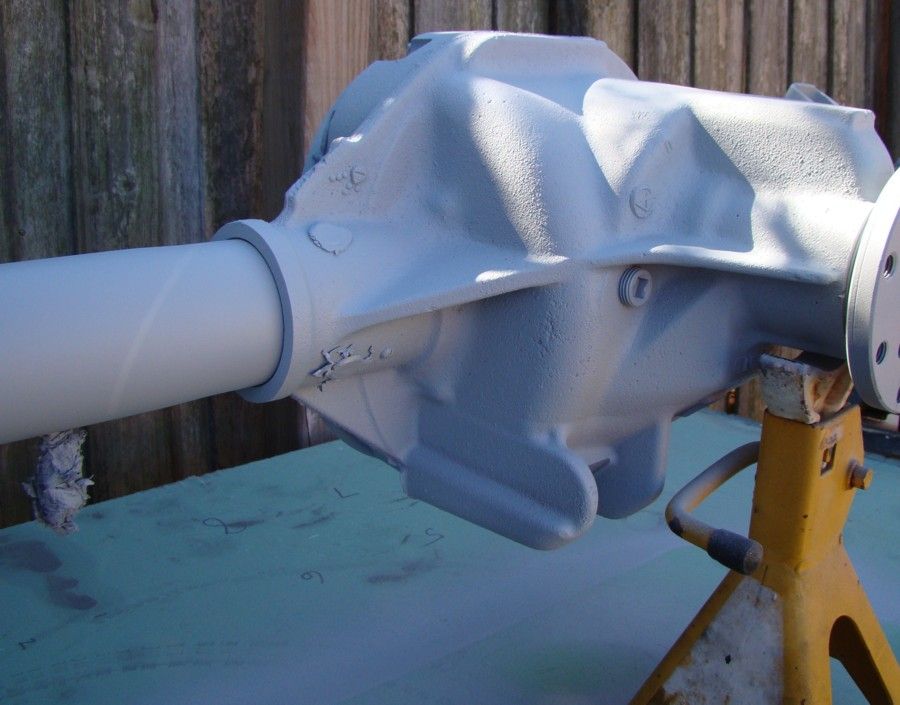

I picked up the 8.8 rear from the media blaster. It sure looked nice clean down to the bone. The bare metal is 100% free from dirt and rust.

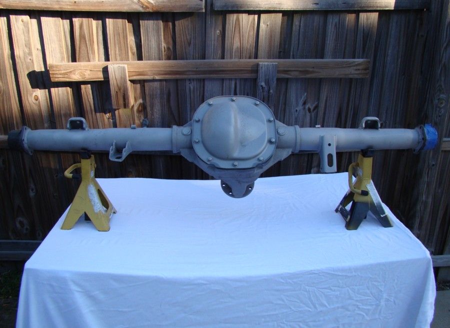

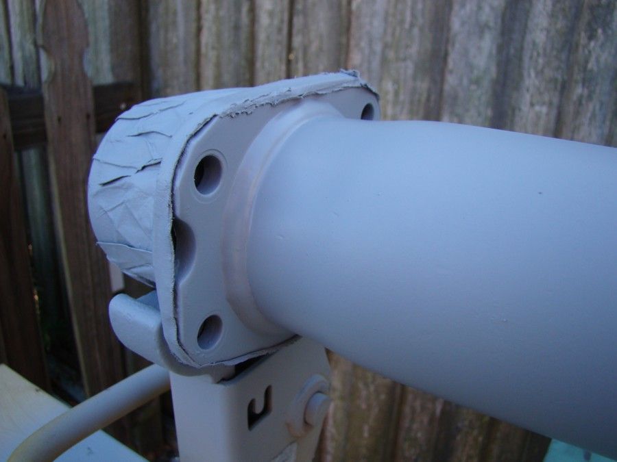

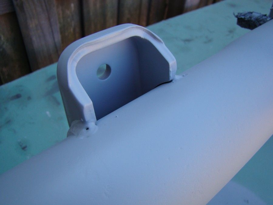

I put two light coats of primer/sealer on it before getting it ready for color.

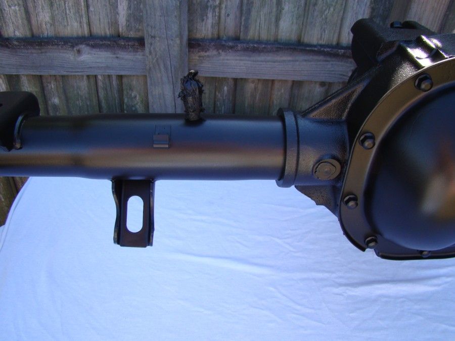

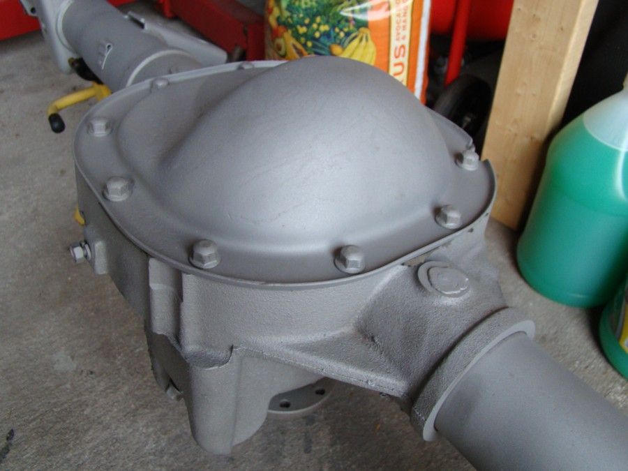

After a quick dry scratch with 320 grit the black base color went on. Now the housing will be shelved until it is ready to go out and have the axle tubes trued and welded. Once that has been completed it will be rebuilt and then touched up with a final coat of paint before being installed.

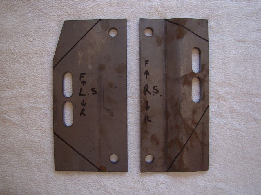

I almost forgot, the engine plates showed up from stradashop. Great bargin by the way! I test fit them and decided to take a little off the sides so they will be going out for a trim before paint.

Your gonna find you will need to lift the drivers side to level the motor, not the passenger side.
SVT
SVT
Not sure what you mean? Are you saying I have the plates listed incorrectly? It looks like it lowers the passenger side.
Okay, then I'm mistaken. It looks like the passenger side actually lifts. I may just have been looking at it wrong. If you haven't, check fitment of the driver side against the block. There is a plug located between the block bosses for the mount. A standard flat plate will make contact, and notching is required...
SVT
SVT
No problem. I am kind of learning as I go. I am not far enough along to know for sure which side needs to be raised or lowered and by how much. My only answers have been coming from photos I have collected (see below) or from the experience of others who have completed their trucks with similar set ups. Thank you for the hint on the driver side mount. You are correct; I did need to outline a small section in the center of the edge that will have to be removed.
