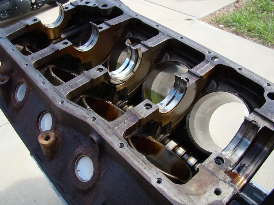

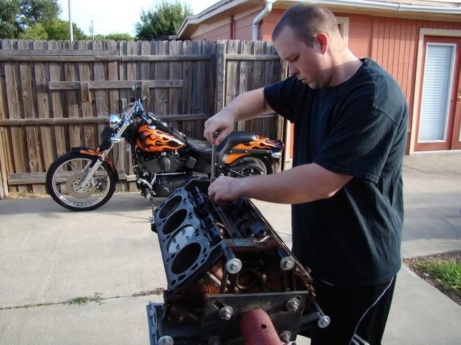

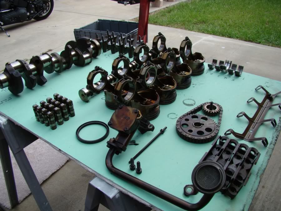

This weekend my son was visiting home from Gainesville and the two of us disassembled the Explorer short block preparing it to be dropped at the machine shop for inspection. If everything checks out it will probably end up being the foundation for the 98 Ranger. This 100,000 mile engine is very clean inside and the pistons wiped clear with brake cleaner, a shop cloth, and very minimal effort.

I have included a few close up photos of the internals. I am no expert so any comments/opinions from other members on the general condition would be appreciated.

Looks good for a 100K motor...How much did the complete assembly run you from the junkyard??

I paid $800.00 for everything a year ago. Complete engine, harness, fan, accessory brackets, airbox & mass air, ECM, etc. I found it the day it came in so it didn't sit long. The junk yard moved it up the line in order for disassembly and I picked the engine up the following day. It was a very clean 01 Mountaineer hit hard in the passenger side (I know I have been calling it an Explorer). I felt good about the condition on my first visit to the yard. The vehicle was clean inside and out with obvious signs of coming from a good home.

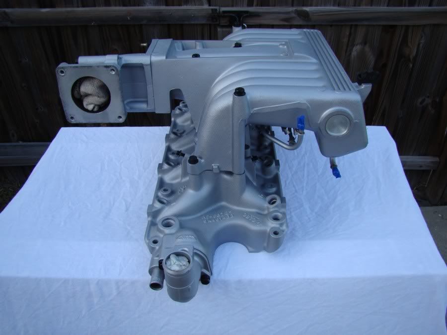

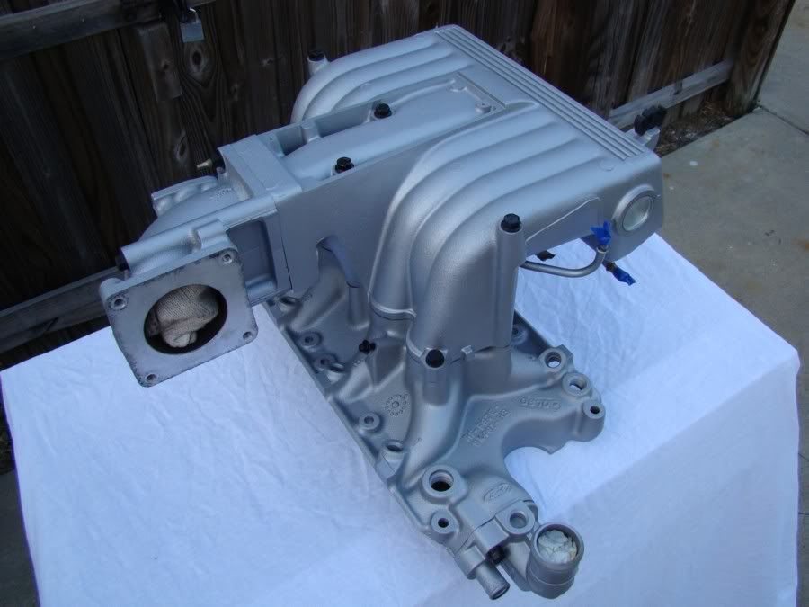

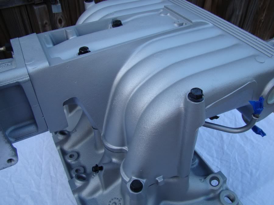

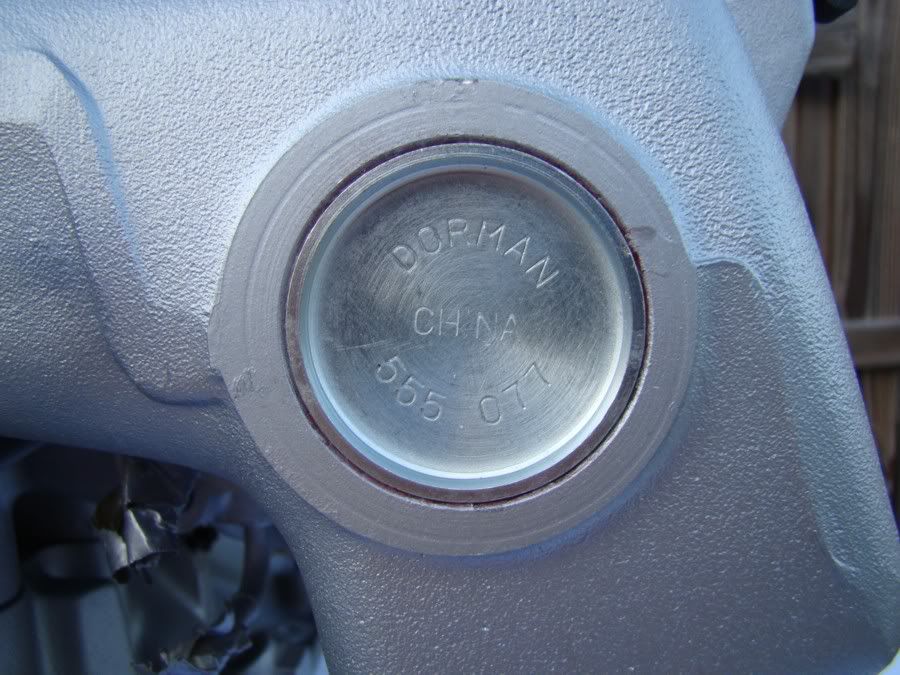

I managed to get the ported upper and lower painted and mocked up earlier today. I also installed new freeze plugs. I can’t wait to see this thing sitting on top of a 5.0 inside my engine compartment.

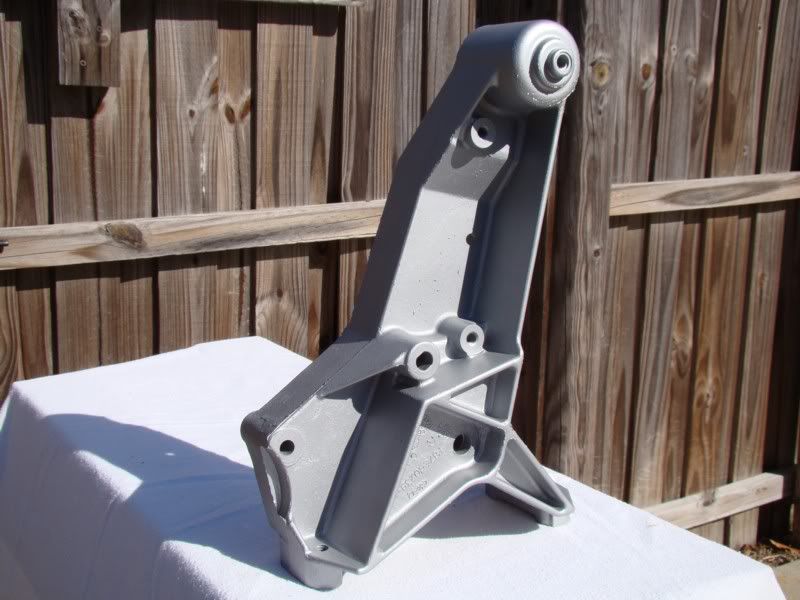

A while back I media blasted my accessory brackets, timing cover, and bell housing and got paint on each of them. I am finally catching up from the holidays and had a chance today to take some photos and update the thread.

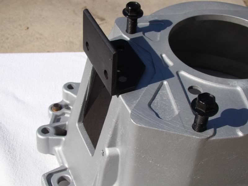

I also test fitted the clutch slave cylinder bracket that my son made. No surprises with the fit as he had it mounted on his Ranger project a while back. I am still waiting on the mounting hardware.

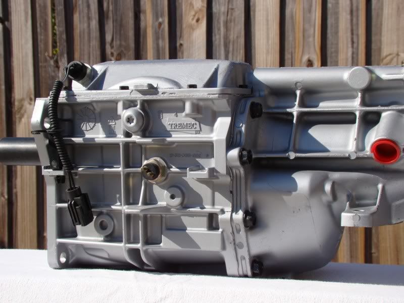

I unwrapped the new World Class Tremec T5 I bought over a year ago just to check and make sure it wasn’t collecting moisture or debris sitting in the barn.

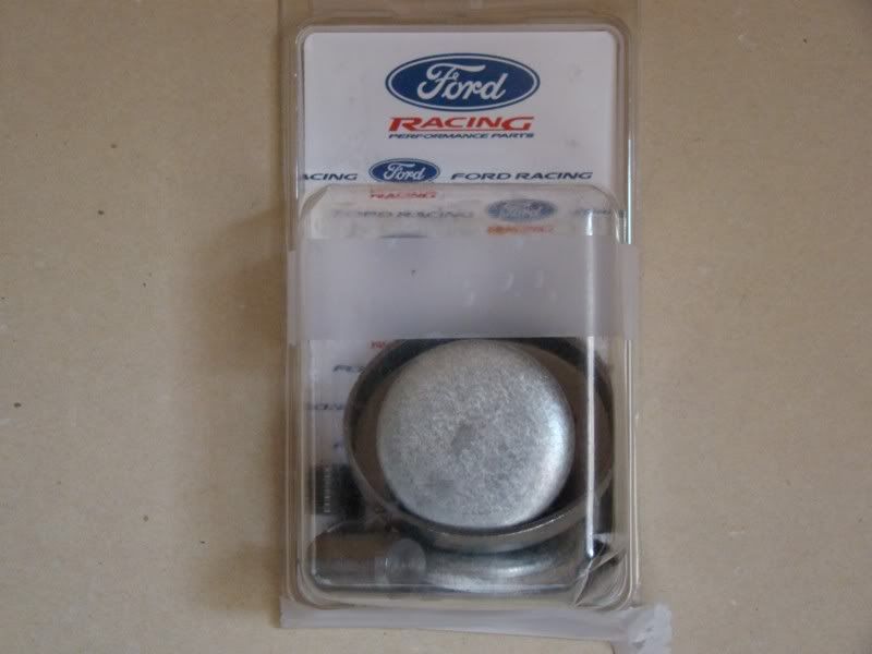

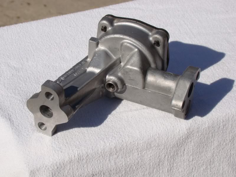

I picked up a few new parts over the holidays thanks to the wife. Ford Racing Oil Pump, Ford Racing Lifters, Ford Racing 5.0 Freeze Plug and Dowel kit, along with an ARP Oil Pan Bolt kit. The ARP Intake Bolt kit was a gift from my son last year.

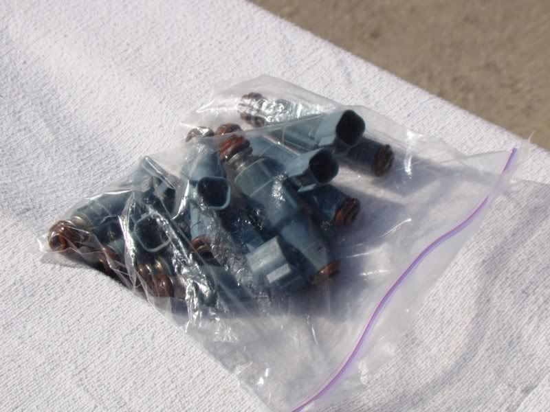

I also picked up some used but rebuilt 24 Lbs Fuel Injectors.

I pressed out the wrist pins/pistons and cleaned/inspected the connecting rods. They will be going out to the machine shop to be reconditioned very soon.

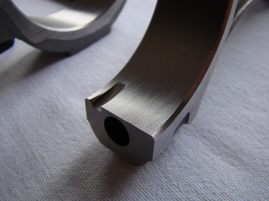

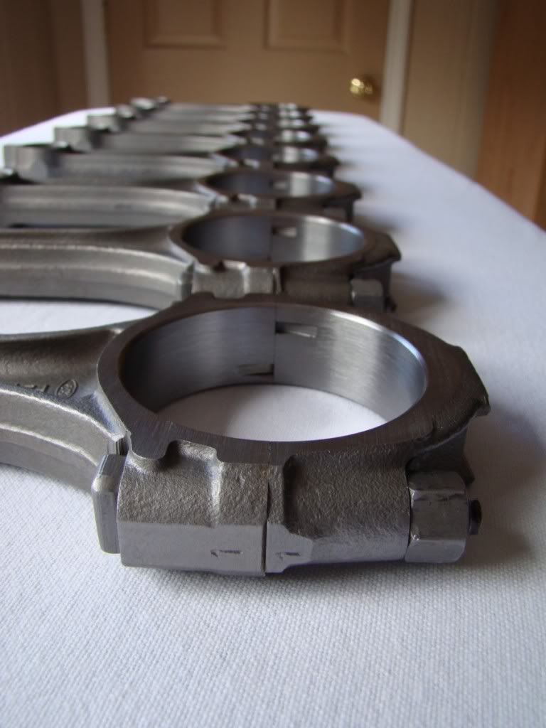

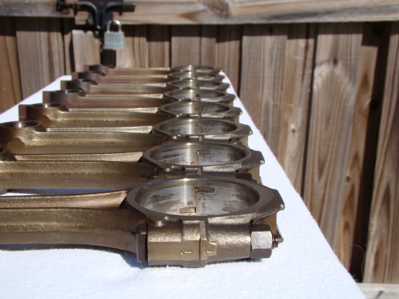

The eight connecting rods came back from their first trip to the machine shop earlier this week. This trip was to inspect the overall condition, check measurements of the small end and large end bores, and determine if any further machine work will be required. After the eight pieces were measured the surfaces were shot peened and the bores lightly cleaned up along with the remaining edges.

All that remains for today is a quick check with a dial bore gauge to verify and record the small and large end bore measurements. The information will be recorded on the blueprinting sheet so it is available in the future. The connecting rods will then be individually lubricated/bagged/sealed until they can go back to the machine shop to be weight matched. Each rod will be balanced for small end weight, large end weight and overall weight. This will be done in a few months along with the pistons and wrist pins.

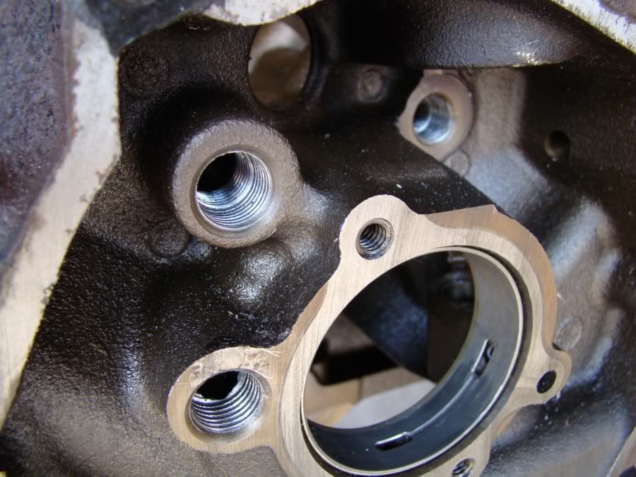

Today I went ahead and tapped the oil galley holes. It was the last thing on the list before the block goes out for machine work. I started with a 1/4 NPT-18 tapered tap and cut all three holes under the timing cover. Now I can skip the press in plugs and go with a more secure alternative.

I then test fit the NPT tapered pipe plugs to make sure they mounted flush to the block. Once comfortable with the fit I removed them and stored them away until the block is ready for assembly.

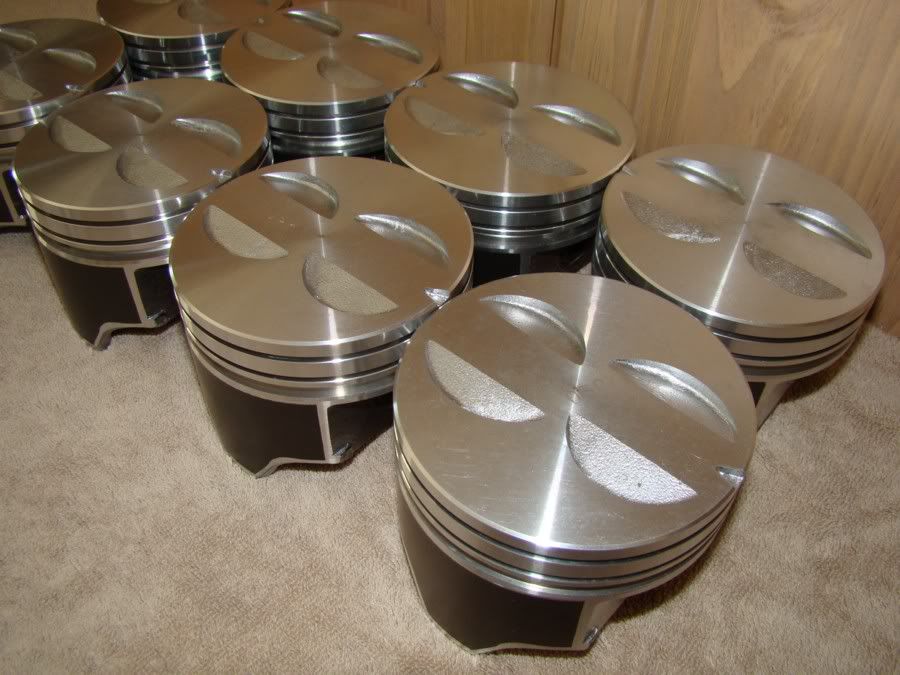

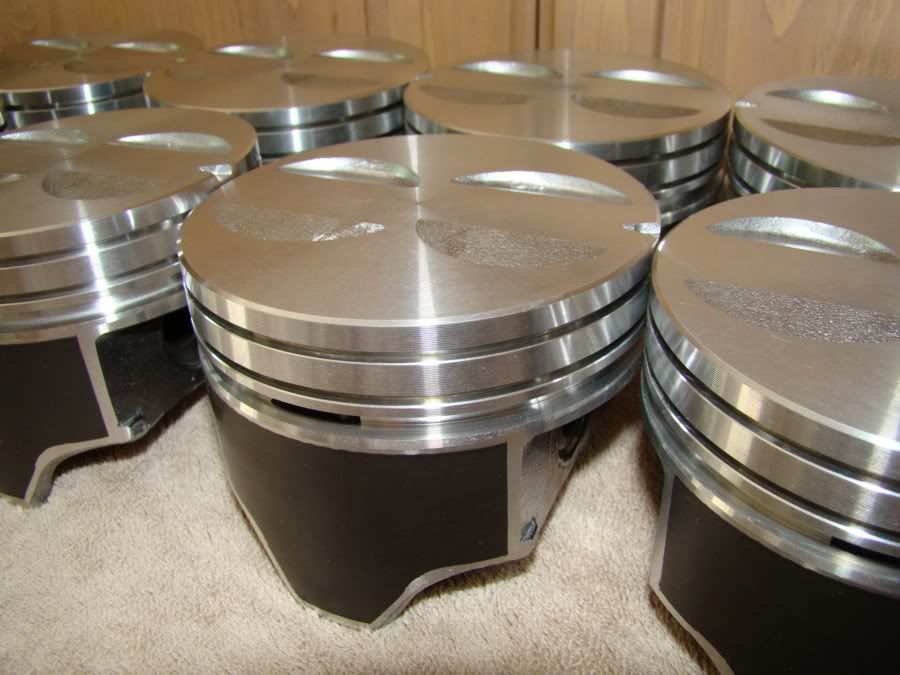

While I was outside working on the block Fed Ex showed up with my Silvolite Pistons. I have been waiting for these for a long time. They have been "out of stock" at most suppliers for a while now.
