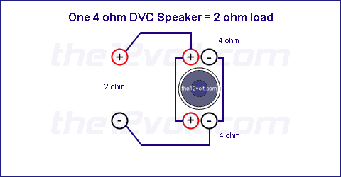

Option 1 (parallel) = 2 ohm load
Voice coils wired in parallel
Recommended Amplifier: Stable at 2 or 1 ohm mono

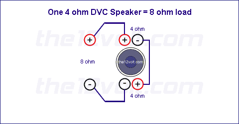

Option 2 (series) = 8 ohm load
Voice coils wired in series
Recommended Amplifier: Stable at 4, 2, or 1 ohm mono

b: wiring it in series (option 2) and run the amp bridged but you will really lose power running it at 8 ohms, but it wont hurt the amp it just wont be as loud
c: wire it in parallel anyways and see how long till it goes into protect and wont come out or lets some magic smoke out.
