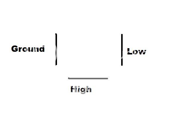

If I'm looking at the back of a H4656 Head light, which tab is the ground??
Told you it was stuiped question.
Robert
I'm wiring up some driving lights made out of headlights, and needed to know which taps was ground, high, and low.
My Ranger right now doesn't have a wiring harness in it or I would have checked it, BUT, I did get my lazy rearend in gear and looked it up in the net, and this is what I found

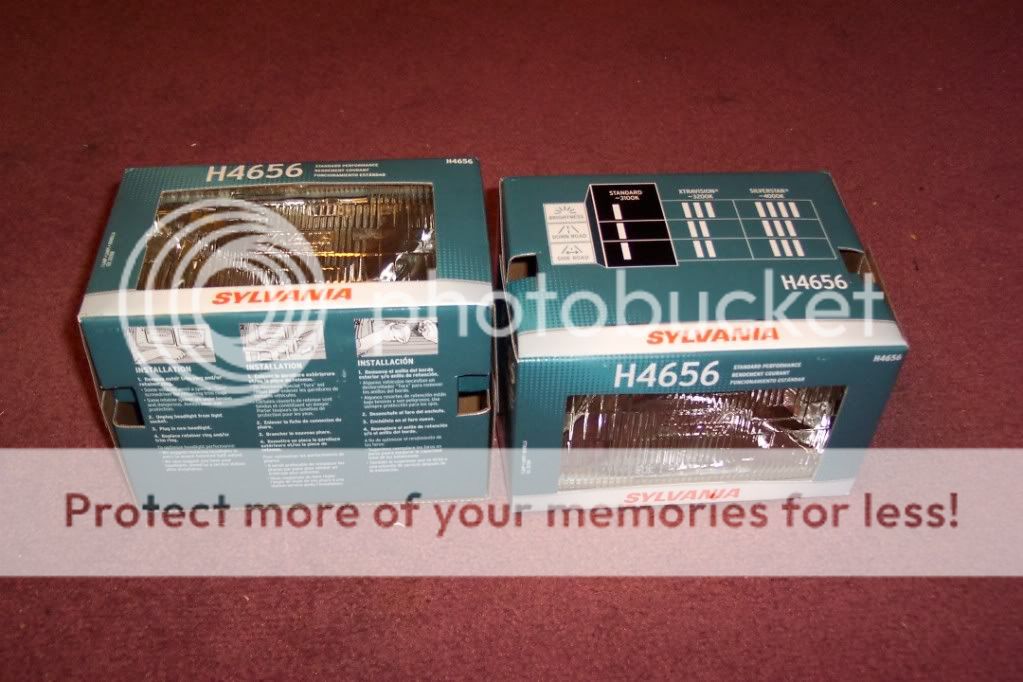

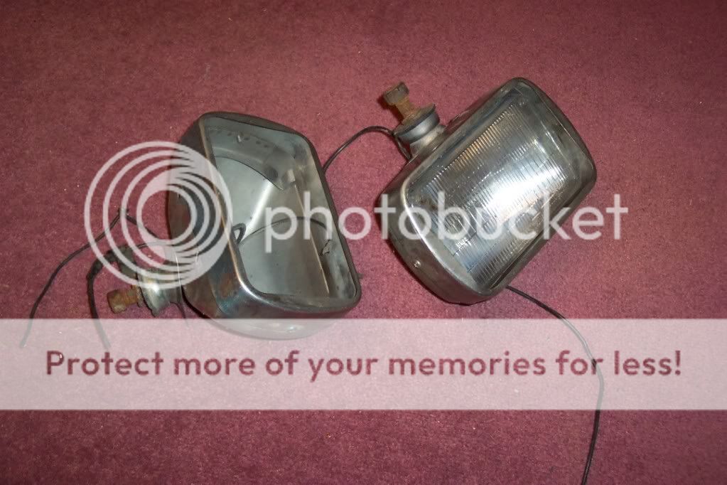

Ok here is the reason I asked the dumb question.

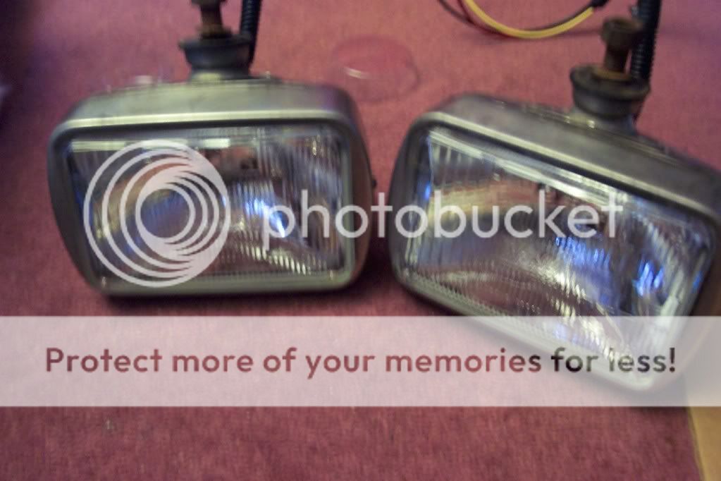

I have these left over from my days of Truck Driving.
and I'm going to put these in them

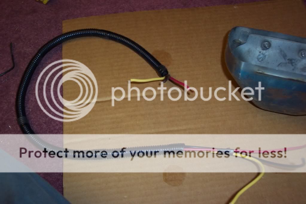

Using these, just for laughs, I used 12g wire.
with the help of these.

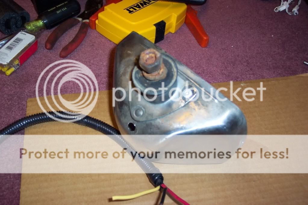

here is the wiring made up for one.
drilled the hole bigger for the wiring.

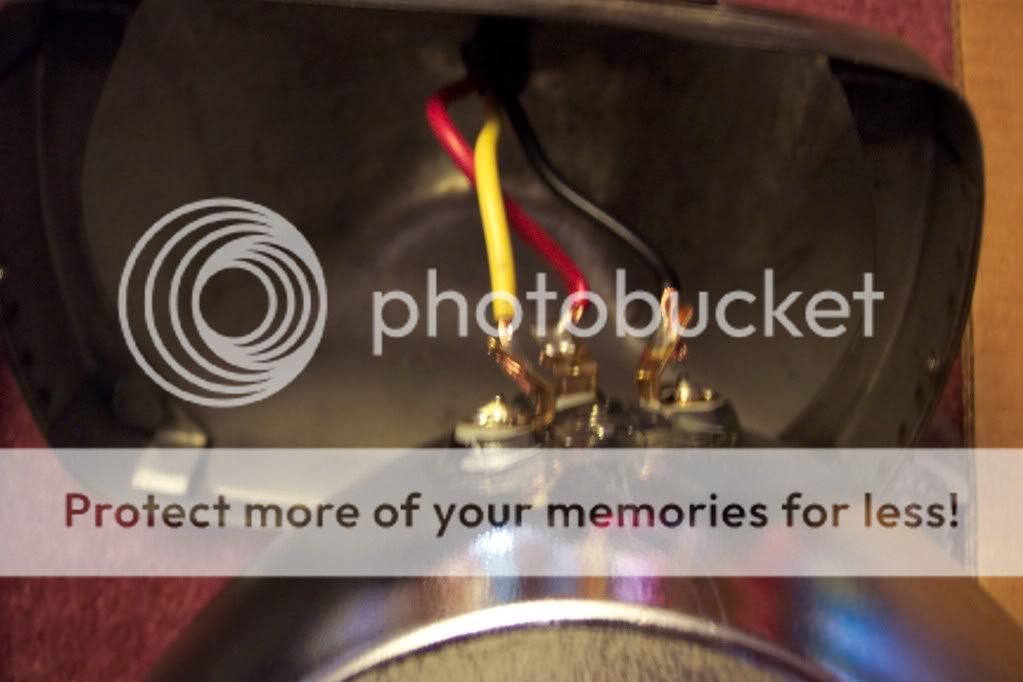

The spade connectors that I bought where too small to fit the lights, so I broke out the Weller and soldered them.
I had to also change out the mounting bolts, the other where pretty rusted and such, but here is the final product just waiting to get mounted.

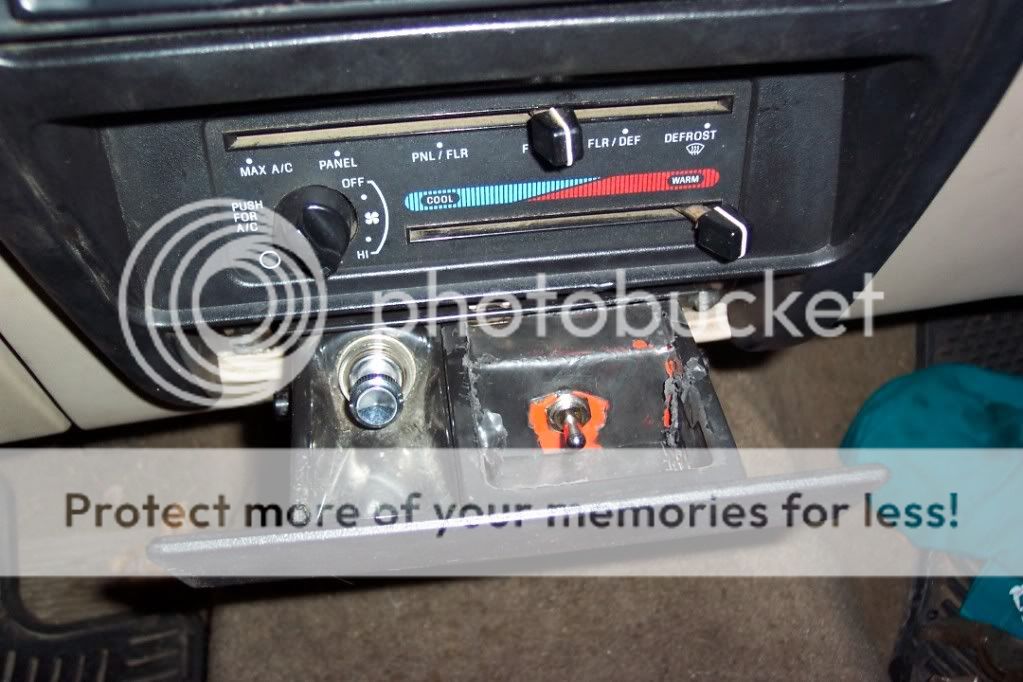

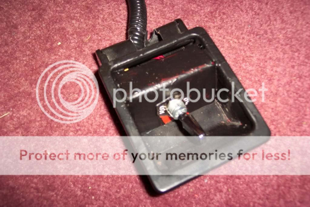

When I was young, putting switches every where on a dash didn't bother me, But now that I'm old, and enjoy the nicer things, I didn't want a fugly switch that didn't belong showing on my dash, so this is what I did, since I don't let anyone smoke in my BII, I didn't need a ashtray, so this is what happen to it.
I made a bracket to hold the switch
This is where it is hidden, if you notice that the switch is different, well it is, the one I bought was bad, and had to use another one I had.

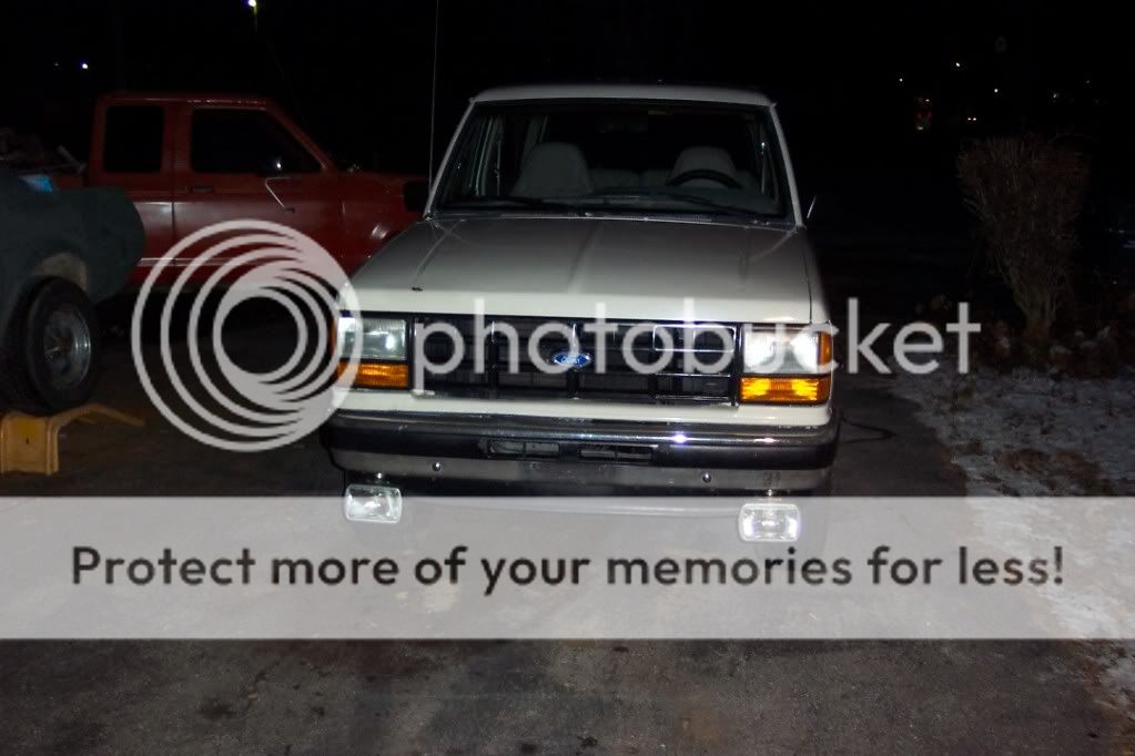

Here they are on front of the BII. I need to aim them still, but I'll do that tomorrow.
I have the main wire going from the battery through a 30 amp fuse then a 40amp Relay, that relay is wired to a switched positive, so if I leave the on/off/on switch on by mistake, it won't run my battery down.
