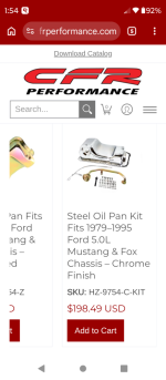

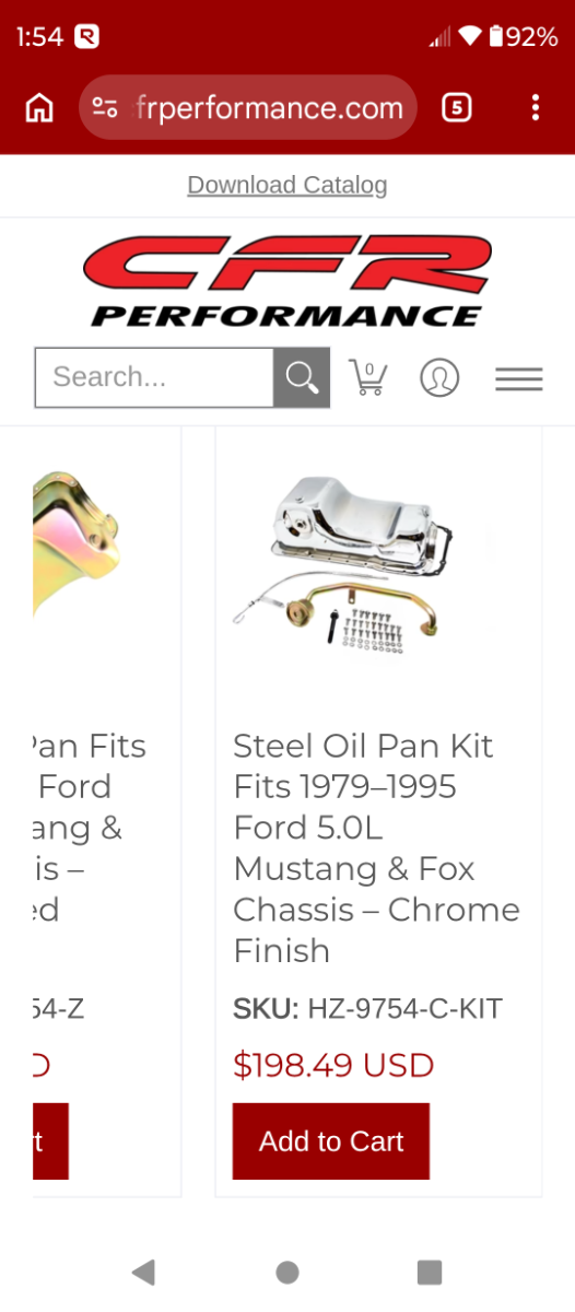

The TTB Rangers require the older 2 sump oil pan used on the Mustangs because the crossmember is different. I can link to that oil pan when I get home, since I recently bought one.

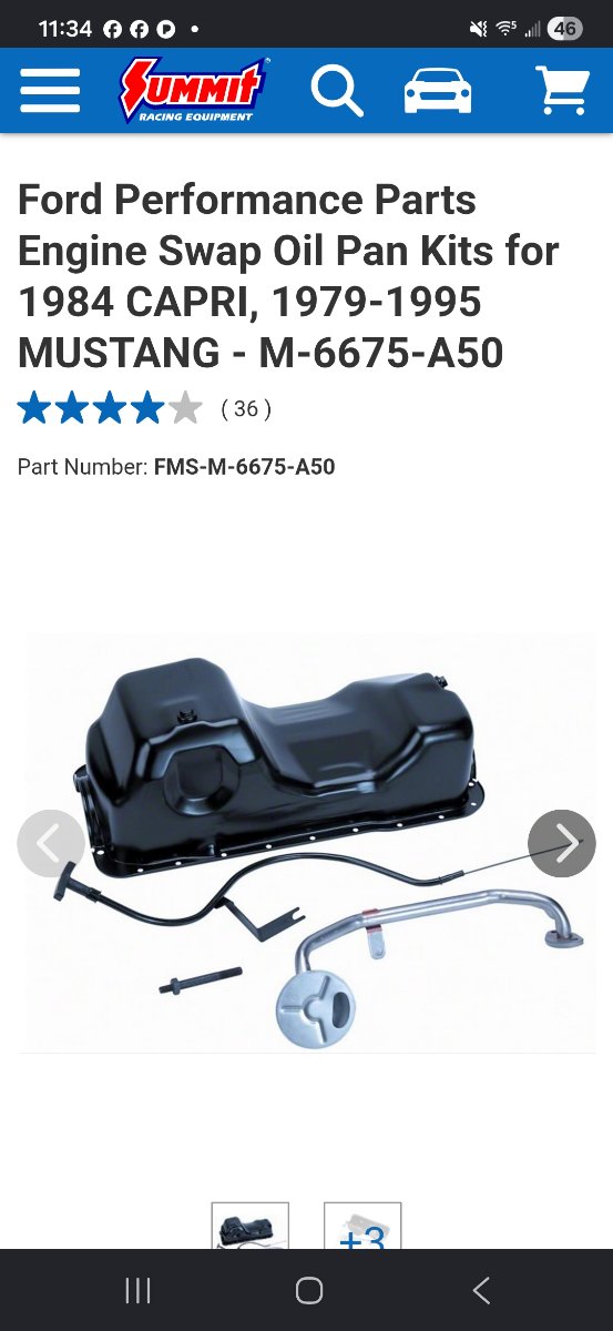

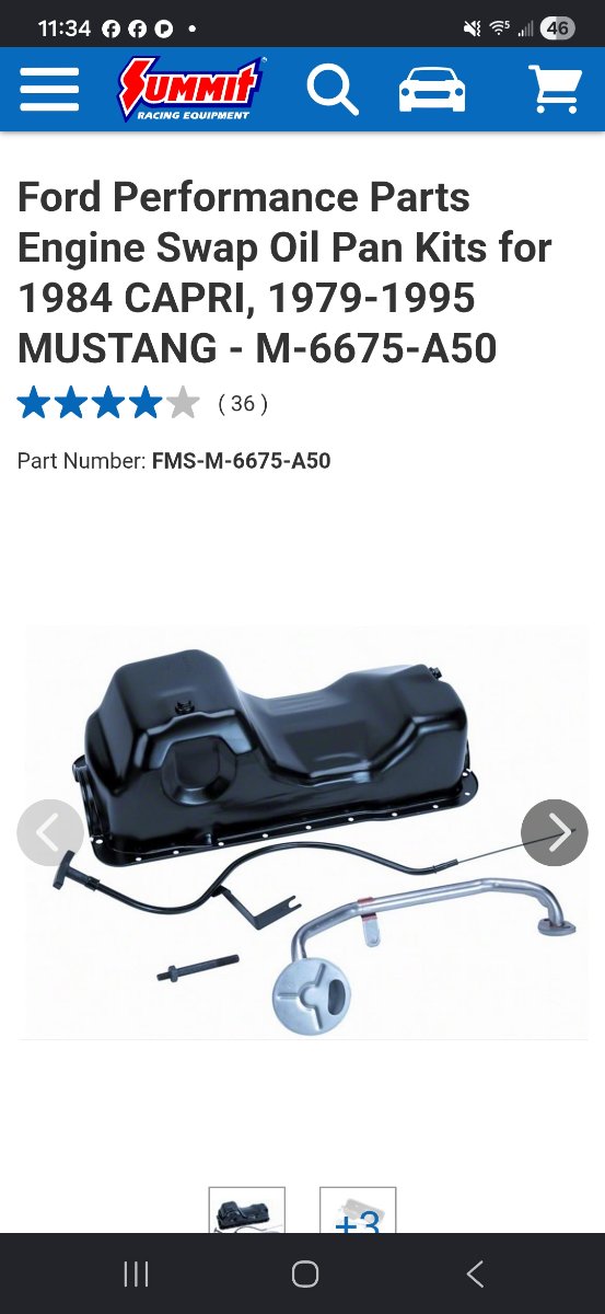

Well, in that case, this is what I ordered. However, It's not actually in the Ranger yet.
Kinda what I was thinking, but u will need new bolts if like mine it's a 98 and aluminum pan so bolts are longer than steel, the aluminum pan wouldn't go in place because I think it was the thickness of it, it is a double sump . Did u get a oil filter relocation kit yet

Yeah, different dual sump. You need the one like what Eric posted.
The one you have is great for 98-11 trucks, not 83-96
Ok thanks, what about oil filter relocation kit brand
This thread has some discussion on that.

I don't have a need for the oil level sensor, my stock pan has the port for it and it seems to enjoy leaking for the fun of it.
I like that the Ford kit doesn't have the port for the oil level sensor.
Cheaper may be thinner/easier to warm and harder to seal as well. Cheap chrome stuff seems to like to rust as well.
Debating transferring the sensor to my new pan. Not sure I want to drill the hole. I left the wiring in the harness just in case.
