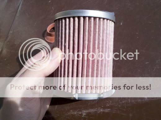

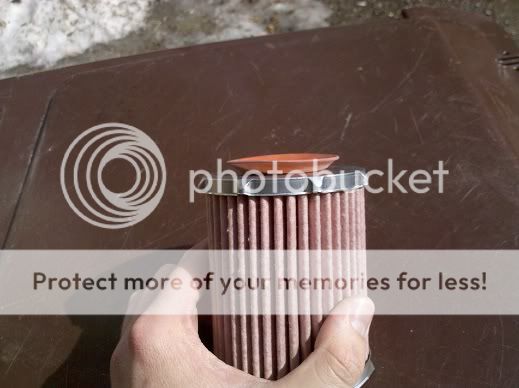

Fram Xtended Guard XG8A:
Just a shot of the filter element itself. In the XG series, they actually have metal endcaps.

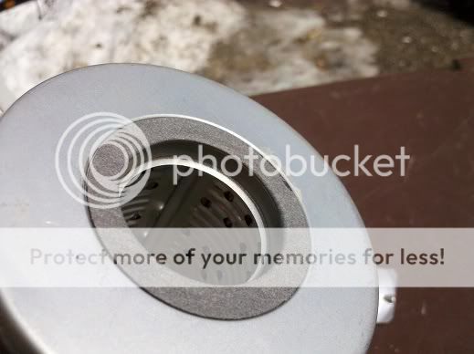

On the bottom of the filter, you see a seal/gasket for where the leaf spring/bypass will seat. You also MAY or may NOT be able to see the metal screen through the holes of the steel core.

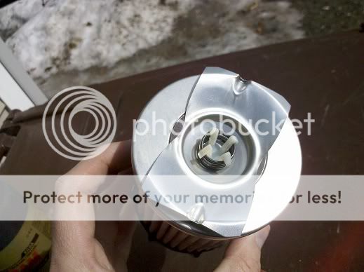

Here you see how the spring/bypass sits on the endcap. it does form a relatively nice seal, or so it would seem. the big negative, is that they STILL use the cheap bypass valve... plastic.
On the top side, we have a antidrainback valve that actually fits somewhat snug in the endcap, whereas on the TG and PH series just sit loosely.
