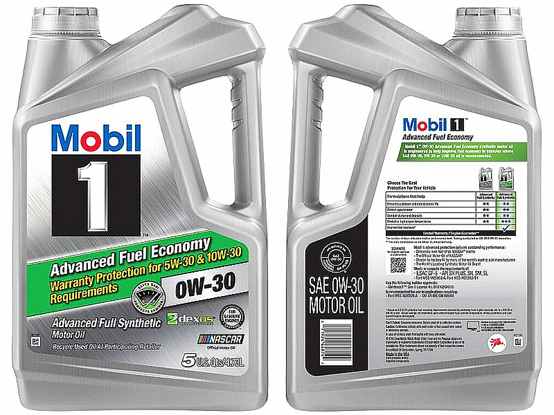

You've got a good looking truck & clean looking engine rebuild.
2001 SportTrac here with >250kMiles & all original V6~4.0L~SOHC + 5r55e +1354; equal to a 2001 Ranger ExtendedCab.
Been changing Oil+Filter every 6mths for several years now, using 0w30.FullSyn in the Spring, 0w20.FullSyn in the Fall.
Prefer 0w so don't need to wait for 5w to warm up, gets oil to those OilPressurized TimingTensioners ASAP on ColdStarts;
but I live at 9kFeet elevation with below zero winters; recommend 0w30.FullSyn year round for the "Hot 'Bama" climate.
Typically use Mobil1 or SuperTech\Warren oil. Also do "GasPedal To Floor" prestart crank for 5~10sec if truck has sat for more than 12hrs.
Use K&N# hp2011 Filter ( 14psiByPass 14gpm Rated ) instead of Ford# fl820s (16psiByPass 13gpm Rated).
Changed left+right TimingTensioners twice now in 22years, using OEMs.
Have installed Cloyes Tensioners on friends engines; slightly shorter maybe 1mm than OEMs, but had a better\thicker washer seal.
