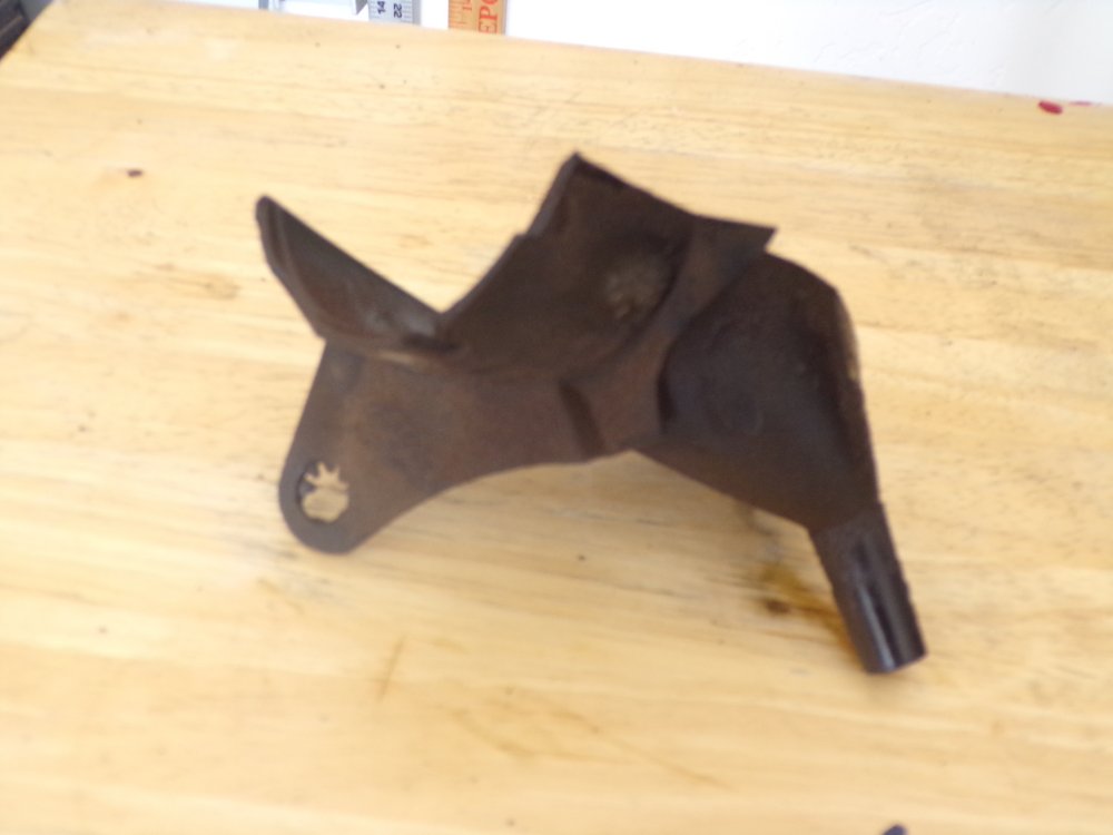

I know I should follow my wife's advice and take my '05 Ranger 2wd stick shift to the dealer for an oil change. I can afford it and since I just turned 74 and am not a dainty guy I can see her reasoning. BUT I am stubborn and my parents grew up in the Depression.
I buy the 5W30 synthetic oil from Amazon and use a Bosch filter. I would like to meet the engineer who decided to place the filter almost horizontial on the side of the block. Then they attach a type of plastic funnel in front of it and expect a guy to be able to get a wrench on it to take the blasted thing off. What a bear to get to.
THEN you have to try to reach up there and line up the filter onto its pipe thread while your arms fall asleep from being up in the air so long. And it REALLY did not help that I pre filled the filter 3/4 full of oil as most of it ran out and caused the filter to be very slippery. Grrrrrrrr!
I finally grabbed the plastic funnel and ripped it off. This allowed my to get both hands up there to line the filter up and spin it on (after drying it off with a rag).
Pic of the evil device. I can see the reason for putting it on there but I do NOT like it.

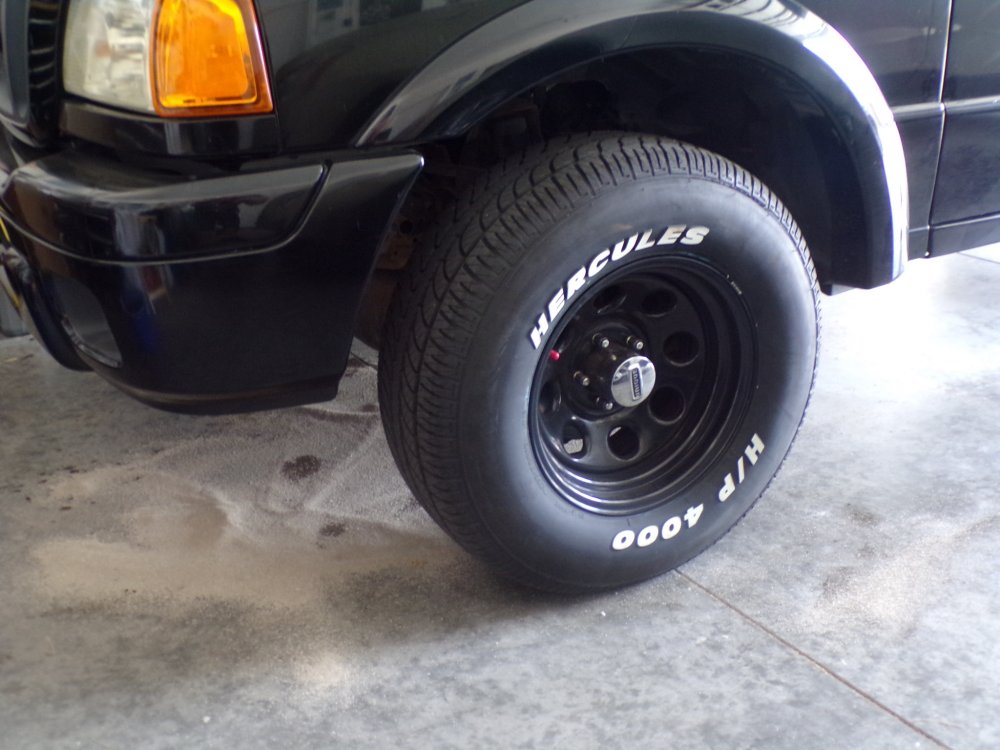

I threw in a pic of my new Cooper-made tires too. These are a bit taller and wider than the stock tires and they ride great!

I think the funnel was a great idea. I grab the filter from the top, so it's not in my way. Maybe look for a better filter wrench that allows you to get on it from above?

Also, when the funnel has been removed, the oil just drips down onto the starter and makes a sludgey mess in a bad place. I did a filter relocation on mine that has made the whole process cleaner and easier.

I think the plastic funnel is great because it keeps oil from running over the starter when removing a filter.

I tried laying on the left front fender but since I have short arms and am kinda chubby I could not reach the fitting and line it up correctly while trying to get it started. I tried 3 different stools, ladders but it just would not work. Looks like I will be removing the left front tire next time and I will reinstall the funnel this weekend. Just needs a medium sized washer so the bolt/screw will be able to hold it on.
Truck is an Edge model so it sits high and since I just installed larger tires it sits even higher.
I have an Edge model too, grip the filter from underneath to remove. The funnel stays...! The only shortcoming is (thread here or u toob?) shorting out starter when contacting w/filter-
