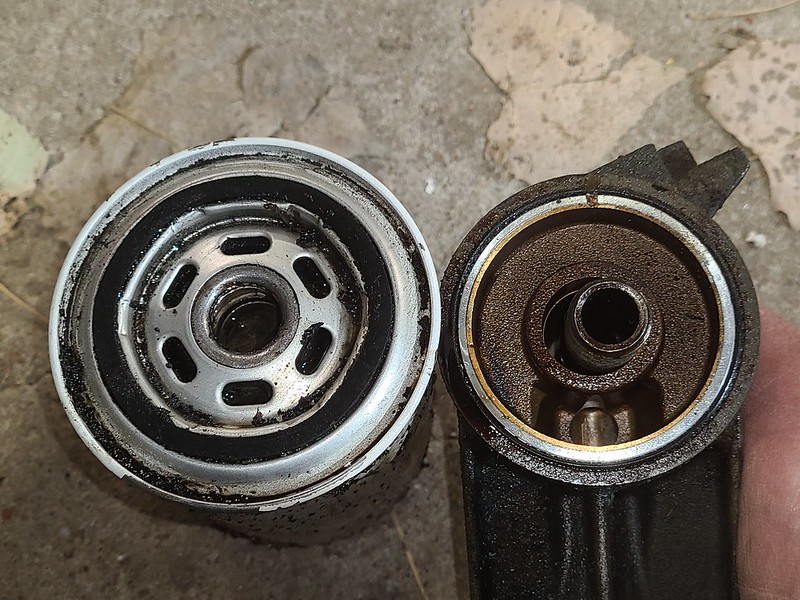

Compared to a old FL1A
They are not "just" o-rings, they are bumpy weird alien looking things
