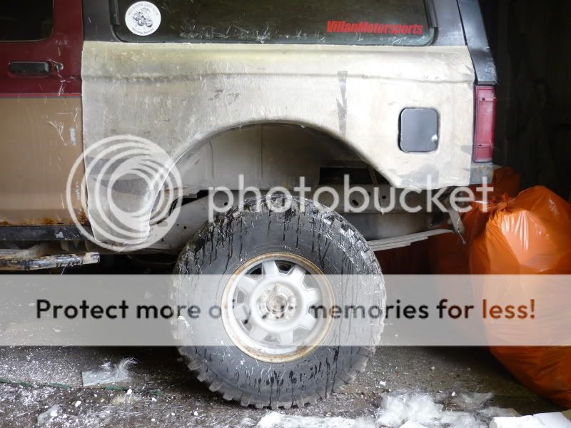

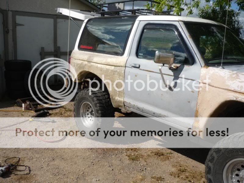

looking good except for a few dry spots,no biggy.a dremel works good to sand in the bubbles so the bondo will stick.
if it ends up you need to extend or repair it in some spots sand the edge or crack down to a knife edge and lay up on both sides(not neccesarily equally but is has to be both sides) or it will be a lot more likely to crack there.

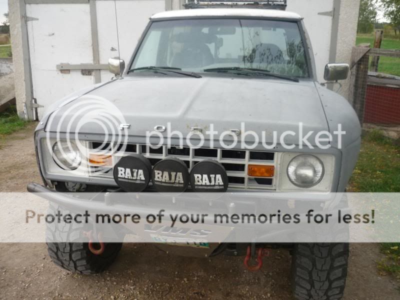

An incredible looking truck, you’ve really put a lot of hard work into it. When’s the truck going to be painted….some day maybe:D
Nice bulging muscles!

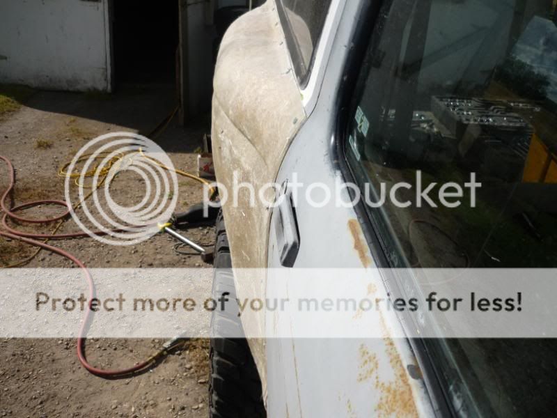

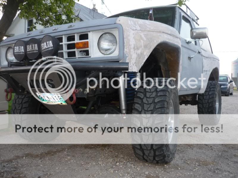

I like the sort of finished front inner fender...
After a lot of reading that was one of the beefs with the fiber fenders is they offered little to no protection to the front of the doors.
Adding the lip on them made them alot stiffer and I get some what of a inner liner. I've got to chop up a stock inner fender liner and make some motor shields.
Should be able to wrap up the bondo work this week.:icon_hornsup:
