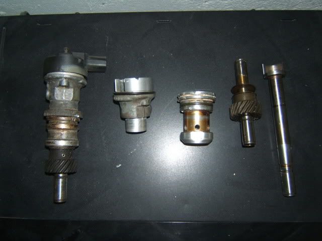

I'm working on a mechanical solution for the check engine light:
I machined down a OHV cam sync and a SOHC oil pump drive. Mated them together, but havent got a chance to weld it and install it. I blew the 4r55e in my Ex and am pulling the whole conversion and installing the Cummins 4bt.
now that is pretty sweet! i know the 95 sensors are a 3 wire set up and the Sohc is a 2 wire. i did also notice a 98 up ranger is also a 2 wire....
Incase you were wondering, you come up with the parts, Ill machine them.
You need an oil pump drive from any SOHC, and a 2 wire cam sync from a newer OHV.
There are 2 different length shafts on the newer cam syncs. (123 and 132 mm) IIRC You need the 123mm, but I'll check and make sure.
OH yeah, I never checked to see if it would clear the head and intake (like i said, I havent finished building it), but i'm assuming it will.
