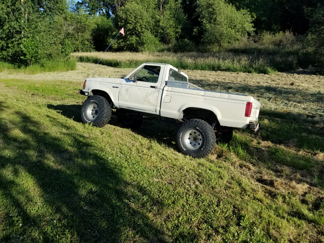

I have both, but my most fun is the '90 4x4 turbo Ranger on 35" tires... it's the one I've been into the transmission and intimately familiar with the engine... well I was when I threw it together with the best parts I had on hand 10 years ago... come to think of it that's probably why the turbo oil seal is done... I should put together another long block to have on hand, once I get to my crate of spare parts in the garage that is... when I say I changed both axles I swapped to the bigger Dana 35 front axle and Explorer 8.8" rear with 5.13:1 gears to handle the tires and do a 6" lift.
