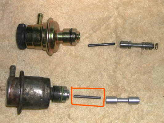

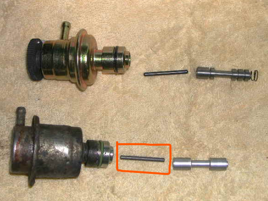

I will start with the vacuum modulator and after replacing that see what I get.
