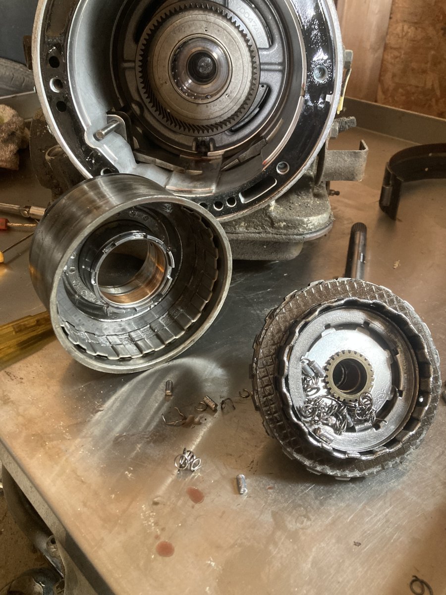

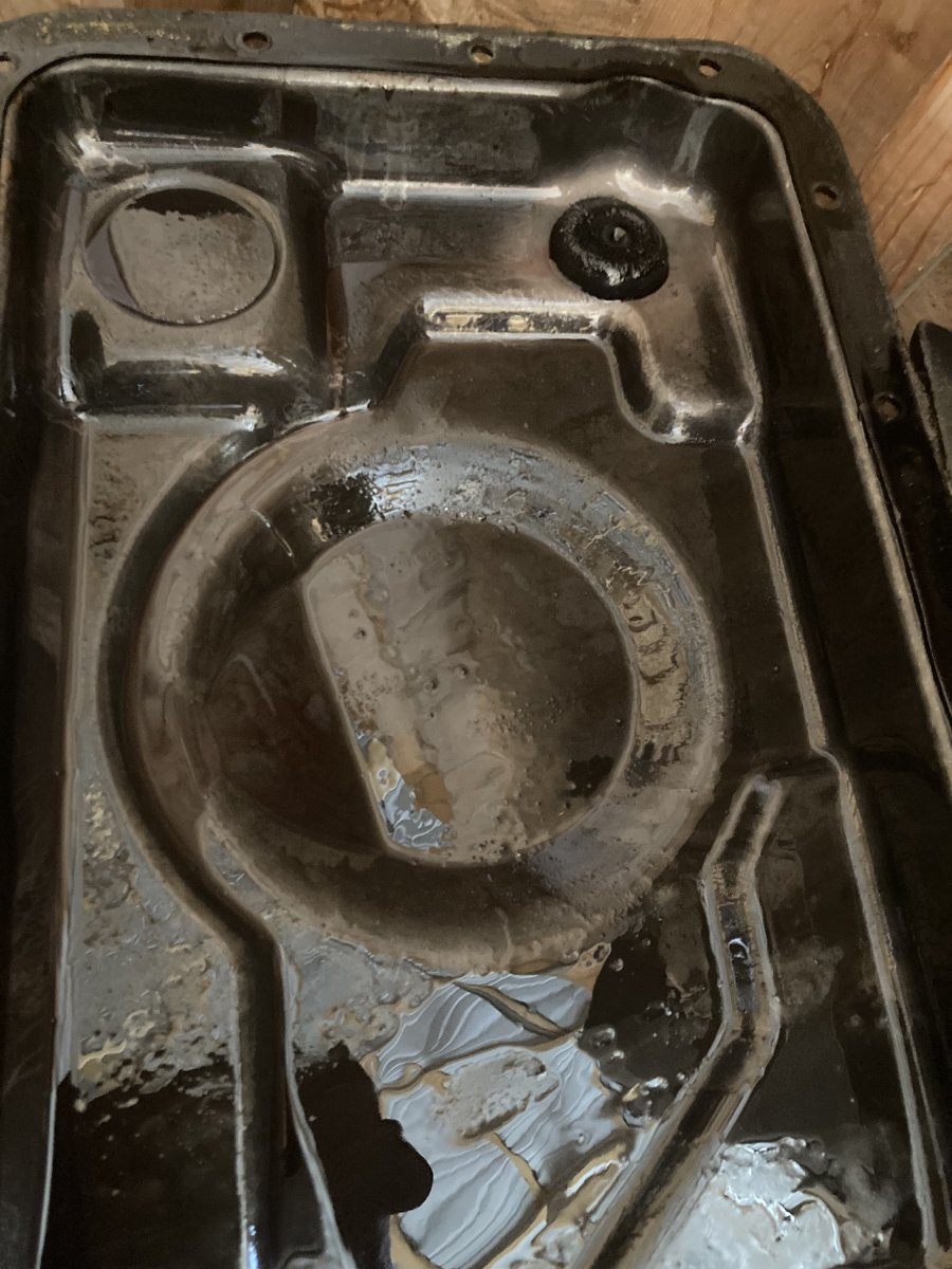

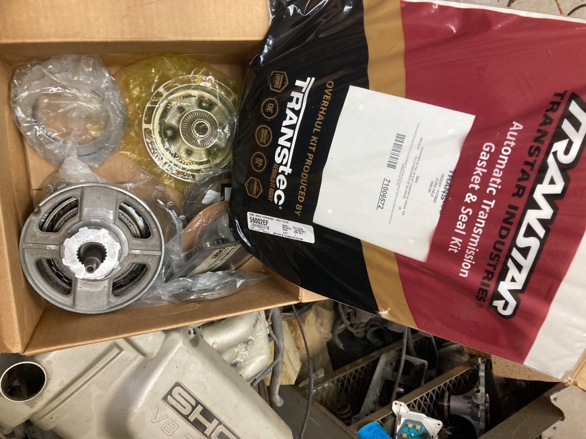

1989 with a jasper tag. All the mess stayed in the OD drum, band is pretty smoked. Sun shell dogs are chewed up. Clutch apply piston is hosed.
order parts monday.
