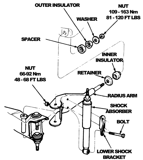

The Tab is not a 3rd style. There are only two.
One, has a welded stud. This is the newer style.
the second, Has a bolt that goes where the welded-in stud would otherwise be. To hold the other end of the bolt and keep it from flopping around, there is a little metal triangular bracket/tab that also bolts to the arm. This is the older style.
Top picture is the New/Stud
Bottom picture is the Old/Bracket (tab)
