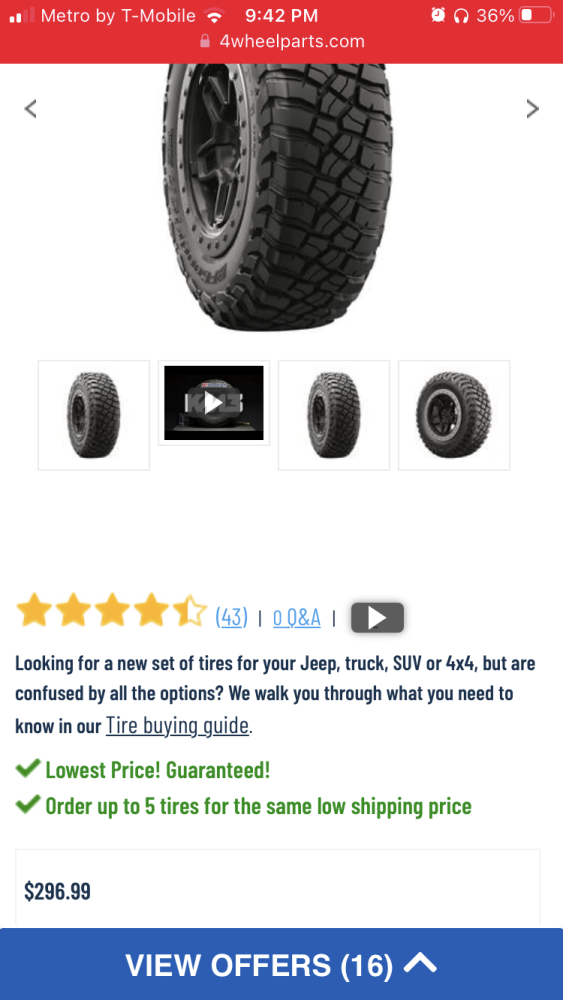

How do the KM3's do? I've had the KM2's since like '11 and they're getting older but still holding up fine for now... the RBV platform on 35" tires is a good balance I think...
Nice, being in an Explorer I'm staying narrow, trails around here aren't wide and I prefer to stay somewhat narrow and I don't want to break spendy glass fenders... plus function is way ahead of form...
Man let me tell you! We went from steel Pro Comp Wheels and 35x13.5x15 Toyo MT's to the Level 8 Aluminum and Km3's. It felt like I just supercharged the truck! The weight of these are almost nothing compared to most other tires, but next to a toyo MT almost non existent. Welded Diff, California Summers along with SHIT roads and constant wheeling. I have had not one complaint with them. And at only $270 per tire for the 15 we will be buying a new set. These have around 25k miles on them in the pictures above.
I would NOT recommend them for anything larger. These tires on my FJ80 are dead in under 20kmiles with open diffs, light wheeling, and D load rating. That truck does much better with the Federal MT's on it now.
If I had to choose another tire right now ( MT ) I would get a set of Cooper Discovery SST's. I love the tire but haven't got to personally test them. I have been warned by thin side walls. But that's depending on your off roading conditions.

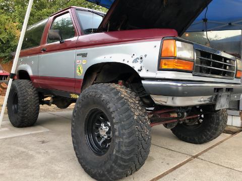

This is a picture of the Toyo's and no tube work
