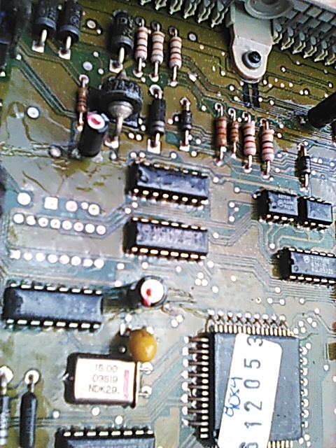

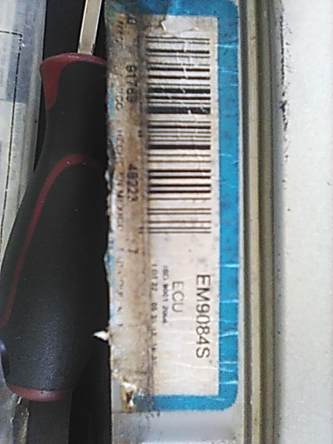

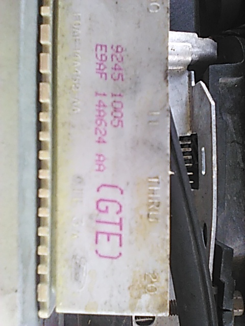

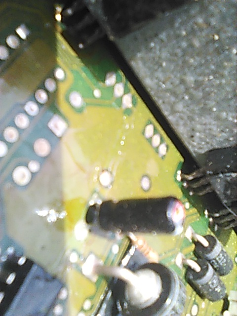

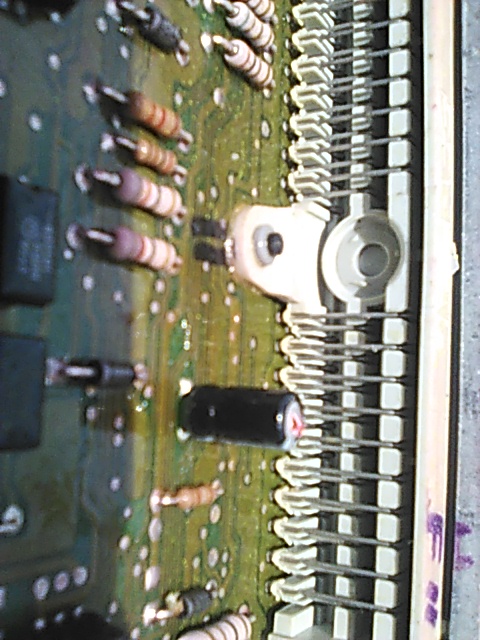

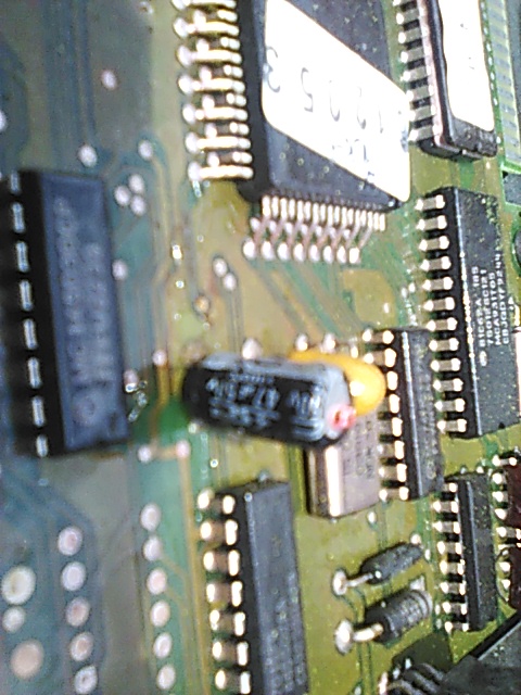

Just pulled out the ecm. Want to have a new one ready if I botch the old one soldering the capacitors. But when I go to rock auto I don't see a match. Here are the pics I took. I got an old flip phone so they aren't that great. Can someone please tell me which ecm on rock auto is the right one? I typed em9084s and google showed ecms with that number, one at rockauto. But when I looked at it, it said nothing about being for my 94 ranger and looking under 94 ranger 4.0 em9084 doesnt even show up.. Also I'm pretty sure the paper sticker says 2008. And the capacitors have scratches under them. Somebody's been in here before.
It looks like that's a rebuilt computer, Caps were Blue in the original, usually, and never seen the "red" on the top of each
Do they look OK, can't tell from pictures?
Are both wires still connected, move cap with finger to tell
They corrode on the under side and wire breaks
So it may be OK, the black ones cost more but last longer
One looks like it has a corroded soldering point. The other 2 look fine. Id like to just get another computer. How can I figure out which ecm to get. This just might not be the correct ecm.
You need an EEC-IV, 1993 or 1994, for a 4.0l engine size and Automatic trans
(1995 and up Rangers used EEC-V, so would work in 1994 or older)
2WD or 4x4 don't matter
If it has an EGR valve, which is unlikely in Florida, then you need a Calif. approved computer
It should have a part number that starts with F37F = 1993 Ranger, or F47F = 1994 Ranger
Then 12A650 = ANY COMPUTER in a Ford vehicle, Mustang, Fusion, ect........all have 12A650 to this day
So 1994 would be F47F-12A650-???
The ??? was Fords code for engine size and transmission type, and Ford never released a cross reference
And they use several different ??? every year for same engine/trans combo, so there is not one set code for 4.0l automatic
So F47F-12A650 part number can be for a 1994 Ranger with 2.3l, 3.0l, or 4.0l engine and either a manual or automatic
So best you can do is ask what a computer came from, engine size and transmission type
Its those last three letters in the part number I can't figure out. The ecm I have doesn't even have a f47f pt number.
Yes, you are going to be able to use any of the numbers on your current computer as its not original, so rebuilder could have used any chassis from any Ford EEC-IV
You want an F47F-12A650 for a 4.0l engine and automatic transmission
You would need to ask Ford
On "regular" parts the last 1 to 3 number/letters are Revisions, AA would be first part, AB would be same part but updated slightly, then AC........ect..............
BUT.........they also used those as designation for included firmware, i.e. GEM module for no power window/door lock might end with AC, but if it had power group it ends in AE
The PCMs, computers, will be like that, ending A7E might be for 2.3l with manual, T1F might also be for a 2.3l manual
And that's just for 1 model year, A7E might be for a 4.0l Automatic the following year
There are all sorts of oddball stuff that must have made sense to Ford at the time, and still, lol
I am sure its all in a book somewhere but I have never seen it
Called ford gave them my vin. They gave me the ecm part number F47z-12a650-cla
Then they told me that part was obsolete. So I Googled it and found alot of places saying they had it but when you went to thier website it was either out of stock or discontinued. But I found a site that cross checked ecm's and it said F47F-12a650-cla would work. So I bought that one from rock auto for 171 bucks.
I'm wondering why the same company charges a different amount for the same ecm with a different part number. If they all work on the same truck.
