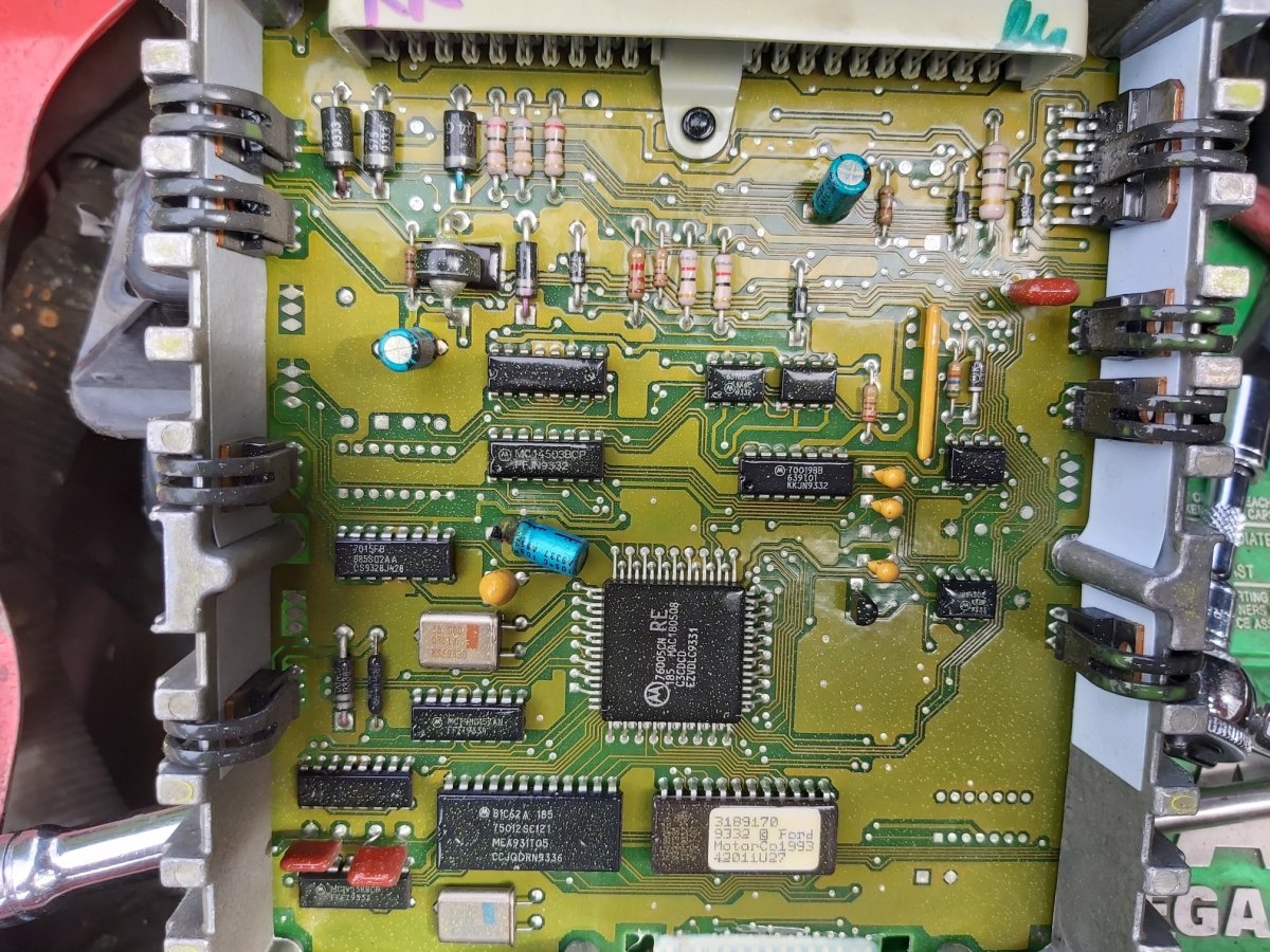

Also the capacitors i replaced were different sizes. two were 47uf50v one was 10uf63v. Is that right?
i installed three 47uf16v capacitors in there places. They were much smaller but they work....so far.
The voltage is the big deal, you will need to change those, you can go with a higher voltage, just not a lower voltage
i.e. you can use 47uF 63v(or 100v) in place of a 47uF 50v
They are not expensive, even if you have to buy 5 of each kind
And of course Polarity matters with this type of capacitor

Let me get this straight, the capacitors have a positive and a negative lead? Thats not good i just soldered them in. I have ordered 47uf50v's and 10uf50v's capacitors. I'll redo the ecm when i get they get here Tuesday. But ill have to figure out where that 10uf50v goes.

Picture of my 1994 PCM before changing caps, if connector is North, negative side of Caps are facing east
The bent over one was me moving it and wire was broken, top one was the same
I don't think I still have a values for each location
63712
I deleted the pics I took then I remembered I posted them here. The negative is to the right as you said. I'm going to open up the new ecm I bought to find the 10uf50v
