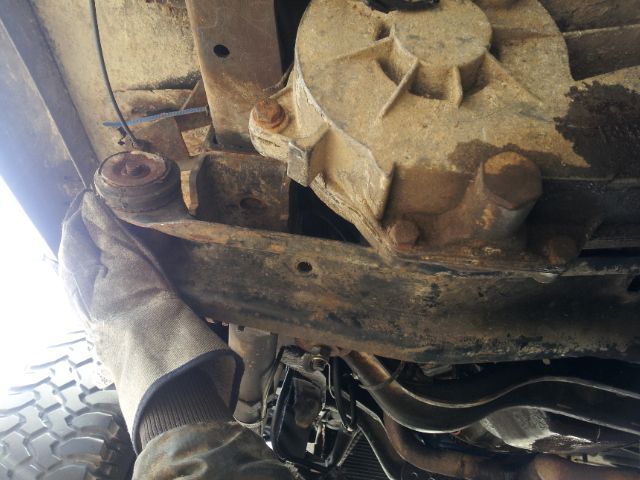

this is a current fullsize 208 install on my truck, prior to this i did mod the upper rail again because i had the case in a different position and it was on a ford trans and small block. if you look you can see that the metal has been removed and replaced before on the upper and lower rails, now i just roll the rail out of the way but since my frame has been modded so many times that was not a good way to go so i just trimmed and radiused it a bit. had i had this clocked to this position there would beno rail modifications needed at all..
i cock the powertrain from centerline obviously to facilitate this. but ground clearance is ideal and protecting the t case is easier this way.
this is what my engine looks like compared to a small block.
so theres always some give and take with placement. but the fact is a 208 case will fit in the rails.....with that behemoth engine. so its reasonable to think a small block can accommodate this as well.
attachment.php
Do remember that I also don't have a body lift so mine being down below the rail is going too happen plus it wasn't clocked to fit up between things. Having a body lift will make it easier to fit any transfercase between the rails.

What changed between say Danger's 208 and yours as far as hanging down goes? Is the Jeep 208 a better choice for that problem?
I am looking at going to an M5OD trans and a fullsize t-case swap behind my existing 302 swap. I am kinda worried about how t-case drop is going to work with my fairly stock suspension, mainly the radius arm crossmember. Most fullsize t-cases I have seen have a fair amount of drop. I don't want it hanging way down out of the bottom of the truck with the front driveshaft going uphill to the diff either.
The 205 sounds nice, but again the orientation of it is a concern. And building the support right by my fuel pump. I don't think the beef isn't really needed, my stock 1350 has been a happy camper for over 2 years now :D

use a clocking ring and a 3 in body lift to fit the fullsize t case in the easiest manner. like danger mentioned the lack of body lift forced his location.
i prefer a body lift on these small trucks.
Where can we get a clocking ring from? If I could get one then it would make my trans xmember/drive shaft clearance much better. I do plan on putting an inch or so body lift on mine to help give things a little more clearance so that when i do get to go wheeling, the frame can flex and everything not rub.
