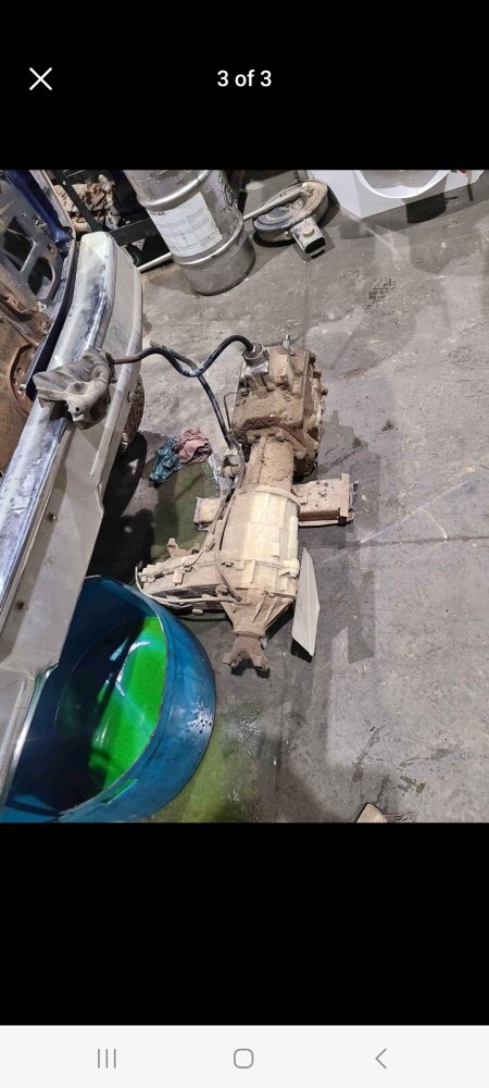

1988 Ford Ranger XLT super cab engine, trans, and transfer case swap - opinions on ford 300 inline 6, t18 and np208

Came out of 84 f150 146k miles used as a farm truck. Fluids good, oil coolant

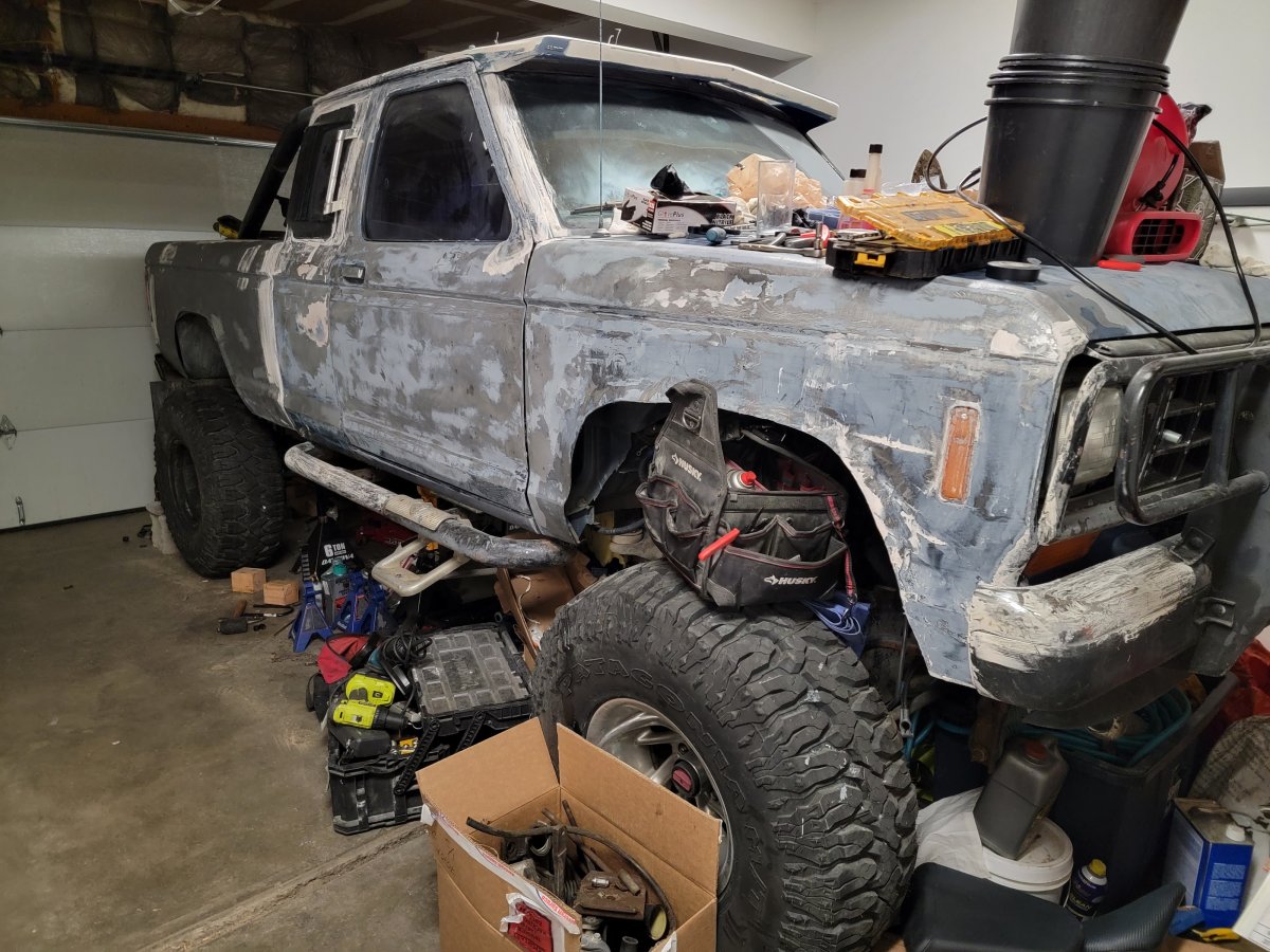

Need help determining if it would be a good swap into my ranger. My ranger is 4x4 35 inch tires and swapping an 8.8 Ford explorer rear axle right now in.
A 300 I6 has been swapped in at least once before, someone posted pics. But that's all I know about it. Everything I've read has said it's really hard to do, mainly because of how long the engine is. You will have to do some measuring and see if you think you can make it fit.

Saw a thread mostly recommended the ford 302, 351w or a explorer 5.0
Which one is the easiest and will get me up and running quicker for less?
With a solid axle swap it will fit fine. You can build a k member that is ideal.
With a ttb k member you will have to work a bit. If it runs good.... it will b great
The Explorer 5.0 is by far the easiest swap option for a V8. The 351 can be made to fit, but it has issues with the heads and the heater box wanting to occupy the same space, and the left exhaust and the steering shaft wanting to occupy the same space, so it takes some creativity. I believe that the guys who have done the 351 have done body lifts to help with those issues.
IIRC it mostly needs the radiator pushed as far forward as possible.
You got the 300 already, and it would fit well with the rest of the truck. Everyone does a 302, dare to be different
