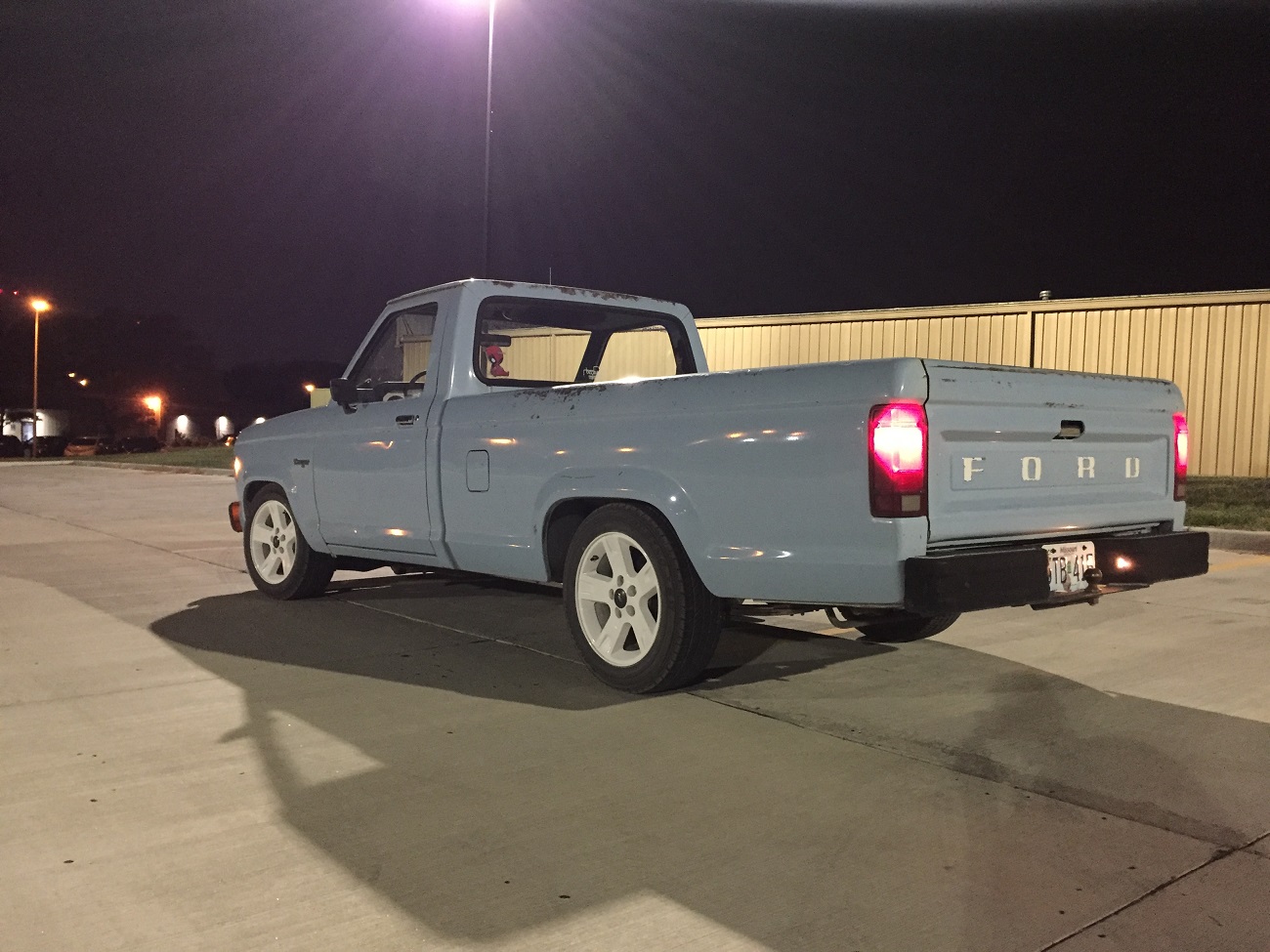

Toxic drop shocks installed on all 4 corners
it rides like new
drove it to Chicago and back....twice
1400 miles
even got a few thumbs up on the highway :headbang:

Glad to hear it's getting closer to how you want. It's looking good, can definitely understand the thumbs up!
:icon_thumby:
Mostly wanted to chime in on the wheels. First time I've ever seen that treatment on them, or at least combined with a lowered truck. Makes them look completely different, like something that belongs on a Mustang. I like!
