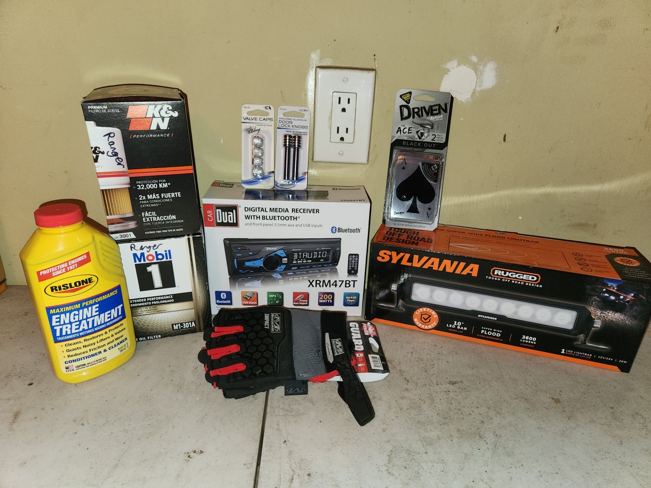

I got rislone. And some other stuff....
The Sylvania light was on sale. $49.99 for 3100 lumens and 2 year warranty. Plus the size is right...compact.
The radio head unit was also marked down to $43.99...it's gonna be nice to have tunes in the ranger again, instead of listening to loose change in the door pockets rattle.
They had a bunch of engine treatment stuff...some fancy multi bottled packaging too.....never noticed how many there are.
Fingerless gloves are my new thing. These have a good knuckle buster guard...$14.99 worth a try.
I got two oil filters for the ranger...noticed the k&n is taller than mobil1.
I got oil options but will probably run the motorcraft synthetic blend again.
The bling bling valve caps I have no comment.

At 220k I just turn the volume up on the radio. If it blows up I'll call AAA and find a 302.
Well hence I bought a radio along w/ the rislone.
