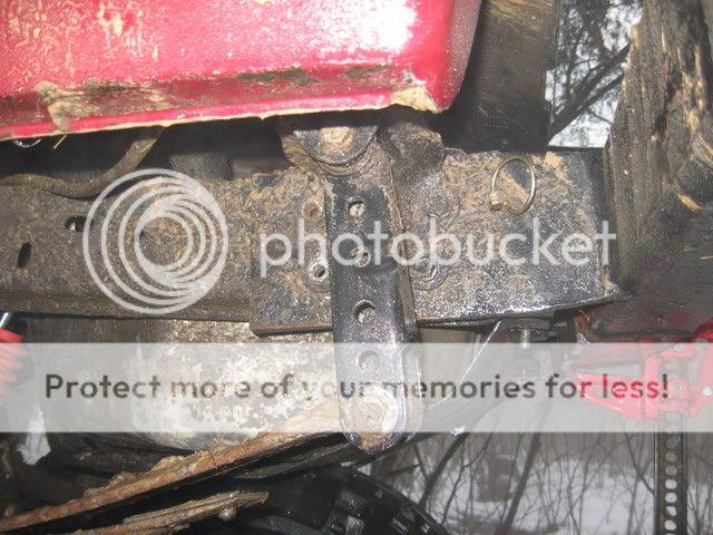

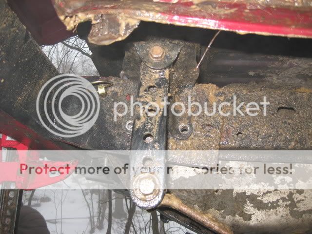

I sheared all but one bolt on each side of that shackle bracket on either side today. I used 3/8 grade 5 bolts, now they will be grade 8

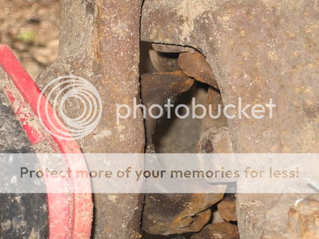

i also toasted another LF axleshaft, i really need to buy some chrome moly shafts and get weaker hubs. My hubs are the ones that are all metal and indestructable. I need to get the weaker hubs and several spares that way i can just change the hubs quicker and less costly then shafts and joints each time
when i tear it down, i'll be replacing the front welded spiders with an aussie locker. I think with the aussie and chrome molly shafts i should be able to make the front survive longer then one trip

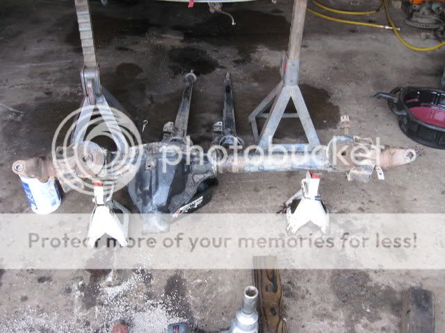

i got a bunch torn back down today, the front axle and suspension torn out from under neath it and the Front axle stripped to the bare housing. I got some pics but my comp is being gay tonite so i'll load them tomorrow.

heres my LF shaft from this past sunday
wheres the ujoint?
heres the work i got done today,
pretty much totally stripped the front axle down, still debating on shortening the Pass side to EB length or keeping full width. Opinions?
Leave it full width, much more stability.
