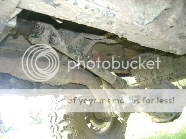

i'm at 31 inches, but i think with the height and angle my driveshaft is at that if i shorten it any it will bind, as it sits now i'm surprized it doesn't. I guess i'll have to lower it, i have been thinking of dropping it a little so i could loose the 4" block in the rear.
Pinion angle is maxed out (lines up with the driveshaft) and I do not want to turn it up anymore being i am already concerned with the pinion bearing and lube. And i am using a Frt explorer shaft with the double joint already.
I'll have to take a pic to show the angle.

heres a pic of my rear axle, what do you guys think?
I think it's stinkin' dirty.....sorry, I had to.

I think you will be fine. You may need to correct the pinion angle again.
Should look into a zero rate add a leaf for the back to stretch it out a bit.
x2. Put in the doubler, correct the pinion angle, and keep the double-cardan shaft.
