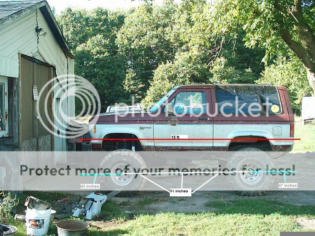

welli am tearing down the susp on the B2, and i am thinking of extending the wheelbase. I was thinking in the front. But i want to retain coils and i currently rn a D44 SAS on it. I was also thinking of extending the rear, but i am worried about the rear 1/4 interefernce with the tires. What is everyones ideas on coil relocation, and steering geometry. As well as what are some ideas in the rear retaining leaf springs.
some current measurements
a general shot of my current set-up
You should be able to move the front out without a problem. You can stick with coils just move the buckets forward as far as you want and cut the fender to match. You will probably have to go with an eb style steering box that mounts on the outside of the frame.
