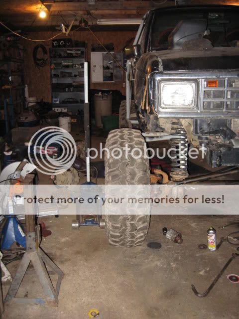

where the 60 is at right now

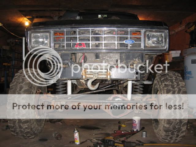

sits a little wide in order to clear

That baby is wide. What did you end up doing, spacers or new rims? You already mentioned it so I won't comment on the trac bar :D
the front rims have only 2.5" of back spacing
So you found some new rims? I remember you having trouble fitting the 4" bs rims.
I wouldn't call them new lol and i only found three. So for now the front is like 4 inches wider overall then the rear.
I have the rims/tires listed locally, trying to see if i can find a trade deal for a similar tire/soze but in a 16 or 17 as the width of the front now won't clear my fenders on my trailer.
