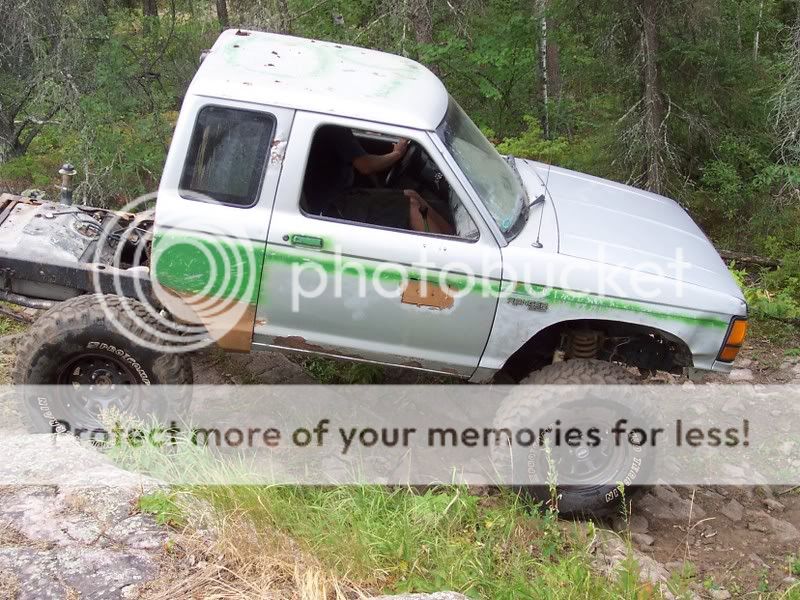

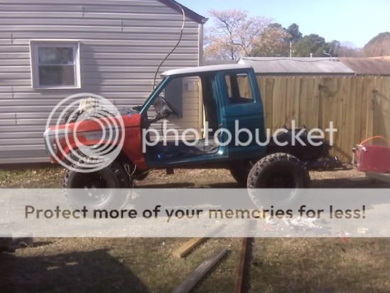

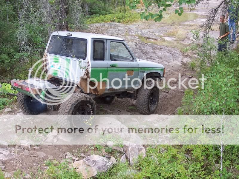

Buddies old stranger.
Another build going on on another board.
by chance does anybody know what their wheelbase is or if the rear axle has been stretched at all on either of those two builds?
Both have stock B2 wheel base. No way around it your going to have to put the mini tub in to clear the rear tires. The Silver/green/oxide/rust one was on 35's and the blue one will have 33's or 34's not sure.
