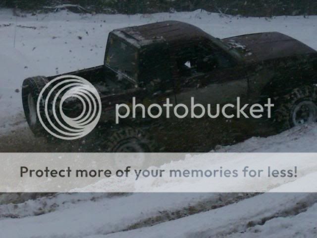

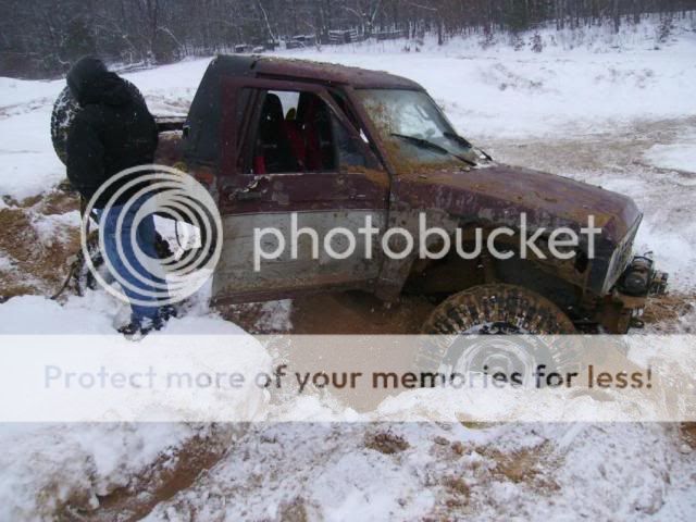

did a little winter sealing up, well i managed to somewhat install the rear hatch (or badly hacked it on there) so other then having half a drivers door and no window in my pass door, the cab is mostly sealed back up.

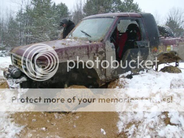

my carnage today

Lucky SOB with all your snow. We had a bit of freezing rain, but not barely more then a flake or two of the white stuff.....

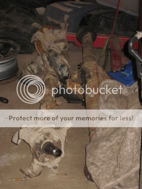

well picked up some wider axles tonite. Full width 44 and 9". Funny i started out with a full width 44 and now i am going back to one. My DD explorer is gonna receive my narrow 44 and 8.8 from the B2. Not really changing anything other then width though. Gonna stay 4.88's and the aussie and welded rear. But i do have some more changes to the truck coming soon though.

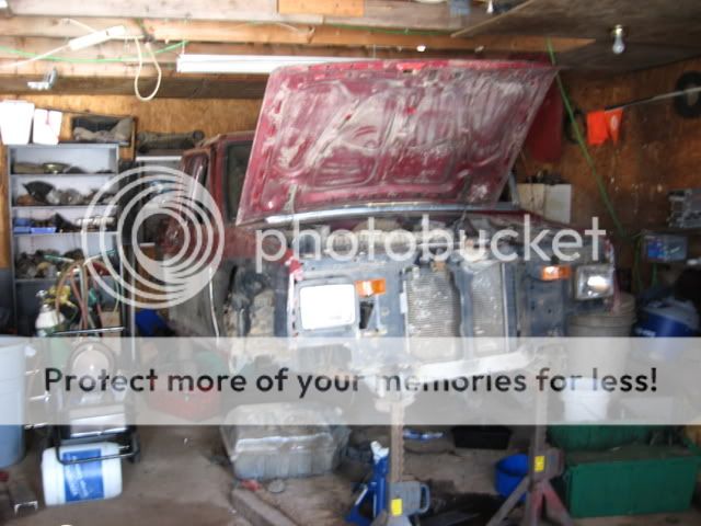

The B2 is finished.....as in no more. Body beaten beyond use, axles donated to my explorer family wheeler, Frame is bent/twisted.
Here it sits at this very moment awaiting final dissassembly.

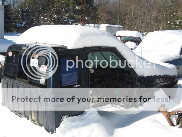

1st Gen Ranger Cab

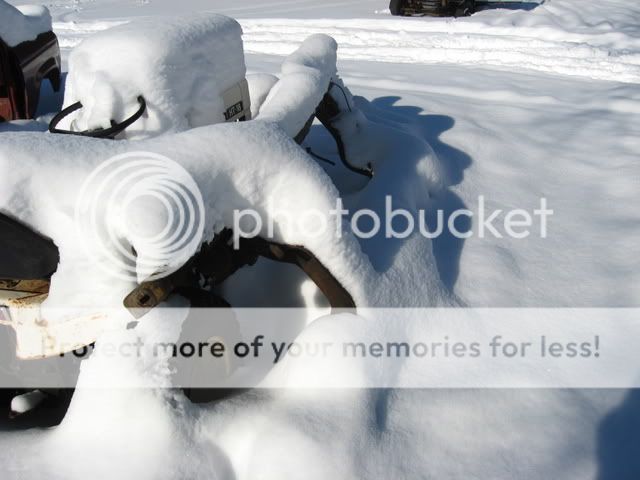

Bronco 2 Frame (not the same frame as my old b2 as that one is bent).

Full Width D44 and 9"

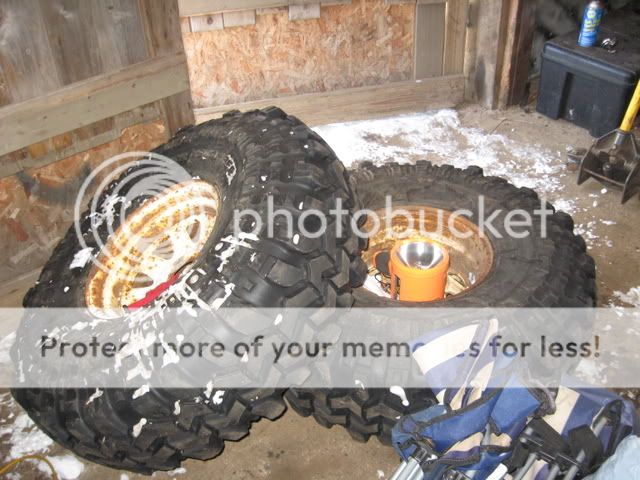

and my 38's

Min. Lift as possible to clear the 38's
