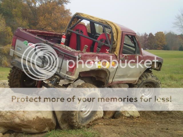

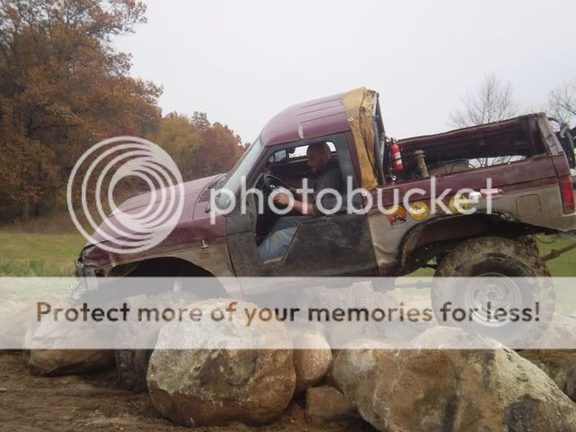

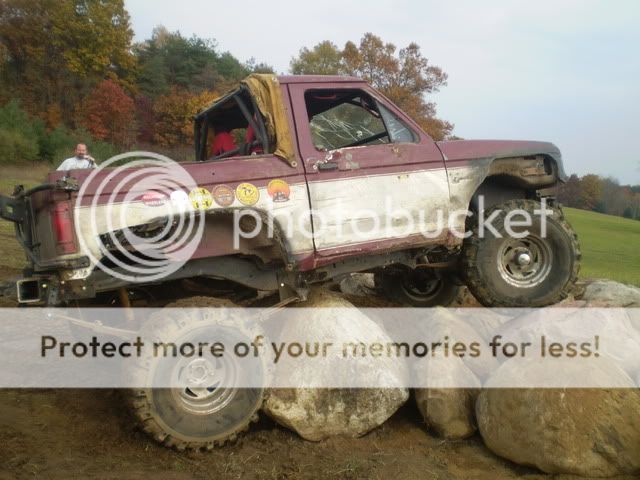

tried the doubler out yesterday, nothing like climbing obstacles in a stick and never having to give throttle assistance while doing so. Need to make some shifter adjustments and body adjustments, the doubler hits a certain spot on my floor and make an incredible irrating noise.
At Idle with no throttle assistance and in 1st Gear, it would have kept climbing till i flipped over had i not pushed the clutch in.
