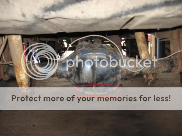

i actually had to take a hammer and chisel to the cover in this area to be able to get at the bolts. The cover was bent over the bolts from draggin across the rocks.

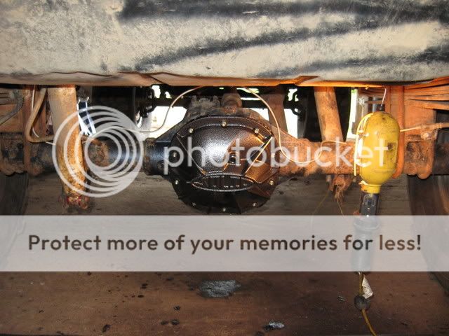

New cover installed

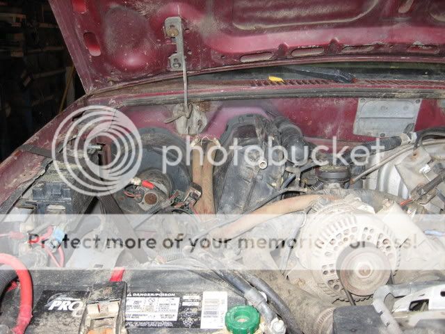

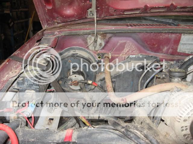

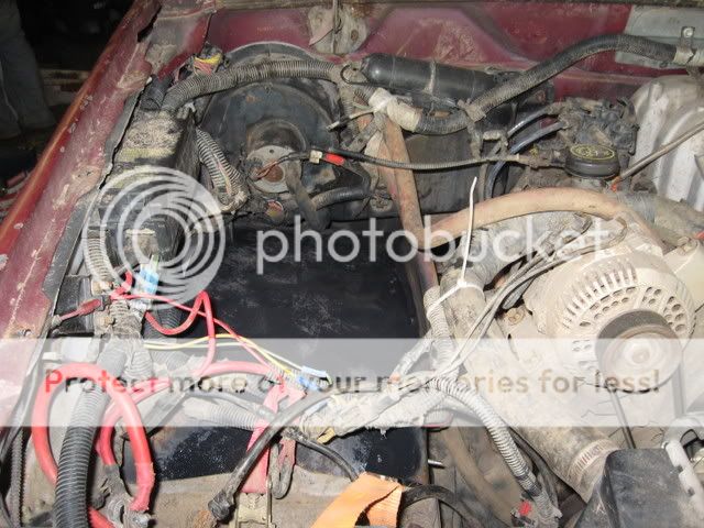

went and got a non-a/c heater box. On the RBV's of this style the only difference in the box's themselves is in the engine compartment. And they interchange completely. The firewall is the same with or without A/C.

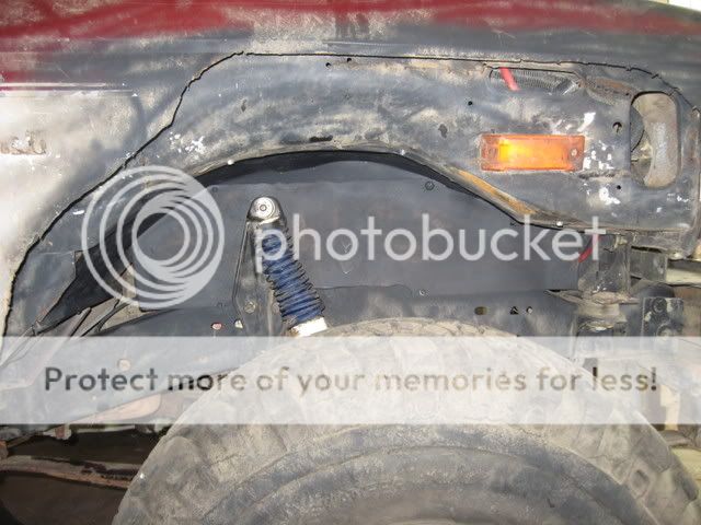

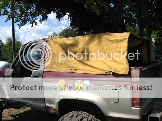

Changed my soft up a little bit, before it was open at the bottom on the sides, and it hung way over on the back. Now it hangs down just far enough on the sides and barely over hangs the back
been wheeling the last few trips with no inner fenders, been making a real mess of my engine compartment. Remedied that today.

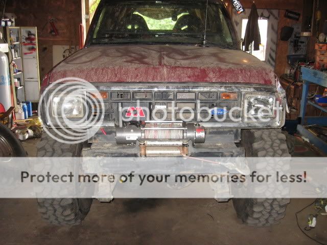

newest addtion to the truck, replaced my junk champion 8K winch
went and got a warn m8000
Not Another CTOR Build
he had it on ebay and the bids were up to $223 and it still had 5 days left. I noticed he was out of lansing, mi (50 miles from me). So i sent him a message stating i would come and get it today with cash for $275. He got back with me and said sure. So i went and got it. Seems to work fine. The cable that was on it was junk. But i have a pretty much new cable (the one in the pic). It seems to work fine i spooled the cable onto it and the winch never hesitated and never even felt warm to the touch. Atleast now i know i can get parts for it just about anywhere unlike my old champion.
just clicked, had it apart several times, now it works barely. after a few minutes of use it shuts off like it overheats and take about 30 minutes before it works again. And its really difficult to free spool cause the stupid lever pulls down and locks it back up. I'll probably try and get it in some form of a working order and mountit on my trailer.
mounted the solenoid pack, yeah its upside down but it'll have to do for now. Eventually i might relocate it to inside the cab of the truck. Its hard to tell in the pic but the box is mounted flush with the grill, so looking from the side you can't see it.
