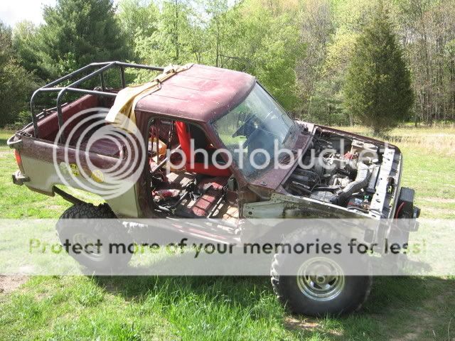

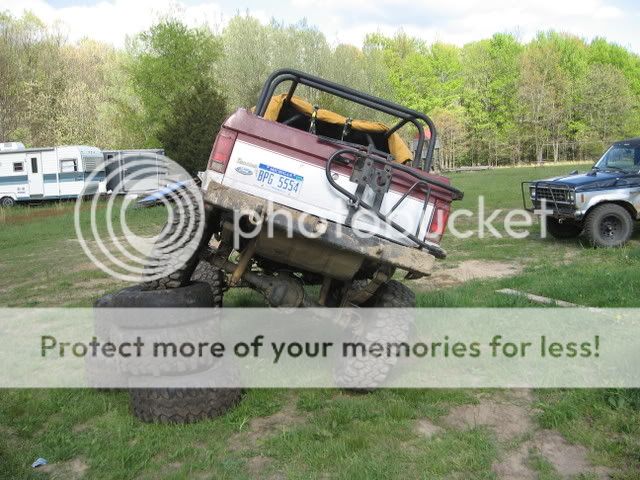

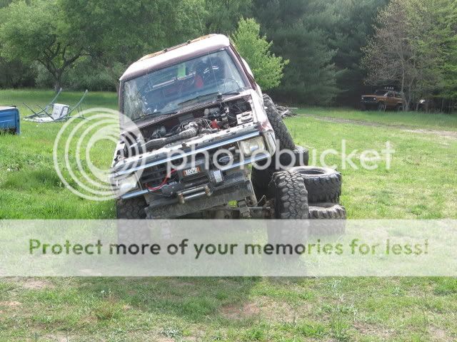

i have hit a creative road block on my fenders and qaurters
I finally got my trans crossmember built so i was able to get the truck mobile again. Needed to check flex to figure out what i could do about fenders and qaurters.
My LF shock is fully extended but i still had another 2 inches before the rear reached the point of putting tire into body (which it can). And the RF tire was into the inner fender support.
I was flying around the yard and the truck feels so much more stable being 3"s lower.
What about trimming the rear panels? I'm lost on what you could do with the front.
i hadn't rubbed in the rears yet...have to see how it actually does in the trails. I may jsut leave it.
Tube the whole front end and eliminate the sheet metal. RB

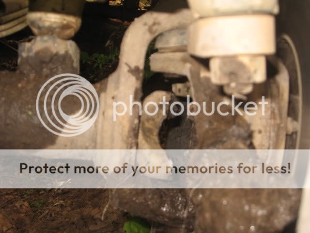

shattered the shaft (Yukon 4340), recovered the ujoint and the crosshafts were undamaged (5-760x). KSEJeeper found a ear with the cap still attached and the cap had the c-clip still on it. Call Tuesday for my warranty.
I hope to hell I don't have the problems you have when I get my truck done.....lmao! good luck with the warranty and let us know how it goes.
-andrew
Where did you get your shafts? Is it a one time replacement warenty? I need to get 2 set's of chromolys and am debating on what to get. I broke 4 shafts at the blessing this year so it is time! RB
