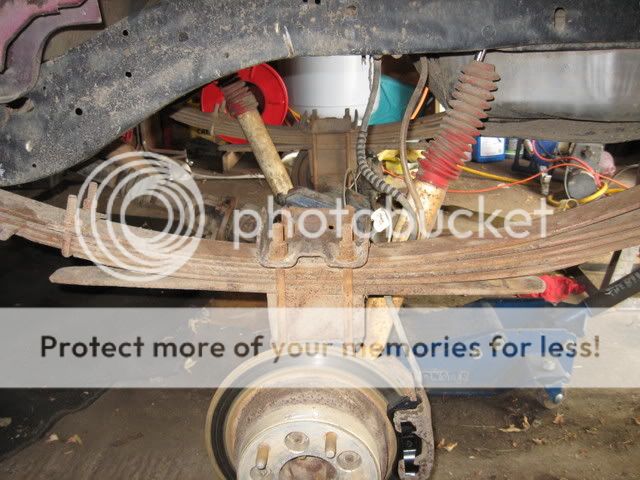

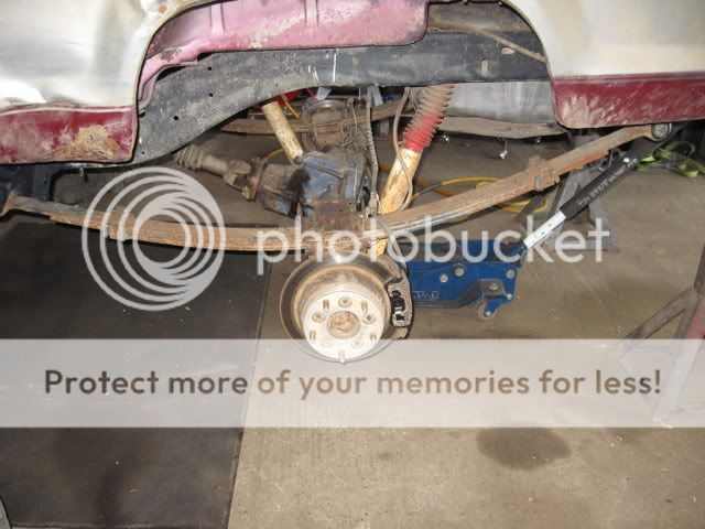

i took two of the leaves from the pack that was in the truck before and removed the overload from the 63" springs and added the other two to the 63's. That make any sense.

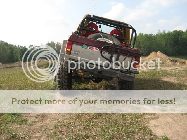

oh and those are new pads int he pic, just put them right before the shot. Gotta have the truck done and ready for next weekend. aking it up to Twisted Trails ORV park here in MI for jeep fest lol

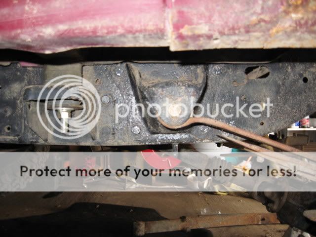

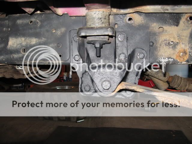

63's mounted but to tired to take pics, had to move the front leaf mount forward and drop it down to keep my lift height with no blocks. I added two of the old leaves to the chevy pack, but i think i may pull those out.
pics of the before after of the 63" chevy spring swap.......I retained the same lift height before/after
before
after
*the area of the front spring mount where i cut the bolt hole off is welded to the steel plate, you just can't see the weld in the picture. Whats not seen in the pic is the L Bracket on the back side of that steel plate that connects to the bottom of the frame rail and has peices of metal going from the bottom of the plate to the frame ral sideways as a cross brace/bridge.
*those are stock 89 rear 4wd chevy leafs from a 4x4 truck, the only modification to the springs is i cut the over load. The over load is still there its just no wider/longer then the spring perch.

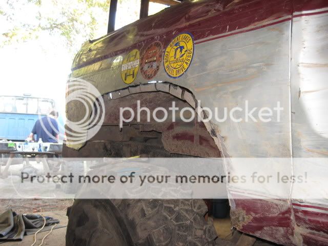

yeah the rear was never really a problem before, the tires flex into the tub but not the lip of the 1/4. But now with the chevy springs, the tires touch the lip so trimming is in order
Well the rear is a problem now, they flex much better and now get into the rear and started carving up my TSL's

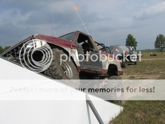

Trip went well, carnage at the moment
1st Day
broke the grille off the truck in the first couple hours
Lots more body damage

started clearancing for the rear tires......tht trip to TT really tore up my RR tire when it got stuffed. Really ripped up the oter lugs of the TSL's. But i have retty much taken care of that problem now. Now i just need to finish it up and it'll just about be ready for another trip back out to TT this coming weekend.
