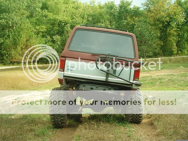

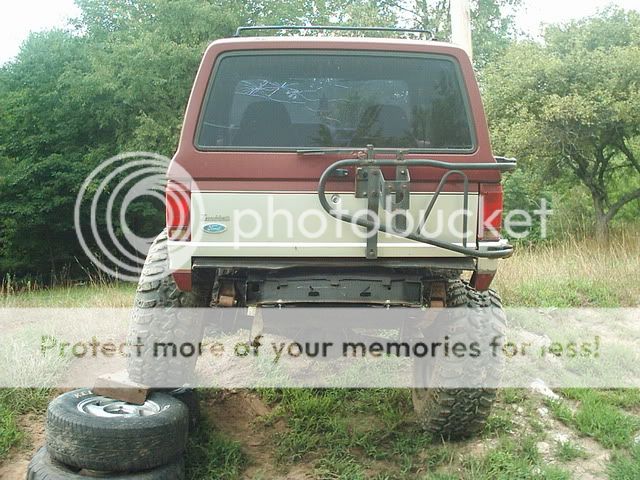

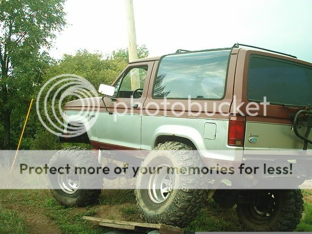

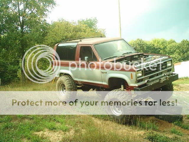

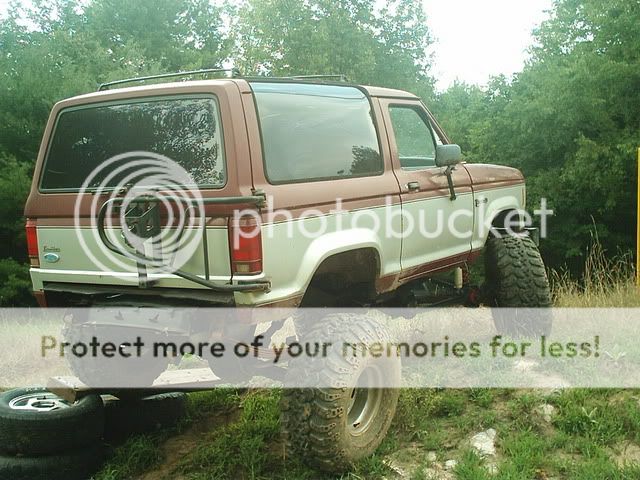

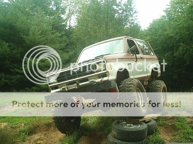

What size tires are those, and do you have a close up pic of the track bar mount? Looks real good, I have a '77 44 waiting to go in my bronco soon.
man that thing is sweet. Great job. I love FW B dueces.
Is that the new, "extra-crystal-clear" Clear Gearz diff cover? lol :D
yeah that would be lack of gears lol...........
tires are 15x10 with 36x13.50 iroks
the trac bar mount isn't done yet still working on it
I def need softer coils
nice rear flex butare the frount the TTB coils ?
Thats beautiful man. I agreed with the name popeye if you havent got one yet. That last pictures just defines the one-eyed muscle man.
