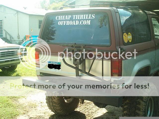

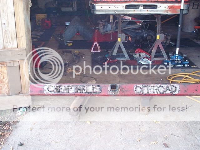

heres a pic of the bumper i am putting together for the rear
yes that is weld
okay, got my last shock mounted, and the rear bumper done, also put my plate on it and changed the spark plugs

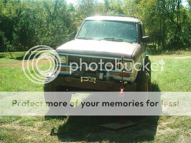

really all that is left is a radiator (its leaking between the tank and the cores) and finish supporting the front bumper

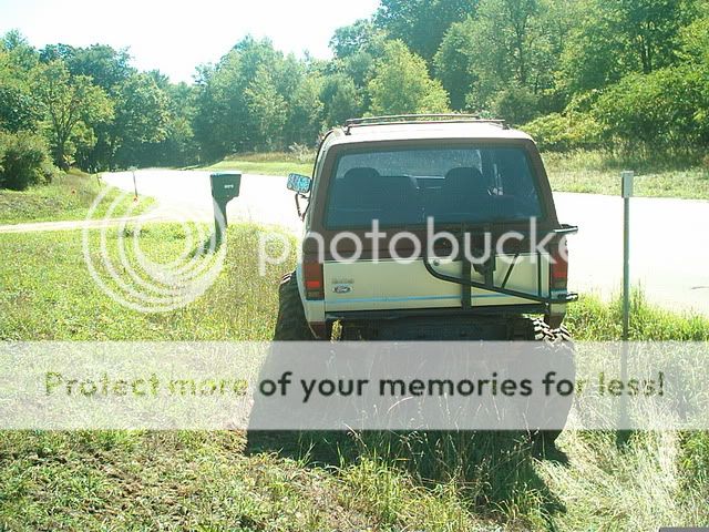

heres the rear bumper mounted (it looks really wide, but my tires are still wider then the bumper)

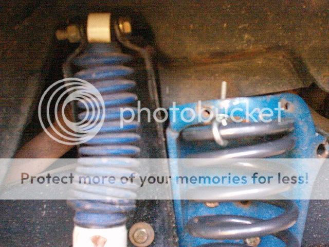

amd i had my first mishap...........
i popped the coil out (LF) when i lifted the front tires off the ground, the eyelet i put on to retian the bucket bent outward and released the coil (i replaced it with another eyelet and welded it closed so it cannot pull apart again)
