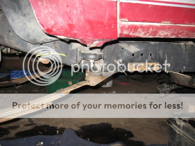

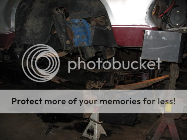

well i got two of the leaf brackets welded up and mocked onto the frame and one spring in position. I hope tomorrow to get the other spring mocked up so i can get the axle housing in place and weld my perches on. I am waiting on my hi-steer arms and to buy ball joints and u-bolts before i can really get the front axle set in place. Still haven't bought a locker. Hoping to find a used one so i can save a few bucks but looks like i will be buying a new aussie.
got the other leaf mocked into place and the axle under the leaves and the perches tacked into place. Tomorrow i hope to buy the u-bolts. Nothing will happen Fri. though, Fri is the evening i spend all nite with just me and my son. But saturday is my day off and i plan to be out there all day and taking pics and getting ALOT done.
everything is n the early mock-up and nothing is set-up and secured yet. Everything is put together just enough right now to get dimensions and mock-up complete. After i get everything "mocked up" i will be tearing it back down and securig everything properly.

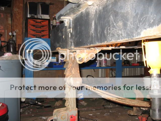

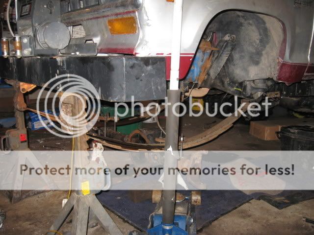

Looks like the front of my F350. Hopefully it rides nicer than mine. RB
actually i think i may have to add another leaf, i was jacking up on the axle and it compressed quite a bit before it lifted off the jackstands. But thats the beauty of the leafs. I can add and take away real easy. Unlike buying a different pair of coils to find the right ones. Also ride is not a concern. With 36" TSLs and 8" of lift with lockers front and rear, a qaulity ride doesn't work out.
I have been saying for years that I'm going to either coil the front or reverse shackle it. She only has two leafs but they are flat and like 5/8" thick and they don't move. Yours look much more compliant. RB
yeah leaf sprung TTB = horrible ride and no flex
