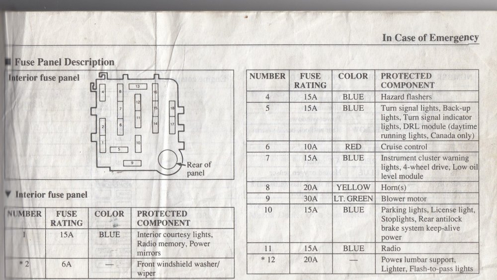

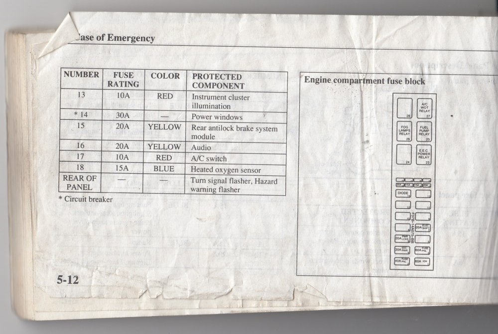

According to my Owner's Manual there is only one flasher for both and I did replace it. The 4-ways work without any flasher at all. I'll look under the dash again for anything that resembles another flasher unit. Also, I've got a lot of fuses , so I'll replace some old ones with new and see if it helps. Thanks for your input. It gives me somewhere to start.
So you know there must be TWO flashers then :)
But the one you pulled out is the one for the turn signals or 4-ways wouldn't still work
With 4-ways on you should be able to hear the clicks and then reach under dash to "feel" the 4-way flasher working and where it is
Fuse #5
If you have a volt meter or test light check that one terminal in that fuse plugin has 12volts with key on
Fuses 5, 9, and 17 all get 12volts from ignition switch on the same wire, #9(30amp) is for Blower/heater fan, so if it works then ignition switch wire to fuse panel is OK
