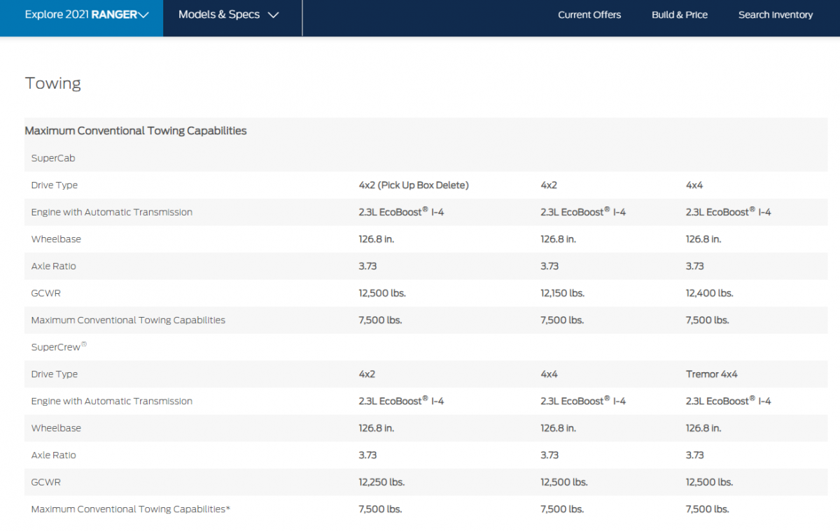

Here's 2021 from the Ford web site. If your CGVWR is a little over 12,000 pounds then slap a hitch on it, bob's yer uncle.
54141
And 2020 appears to be exactly the same, per this Ford dealer:
7,500 no matter how you slice it. Dang, that's a lot for a 4 banger.....

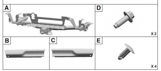

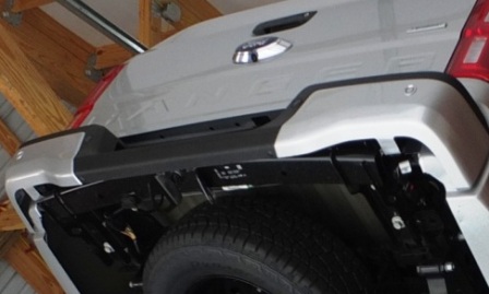

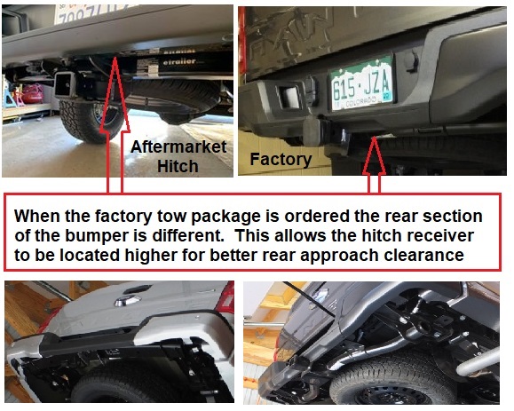

I have a 2019 Ranger with the Trailer Tow Package.
The package includes:
  • 4-pin/7-pin Wiring Harness
  • Class IV Trailer Hitch Receiver
  • a modified rear bumper center section that tucks the hitch up tight to the truck
No transmission cooler, no differential gear change, no break controller.
But the bumper modifications are pretty extensive. So the factory set-up looks so much nicer, FWIW. Aftermarket looks like a ruptured duck.

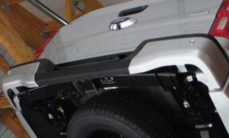

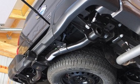

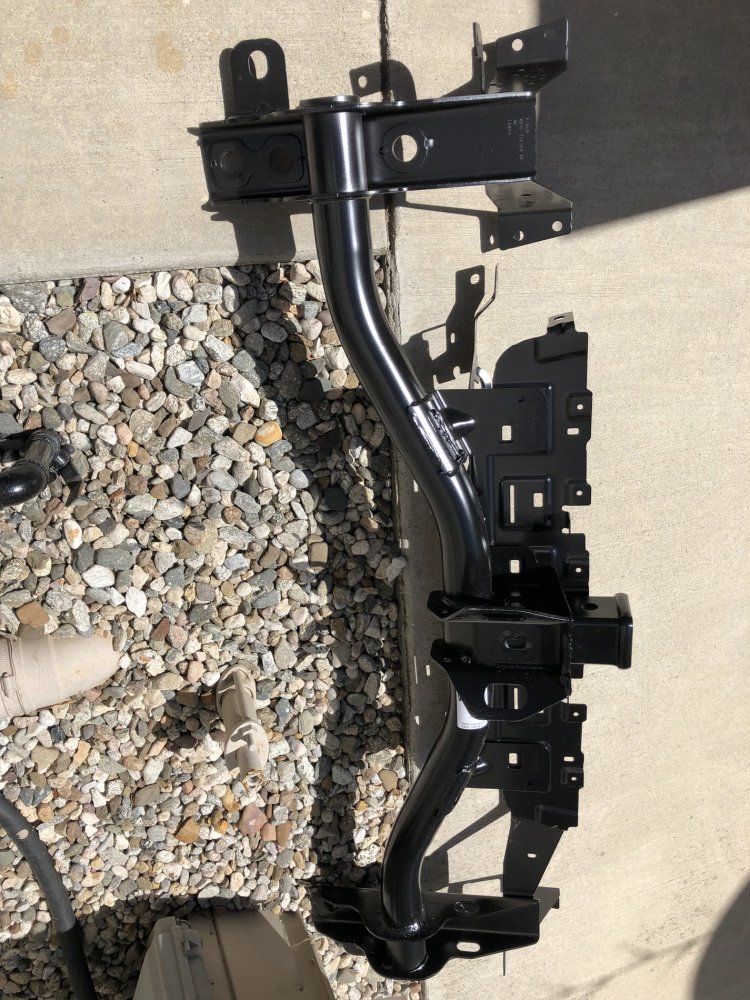

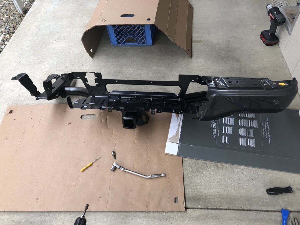

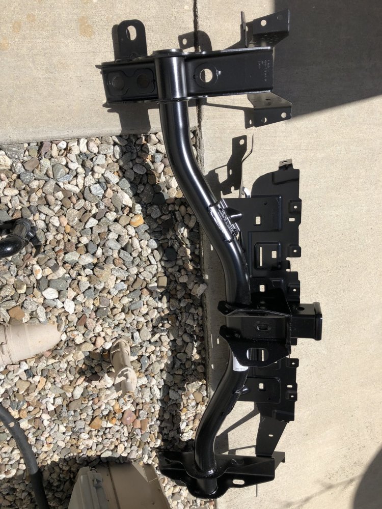

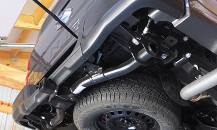

Also worth noting: The stock step bumper ball mount is supported by a structural tube sub-ass'y that is hidden behind the bumper. I was impressed by how beefy it is. I've posted some photo's below.

Factory Hitch as viewed from under the truck

Factory Step Bumper Ball Mount Support Sub Assy, as viewed from under the truck
View attachment 54253View attachment 54254View attachment 54255View attachment 54256
____________________________________________________________
________________________________________________________________________
Interesting, that Step Bumper support looks like the main part to a trailer hitch. Thanks for the pictures.

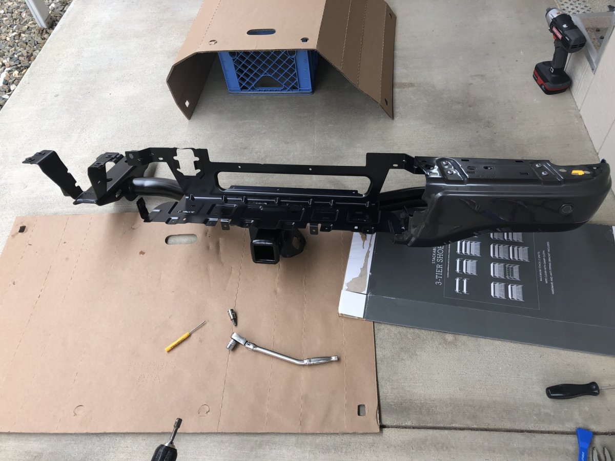

The bumper shares the mount with the hitch, they are not really connected. The bumper is atached to the hitch by the four bolts on the right side is all. The left outer bumper shell is removed and you can see the four holes with clip nuts in the left frame bracket. The right side with the bumper shell still has those four bolts installed.
The non-tow package bumper brackets just don't have the drop down for the hitch.
