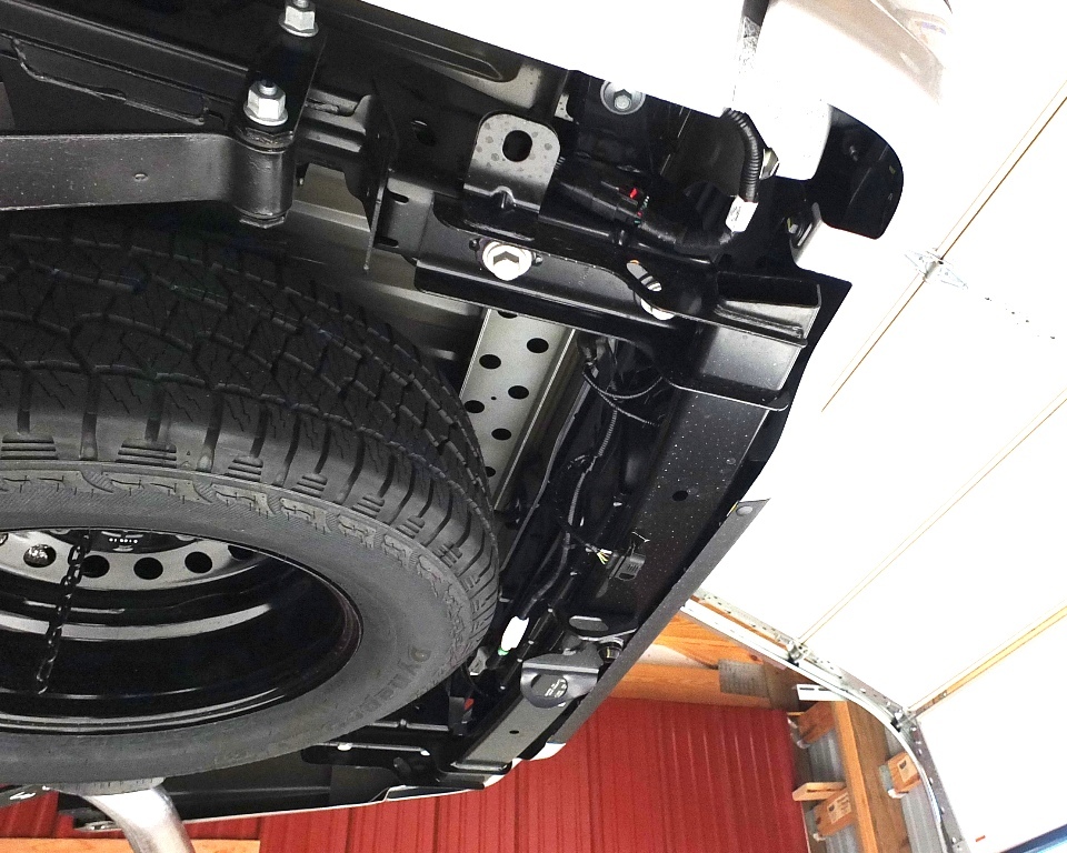

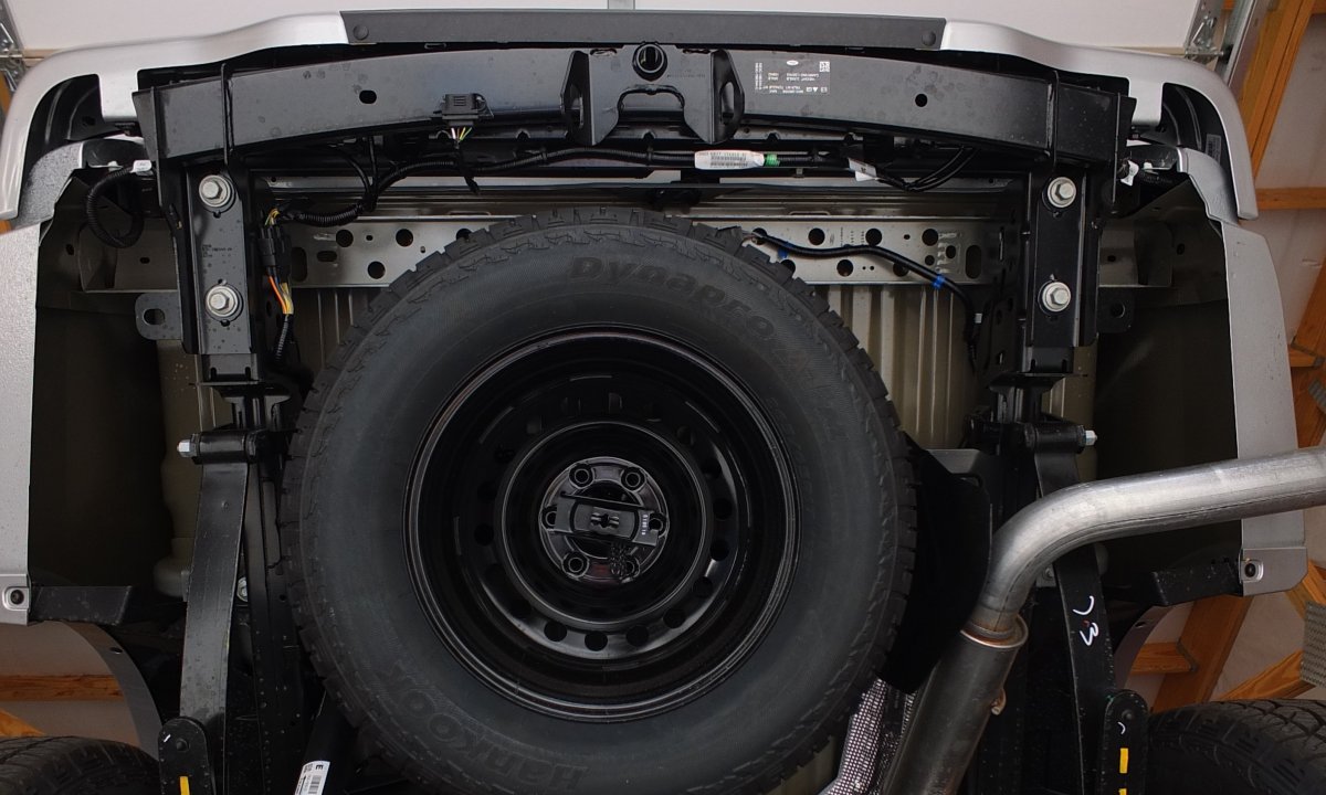

The non-tow package bumper brackets just don't have the drop down for the hitch.
The non-tow package crossmember is made from rectangular tubing.

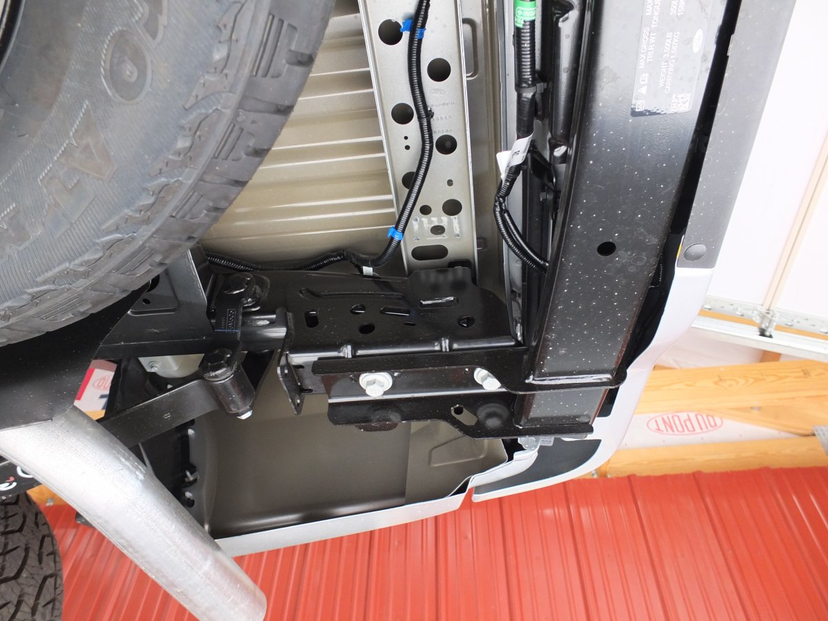

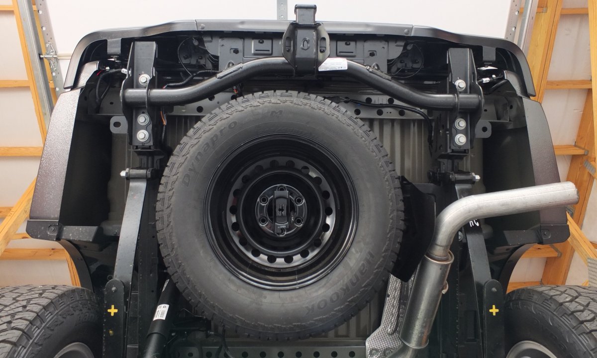

The tow package hitch crossmember which is made from round tubing.
Totally different design.
Here are some hi-res photo's.
_____________________________________________________________________________________________________
Step Bumper Ball Mount Hitch
Note the light gauge brackets that attach the rectangular tubing to the frame and that there are 4 bolts that attach the hitch to the frame.

Tow Package Hitch Assembly
Note the heavier gauge plate that is used to attach the hitch to the frame and there are 6 bolts that attach the hitch to the frame.
