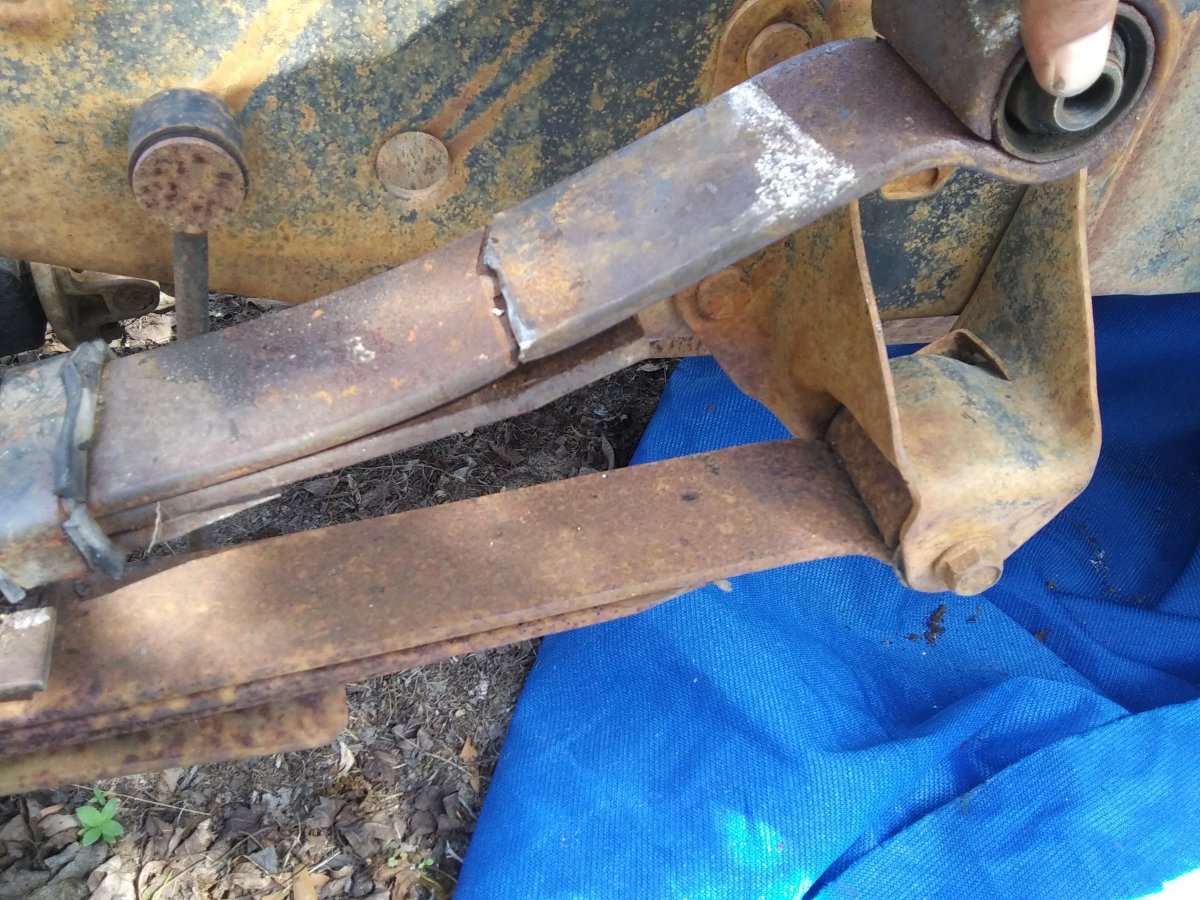

Removed the bumpers. Front was ruined from the transport but the rear is good. Also removed the leaf springs and brackets. The expo leafs mount in line with the frame ( or under it ) while the Ranger leafs mount to the outside of the frame. Unfortanately, the PS main leaf was broke when i got it.
40627
The expo leafs seem to be thicker but both vehicles have a 4 leaf pack. The rear sway bar was already gone, but I did get the links and compared them to my Rangers. They're a little thicker and seem to be bent the opposite way.

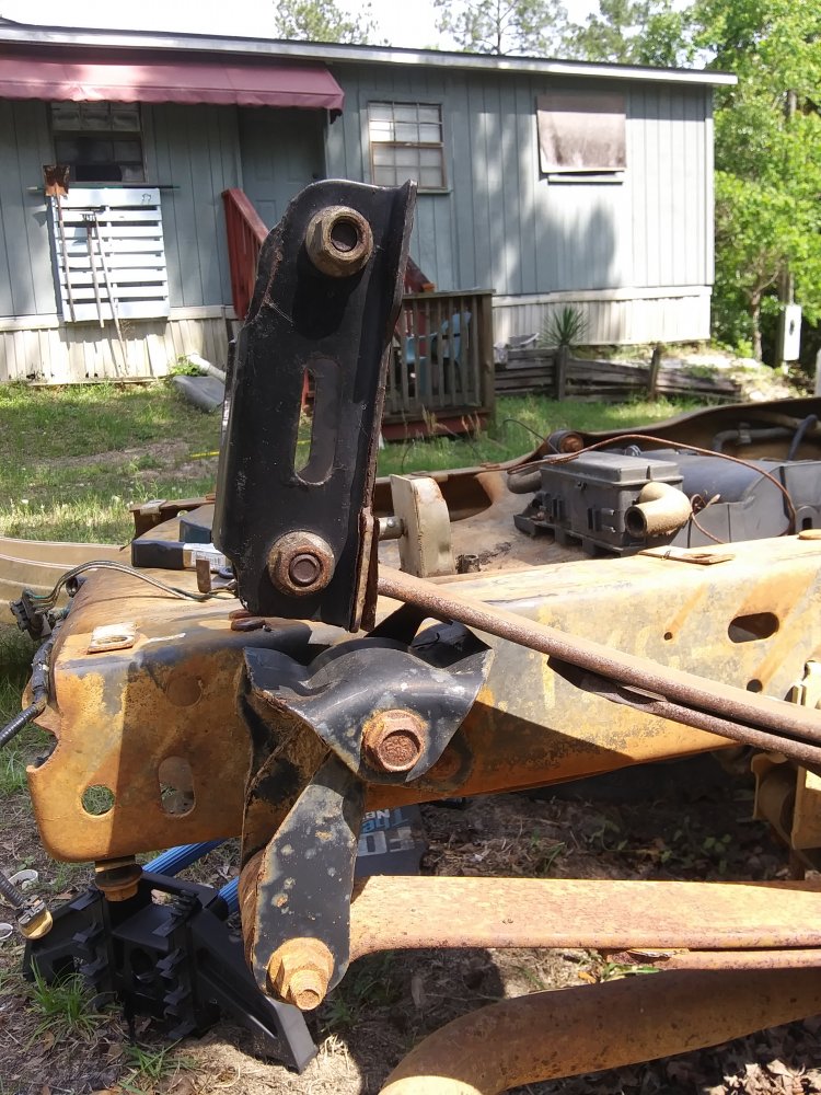

Here is a shot of both rear shackles.
40628
It's interesting to see the little changes between the models. My Ranger is '01 & the Expo is '00. The Expo is way more complex underneath.
