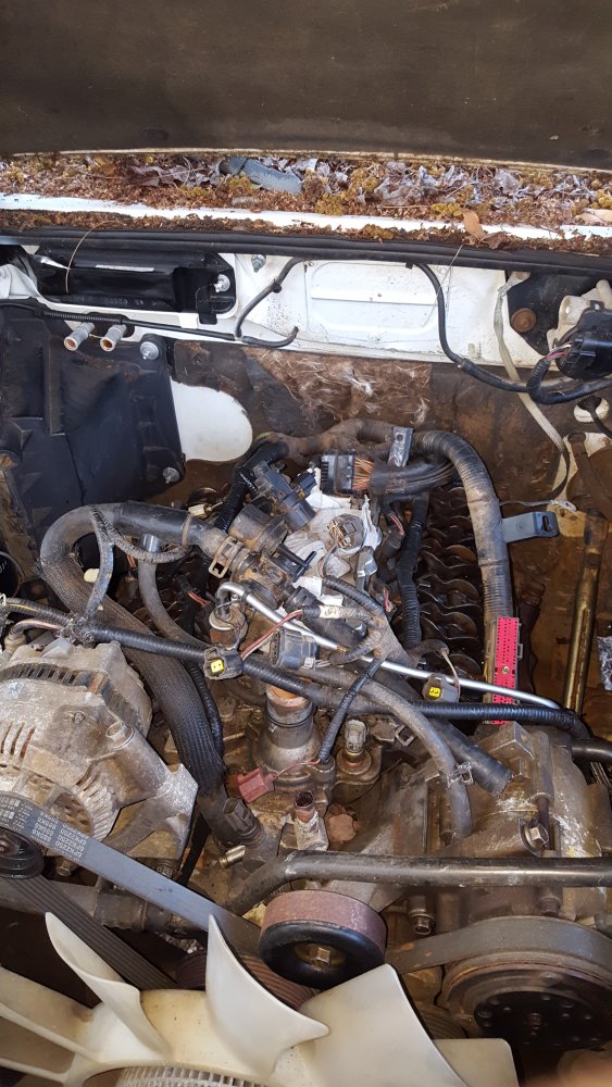

Started pulling out 3.0 stuff from the engine bay. Intake manifold is off, valve covers off. Exhaust is free on driver's side. Broken stud on pass. side, so I'm going to leave that manifold on and take it apart at the down pipe. Got all the wires i could find disconnected from the engine and trans. Got the radiator and fan shroud out. Removed the airbox. That's all i can think of right now, but i snapped a few pics when i was all done.
Intake off and wires piled on top.

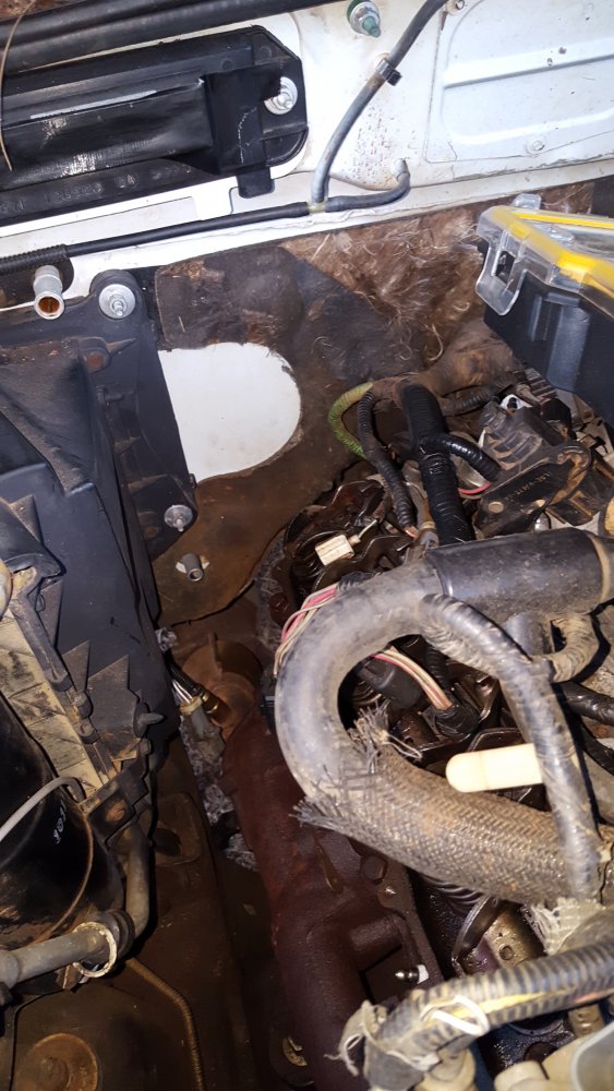

Passenger side, i put tape over the ecu/pcm (?) portal to keep it clean in there.

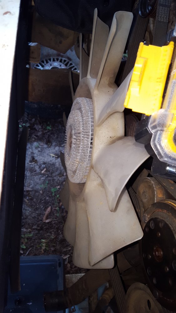

No radiator. I was suprised at how skinny it is.

Well, pretty sure the motor is locked up. I tried to turn it over with a socket on the large bottom nut. NO DICE ?. So my plan is to het as much as i can from the Expo, and keep moving forward until i can source a motor. I will still pull the awd trans and all everything associated, the engine harness and other tidbits will keep me busy for a while. I see 302s and 5.0s for sale all over fbmarket and letgo, so bo worries.
