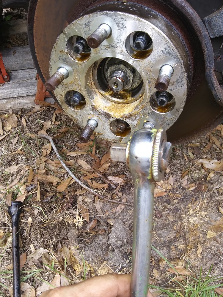

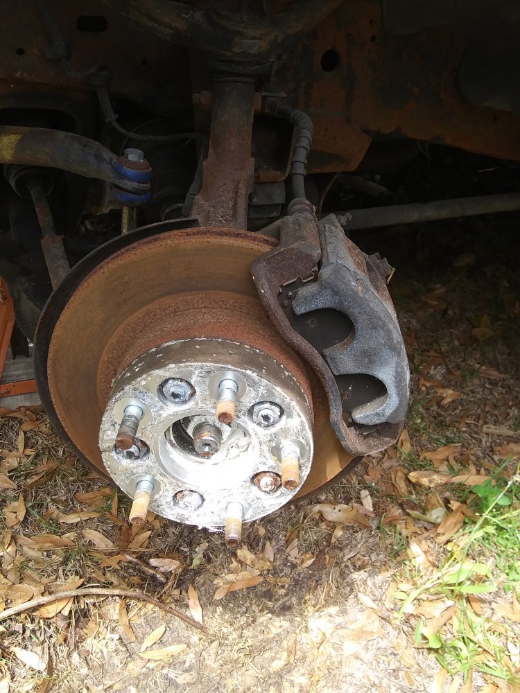

Broke the gears in my big ratchet. When i replace it, I'm also going to get a breaker bar or whatever it's called. You can see that I have 5 more lugnuts to go because of a wheel adapter/spacer.

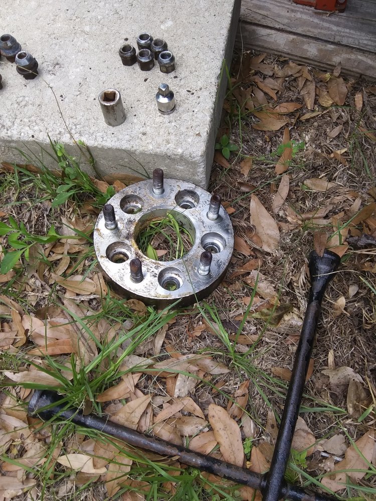

Luckily it's locked up and not stripped out. I was able to lock the hub in place with a strategically placed pipe and got all the lugnuts broke lose. Tap tap here. Tap tap there and it's off.
