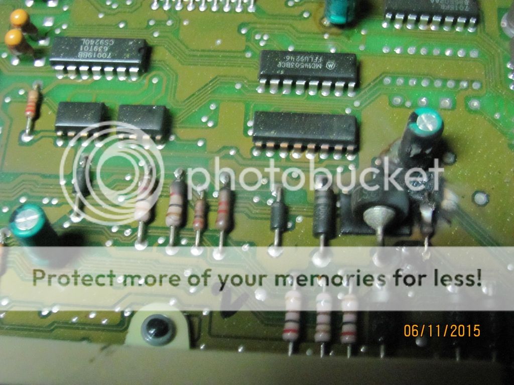

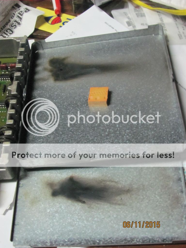

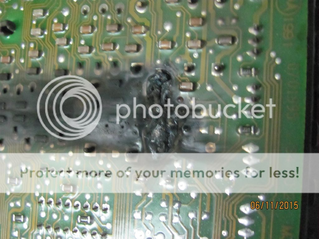

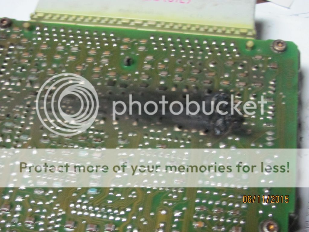

I went ahead and just pulled the computer just to check things out after reading so many other posts from other people with the same problem. What I found is not good. It looks like there was a small fire on the inside, and I mean an actual fire. It's burnt pretty good.
I took some pictures but can't figure out how to post them on here. So you'll have to take my word on it. I was thinking my problem may have been the capacitors like I saw in other posts from people. But I wasn't expecting that much damage. And it looks like the fire started at one of those capacitors. So I guess a new computer is in my future. Any thoughts or links as to a good company with reasonable prices would be appreciated.
The black is from leaking capacitors, yes it does look like a fire was there but probably just heat from power supplies.

Thanks for the info. But it was a fire. Scorch marks on both side of metal cover and hole burned in circuit board. And because of the way the ECM sits in the truck, other parts on the board were burnt too.
I did try to by-pass the relay by running power straight to the inertia switch and still couldn't get it to run. You are going to have to trust me on this, the circuit board it toast.
