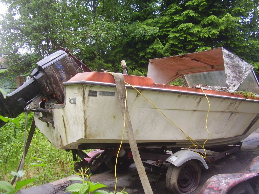

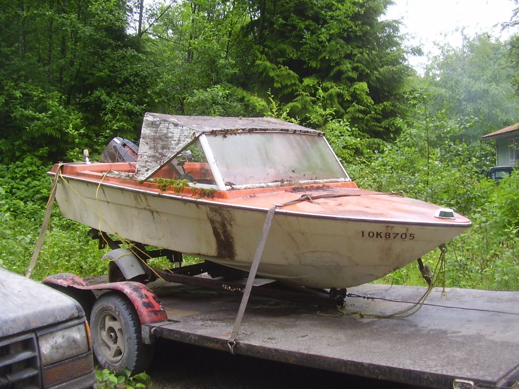

i was given this some years ago,and at free,i wasn't sure if i'd gotten the better side of the deal.
well,i love a challenge.it was to be my first boat.

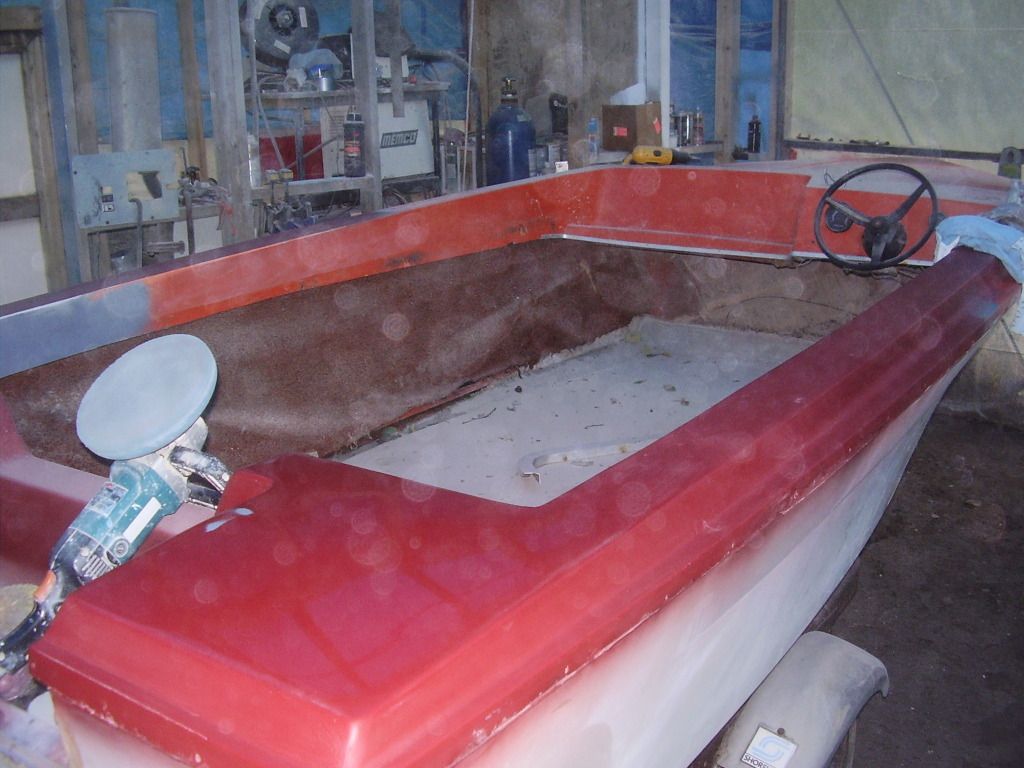

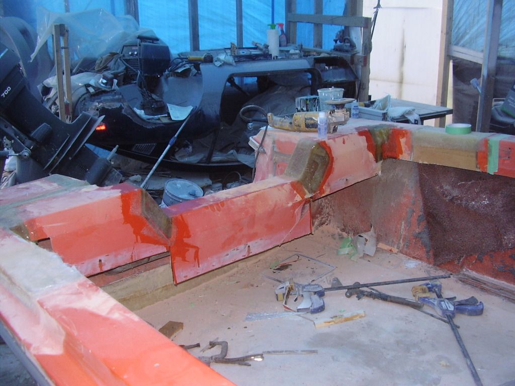

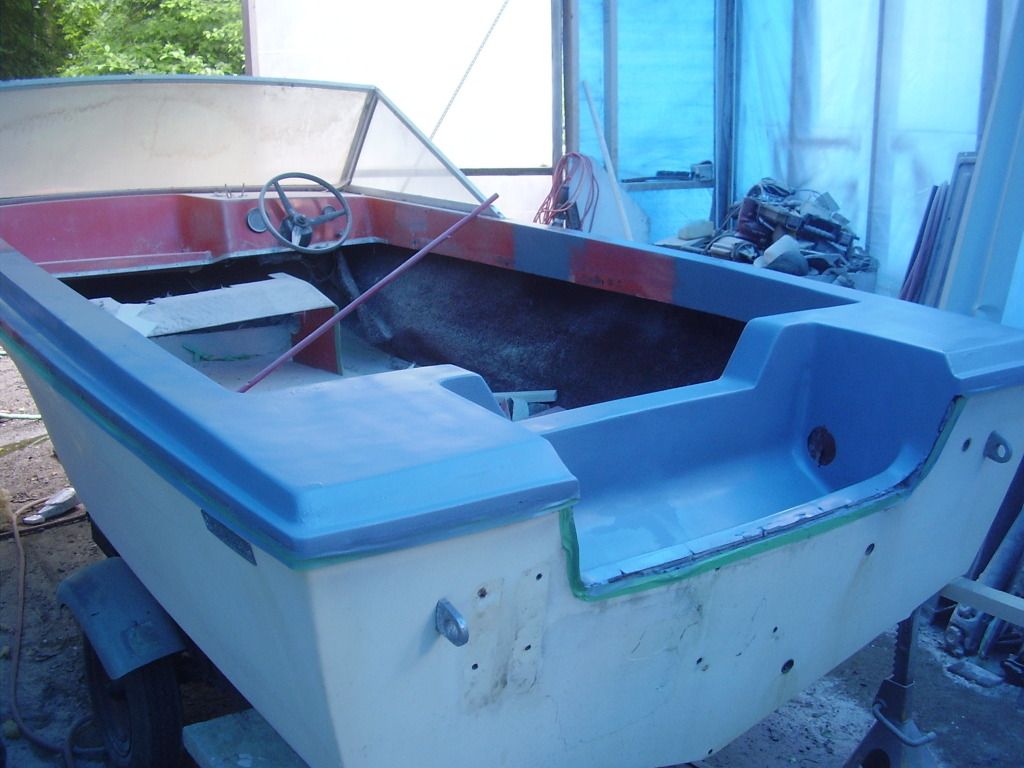

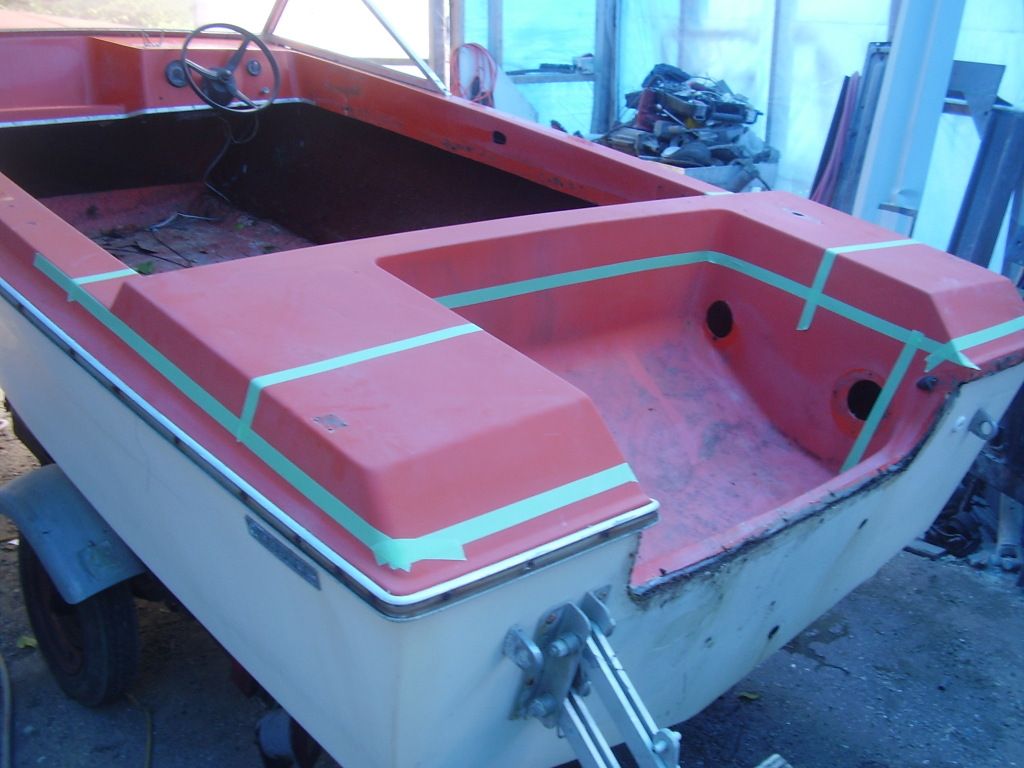

while it cleaned up ok,i didn't like the huge engine well and kick-up at the back,so it got some surgery lovin.
after rearranging some bits,the back was a bit more streamlined.now,about that orange color:dunno:
played around a bit and came up with a red i liked.that,with white on the hull made for a good combination.

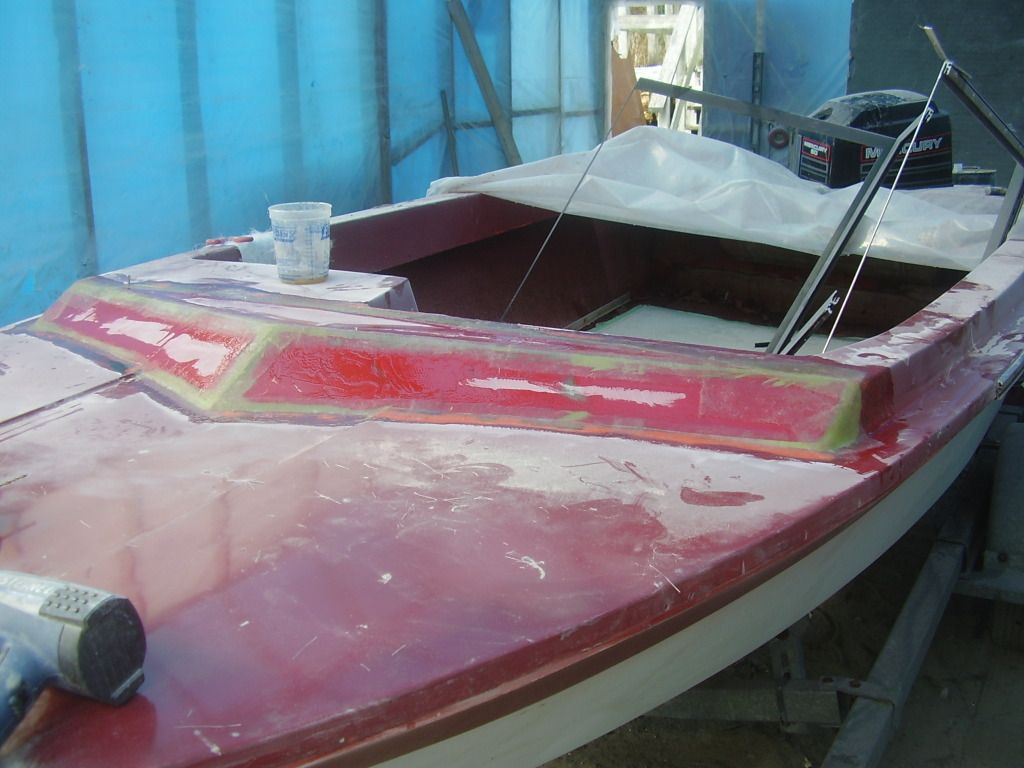

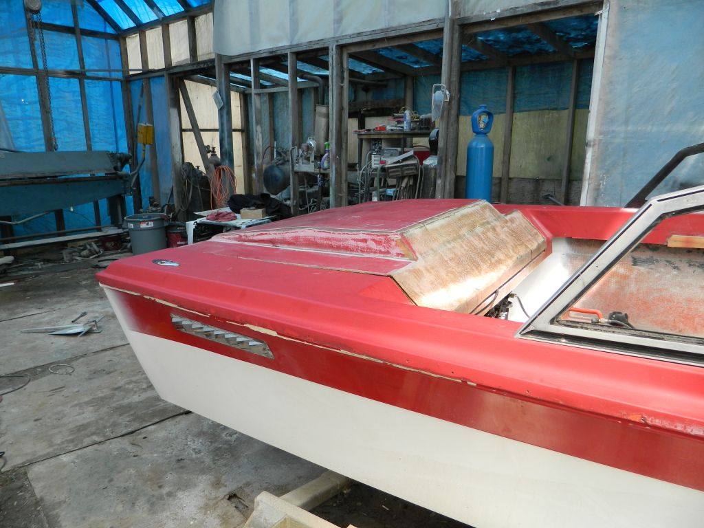

i wasn't really excited about the original windshield,so when a guy offered me the old windshield from his bayliner after i'd made a new fiberglass hardtop for it,i thought i just may be able to make it work.
to make it fit i had to remove the center bar,increase the angle at the middle,and reshape the side panels.but,there it is.now i need to do more fiberglass work to blend it in.
some fabbin.....
and some gellin'
and the old girl's looking pretty good.

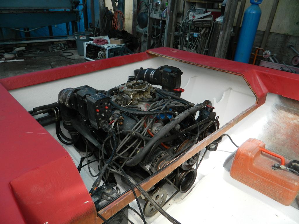

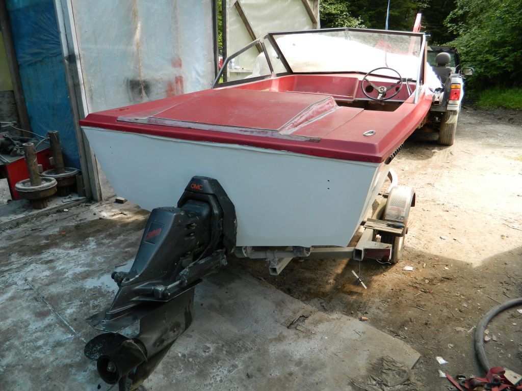

so,after spending all that time reshaping the back of the boat,i cut it all out and threw it away.made it look like this instead:
why?well,i bought a cobra.
yup....an omc cobra.
i got a decent deal on the drivetrain from a guy's 27' boat as he wanted something else.you know the story.....now i've got this big engine,and i've got this little boat.the rest is history.
the engine that came with the setup was no raving monster,but it was a 351w,and i was most interested in all the marine goodies that bolt up to it.i have plenty of 351s,and put together a '96 roller block with gt40 heads and a performer rpm intake with a carter 650 carb.
should be able to push a 15' runabout ok.
short of a little plumbing on the cooling system it's ready to go,it's turn-key and all the controls are hooked up.i have some work to do on the floors and cosmetics to finish yet,but it should get it's maiden voyage some time next week.

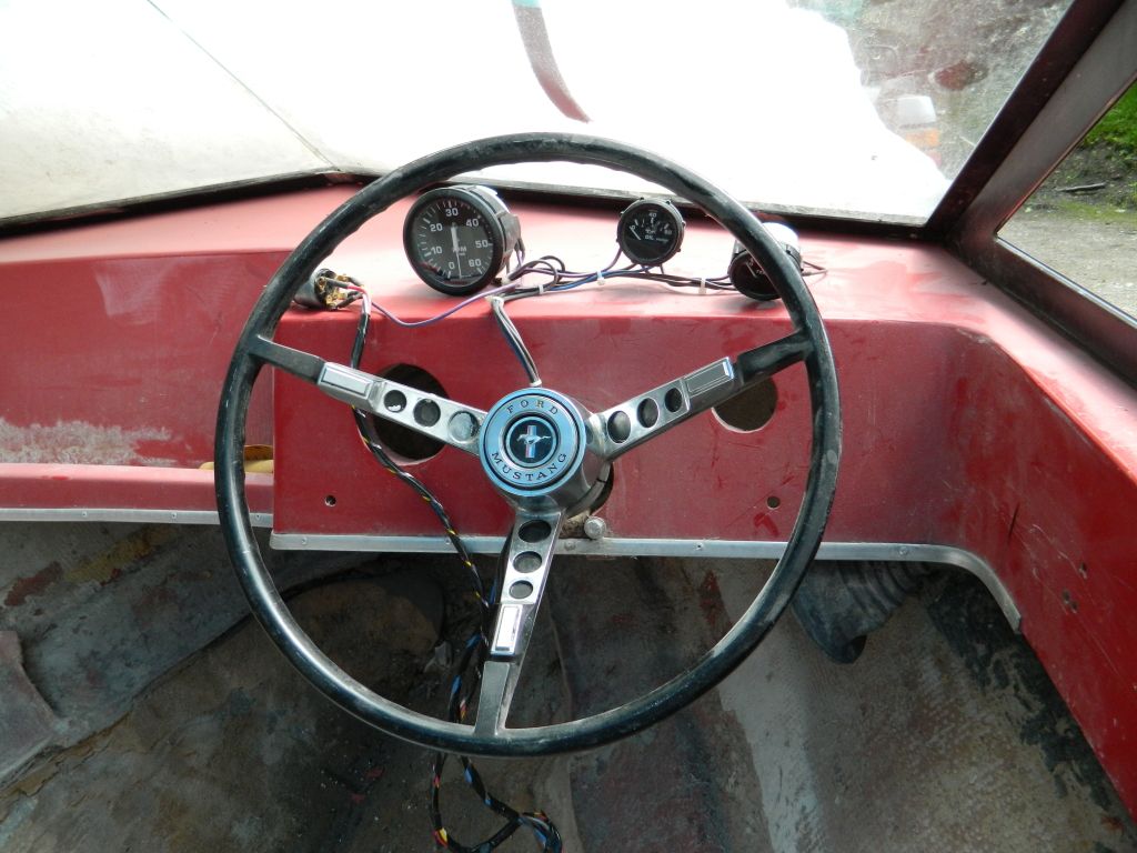

the vintage mustang steering wheel gives the driver's position a bit of class

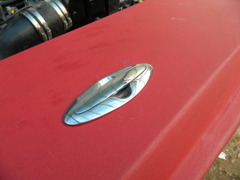

and all the hardware is new,stainless steel items,including these cool pop-up cleats.should look pretty sharp by the time it's all shined up.
