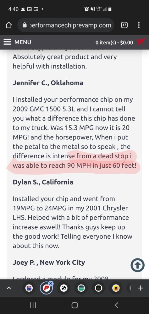

Please don't buy a chip from those shysters.
Please don't buy a chip from anyone. They're all snake oil.
FFS... the linked website doesn't even care enough to make its fake testimonials even slightly realistic
It is even less realistic that some poor sap would put a chip in a 2001 Chrysler LHS...
Gotta love those testimonials. "I put a Superduperchip in my Ranger and now I have 400 rear-wheel hp and 80 mpg! OMG! It really works!" :LOL:
